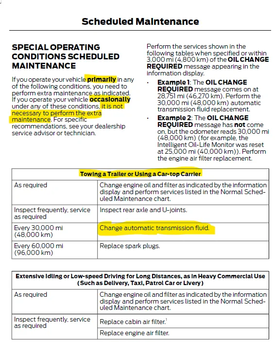

The picture from the service manual is not out of context. Below are the "special operating conditions" which define when the trans fluid should be changed every 30K. As you can see below, the simple act of driving 40,000+ miles a year is not enough, by itself, to suggest the trans should have been serviced prior to 150K.
COULD he have been towing a trailer or using a car top carrier for most ("primarily") of those 130,000 miles? Maybe, but we don't know that. IF he was towing or using a car top carrier "primarily", did he change the trans fluid every 30K? Probably not, but we don't know that either because he didn't answer that question. Even if he was towing or using a car top carrier "primarily" and if he didn't change the fluid every 30K (which, IF true, I would definitely agree with you that it is shady to blame Ford!!!!), we still don't know that changing the fluid would have prevented the problem because we don't know what the problem is. It could have simply been a bad trans with an outside-the-bell-curve component that slipped through quality control built on a Monday. He could have changed the fluid once a month and STILL had the issue. We don't know and will likely never know.

Thats quite the difference in recommended service miles for a trailer or car top carrier.
Heck you could throw in over sized tires and a lift kit or anything else that you notice causes you to burn more fuel to speed up how often transmission service is required. Good to know.
