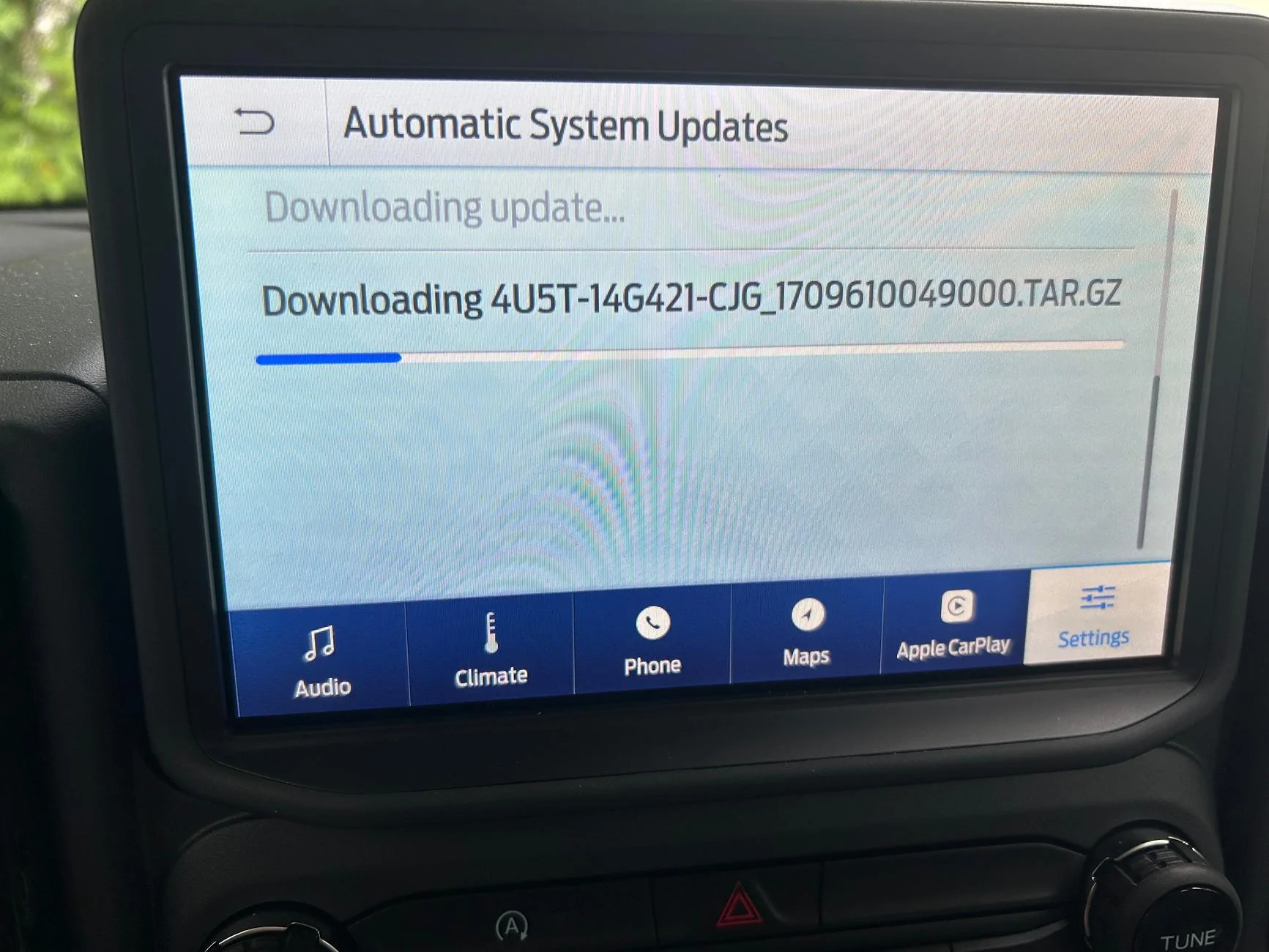

I checked mine today and it already had the 2.23 map update. So I decided to check for automatic system updates and found a rather large one. You have to turn Wi-Fi on and park close to home or nearby hot spot. The update required about 45 minutes to download and install and you have to leave the car running while it updates. Anyone know what it does?

As far as I know, Ford does not publish any info on what specifically its SYNC updates are for. My assumption is minor number increments (everything behind the second decimal place) are for bug fixes. Updates that increment the first decimal point add or change system features. For example, the current build is 3.4.23188. If there's another update beyond build 23188 will be for bug fixes. Going from 3.3 to 3.4 involved changes to the interface--I believe it changed some of the icons. Either way, Ford doesn't publish a change log.

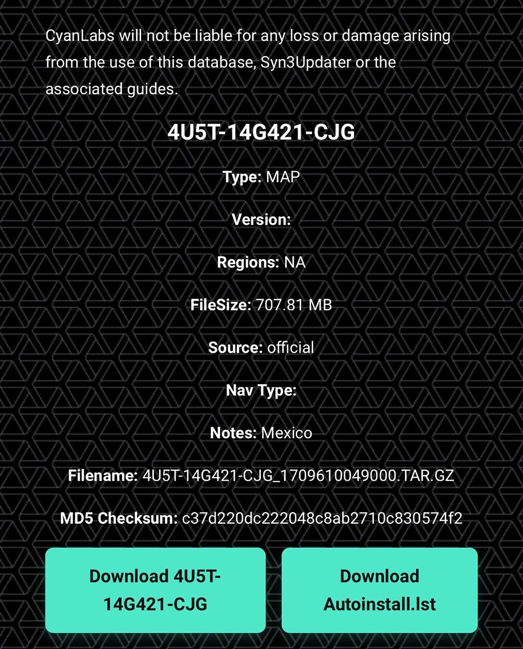

Don’t know what that file does but Cyanlabs states it’s a Map NA (North America) update however you already had 2 23 (installed (possibly all the map files didn’t load whenever you did the Map NA 2 23) update)
https://cyanlabs.net/fhub/sync3/sw-db/
Maybe @thomasm23 will know

This is a map file that was included in NA 2 23.
North America maps include US, Canada and Mexico. NA 2 23 was released earlier than past years. Perhaps this is an update to the maps for Mexico.
