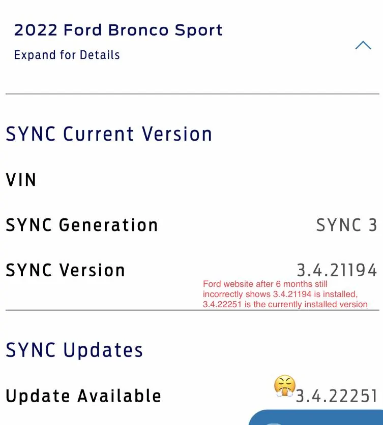

T-3 days to the latest Sync3 map update (available on or near August 14th, 2023) and there’s still no Sync update available to fix the 3.4.22251 issues. Times a-ticking Ford.
Ford Bronco Sport Sync 3.4 Build 22251 Default Issue IMG_7835

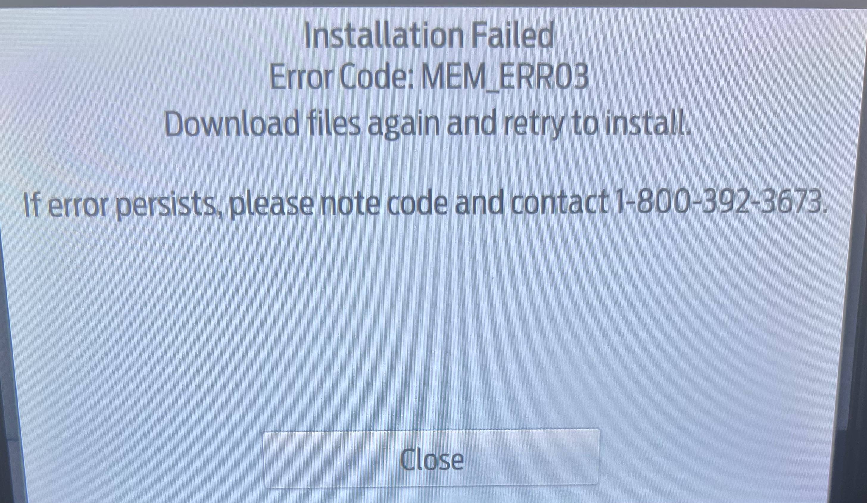

Has anyone successfully installed the current Navigation Map update that became available today 8/14/2023 on the Ford website?
I installed the Navigation Map update on a known good 32GB USB Device that I formatted (exFAT) today. This is the same USB Device Ford sent me for the prior Navigation update.
I started the vehicle then inserted the USB Device into the USB-A port below the 8” Display.. immediately I got MEM_ERR0R displayed.
For that error, I will need to do the Master Reset then insert the USB Device and try the install again. (Seems likely the rwdata partition full issue with Sync 3.4.22251 may be interfering with the Navigation Map update)
https://syncnavigation.com/ford/home
