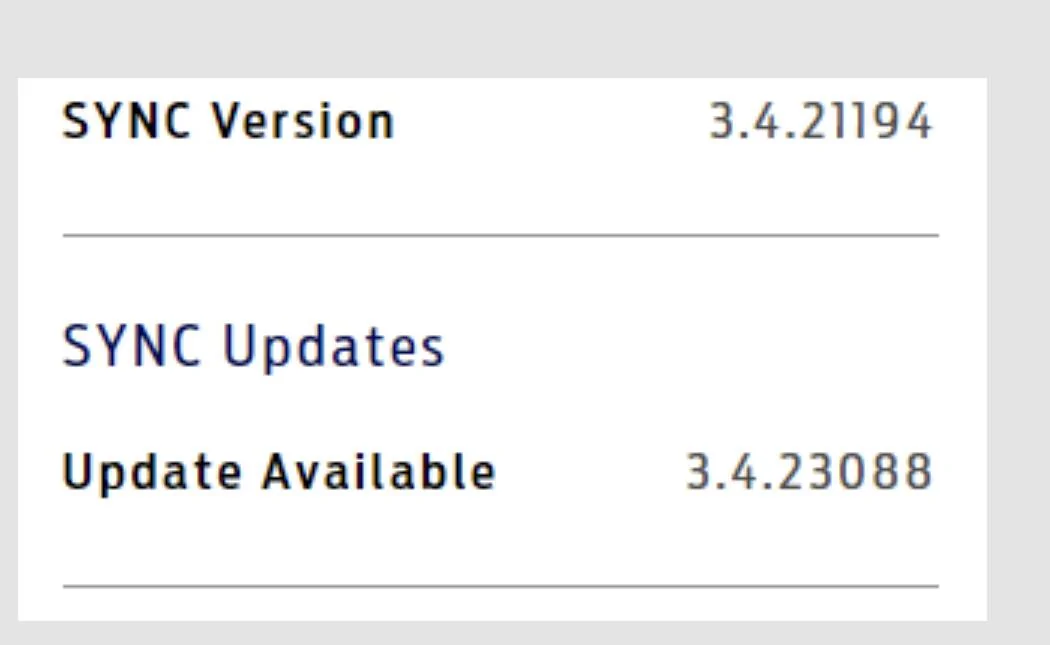

Found the following:
https://www.explorerforum.com/forums/threads/new-sync-version-3-4-23088.502652/
Someone took a screen shot of below. Not my vehicle.
Ford Bronco Sport Sync 3.4 Build 22251 Default Issue IMG_3709
EDIT 2023-MAY-07
Continue reading this post and follow-on posts. There maybe an issue with SYNC Version 3.4 Build 23088 (or other updates) that may corrupt the Sync software installed on the APIM (Accessory Protocol Interface Module)
TSB 22-2254 SYNC 3 - Various SYNC Symptoms, SYNC Screen Flicker, Echo/Robotic Voice Concerns, Temperature Not Displayed In Pop Up Screen
https://community.cyanlabs.net/uploads/short-url/xzlS3pmnyk4POB8ROhWjOu1fqOk.pdf
Recommend using the 8ā€ Display under Settings to disable automatic software updates. Instead manually install your own updates over USB ā€œawhileā€ after a Sync 3.4 update comes out after checking to be sure there arenā€™t issues with the update.
FYI, this cyanlabs post claims 23088 is same as 22251
https://community.cyanlabs.net/t/new-sync-3-version-3-4-23088-still-3-4-22251-actually/8954
