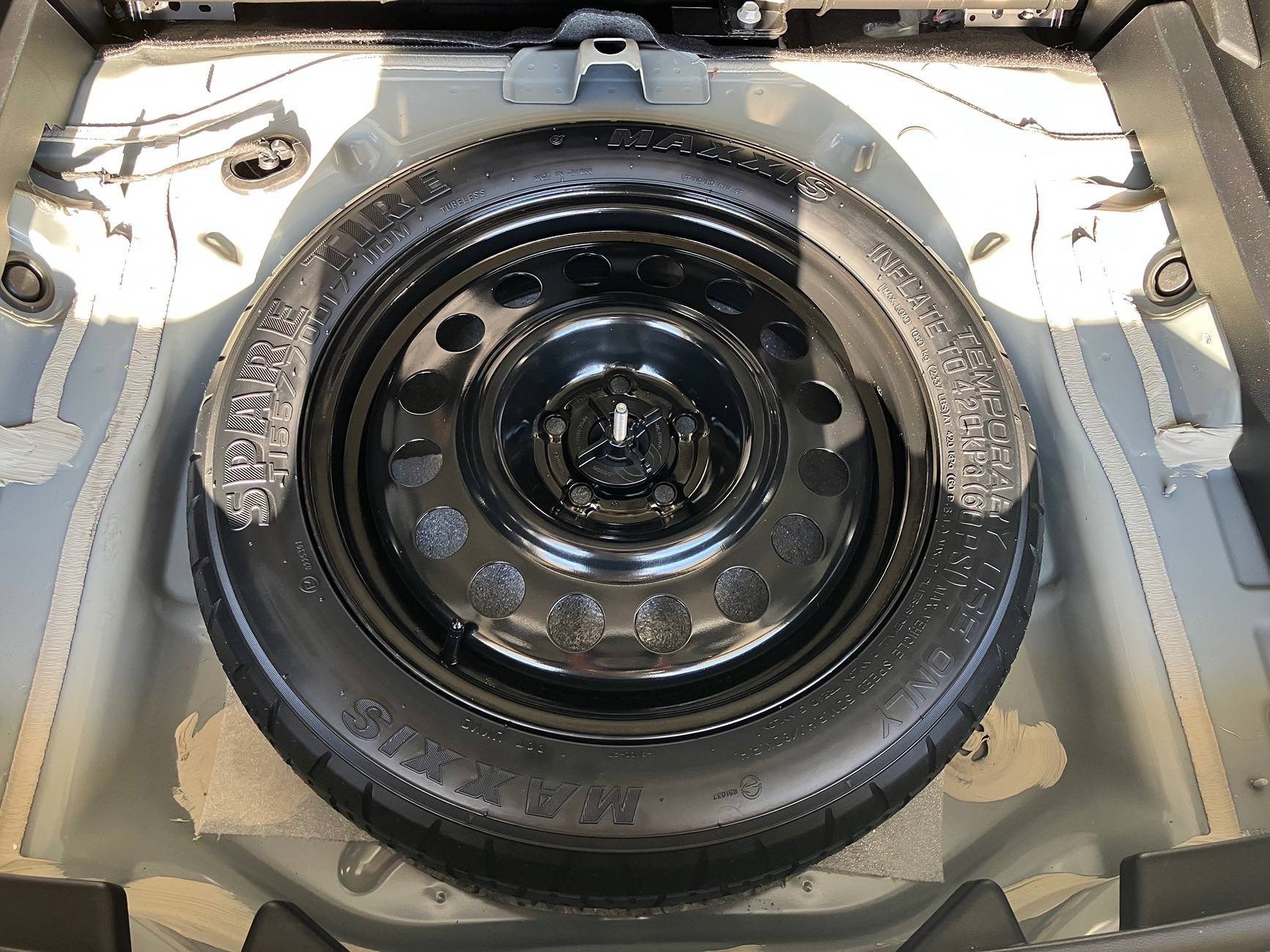

I have been through this with my Mustang and the Bronco Sport. I bought a mini spare, jack kit, and hold down on eBay for a reasonable price and it all fit great. Allow me a little time and I'll gather the details for your shopping list.

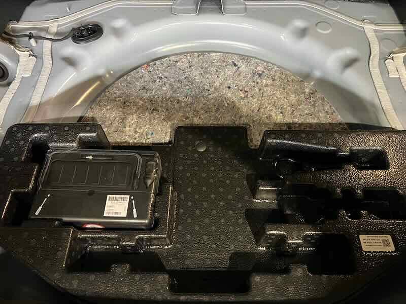

Thanks for the info! How did you remove the foam and hold-down bolt for the tire inflation kit?
Ford Bronco Sport Spare tire / jack IMG_2024

The foam and insulation just pull out. I turned the spare upside down to utilize the space for storage. I have to pull the spare to check the tire pressure, but I carry a compressor when I'm out in the woods, so I'm not worried about a low pressure spare.
I got a shorter bolt with a big washer to hold the spare in place. I shortened my Hi-Lift jack and took the base off, to make it fit. With a Lift Mate, you're lifting the wheel, so don't need as much height on the jack.

The black nylon rivet/bolt in the middle of the pic, pry it up or cut the head off. Or you could just grab the whole thing and rip it out. The rivet goes where the hold down bolt goes, so try not to damage that metal standoff. Leave the felt mat.

Thanks! You're right, the foam and bolt pull right out.

Thanks! I pulled the foam up and out, and then was able to remove the bolt easily.
