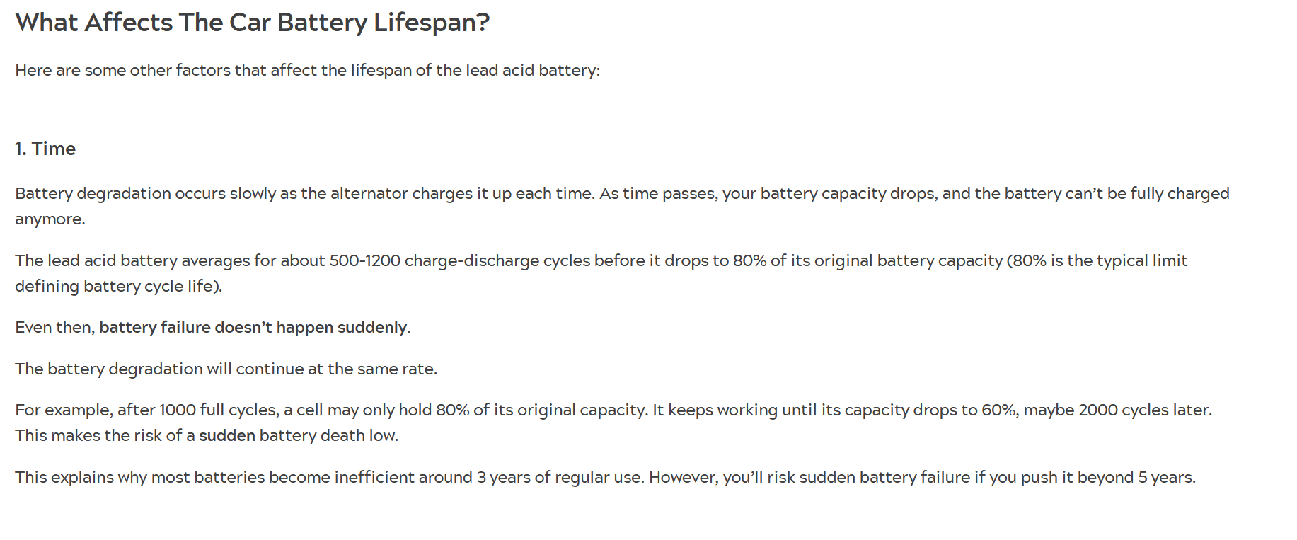

https://www.repairsmith.com/blog/how-long-does-a-car-battery-last/#howdo
auto/ stop-start feature
might not be enough for the full cycle charge to be an issue
but there may possibly be an effect on the number of cycles
made it a habit to select "off" mode

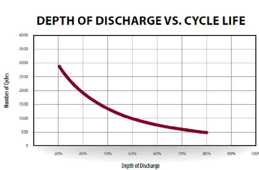

just what constitutes a cycle?
percentage of amps out amps in?
A cycle is any discharge followed by a charge -- usually/ideally beginning and ending at a full charge (100% SOC).
How many cycles a battery can provide is dependent (in part) upon the depth of discharge:
https://discoverbattery.com/component/content/article/111-does-depth-of-discharge-affect-cycle-life
Ford Bronco Sport Seems to be a lot of battery issues on BS models 1699663779840
I spent too much time trying to find a chart. This one isn't exactly what I had in mind but it gives the general idea -- the greater the DOD the shorter the service life. From 2,000 down to 200, or 10:1 for the GEL.
I could not seem to find a chart for an actual automotive starting battery (let alone Motorcraft) but the concept is the same. It's best no to discharge starting batteries too deeply -- which, unfortunately, the BS can do if it sits for very long after it is turned off.
BTW -- at "Battery University" there was mention of a study of the auto start/stop systems. I can't find it now, but it said that battery capacity can be reduced significantly by many start/stop cycles, but CCA remains about the same.
Here's another chart that indicates the affect of deep discharges on service life.
Ford Bronco Sport Seems to be a lot of battery issues on BS models 1699661611305
