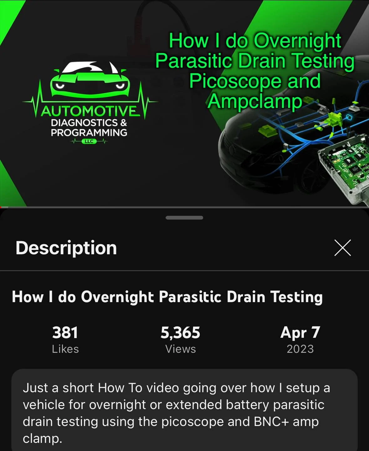

For various reasons I disabled automatic software updates. I know from talking to a Ford Tech, the Bronco Sport can download software to other modules besides the APIM (Sync software) and I don’t know if disabling automatic software updates is a setting only applicable to Sync software or applies to any software update. I also don’t know if my Bronco Sport ever downloaded software other than Sync because I haven’t found a way to see log files or to know what downloads did occur.
Given that, I’ve been wanting to measure the average parasitic current draw over a period of time (in the video, the Tech calls it parasitic drain).
I suspect average current draw for Bronco Sports varies quite a bit for different vehicles but I think might be well over 50mA for some Bronco Sports. This may explain why Bronco Sports with an AGM Battery or the EFB fail to maintain a charge over a period of time when the vehicle is not driven sufficiently.
And given the discussion above that Fords BMS may not be all that robust, this adds to the knowledge that BMS might well be the root cause.
I don’t have the equipment to measure and record draw over a period of time. Perhaps there are F150 owners or Bronco Sport owners that do have the equipment and are interested in doing a science project as outlined in this video.
