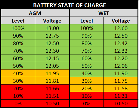

The key is to keep them at 100% SOC -- about 12.7 volts. A few tenths of a volt may not seem like much -- but it is:
Ford Bronco Sport Seems to be a lot of battery issues on BS models 1697833966033
12.4V is just 75% SOC.
I have to admit, I didn't realize there was such a difference between AGM and flooded. I've been using ~12.65 to 12.7V as 100% SOC, but for AGM it's ~13.0V.

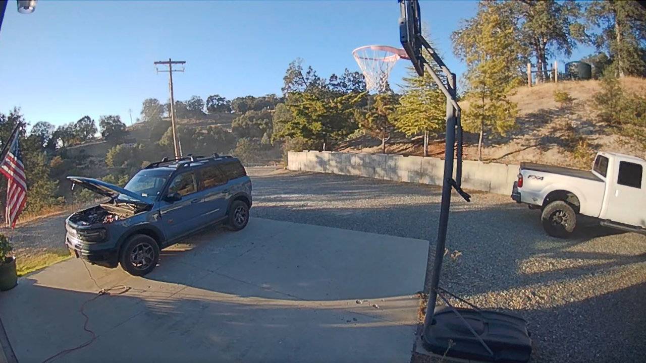

Ford Bronco Sport Seems to be a lot of battery issues on BS models Image1
2021 Badlands daily driver suffered battery loss at 39,332. Add another two batteries for the truck last month and that's nearly $700 in batteries in the past month. Then we have to pay the Californian registration extortion next month of $592 for the Bronco and then a whopping $846 the next for the 10 year old diesel (thanks Newscum). I love living in California but damn the taxes and fees are really getting ridiculous.
