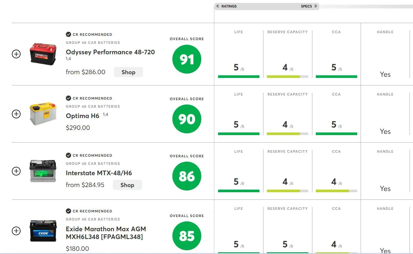

I agree -- '382 bucks for a battery ?!?!?!' Sumthin' ain't right there. I thought they were about $200. Here's a Motorcraft AGM for <$236 delivered.:
https://www.fordpartsgiant.com/parts/ford-battery_bhef-48h6.html
That Exide AGM with a 4 year warranty for $180 is looking like a deal (see post #15).
On the 3 year life of the Motorcraft battery, there are posts here and elsewhere that indicate that's what many/most users get out of them. If they cost (say) $100 that might be OK, but not at what they go for.

Battery, 3y life span is average for modern vehicles across the board - these things are online pretty much all the time.
Mine is a 2023, but I am planning to swap out the battery next year, towards Fall/winter.
If that's the case, the Exide AGM (above) with a 4 year warranty will allow buyers to get 2 for the price of 1.
