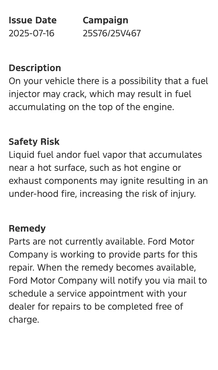

The recall notice on FordPass now says there is a remedy but parts are not available right now. Does anyone know what the remedy is? Are they actually going to replace the injectors?

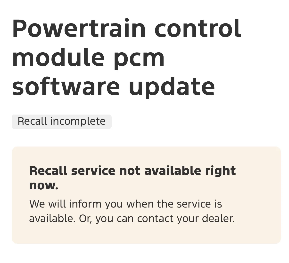

Powertrain control module pcm
software update
“Parts are not currently available”
I guess that means “Ford engineer brain cells not currently available “

This recall has now been renamed.
Powertrain control module pcm software update
This seems to hint at what the immediate fix will be.
The dealer notification letter confirms that the immediate fix is just a software update to the PCM...
FoMoCo said:
This safety recall supersedes the prior recalls and will include a remedy for this issue, which is currently under development. The recall will include a software update, which will help detect cracked injectors and mitigate fire risk.

Last but not least, I would note that Ford says "A remedy for this issue is currently under development. Ford is currently evaluating options in developing a new remedy and expects to finalize this in the near future. We hope to share more information soon." and:
FoMoCo said:
Following two earlier recalls to address the risk of underhood fire due to fuel leaks from cracked fuel injectors in Escape and Bronco Sport with 1.5-liter gasoline turbocharged direct injection four-cylinder engines, an ongoing investigation into the root cause of the issue has determined the need for a new remedy that’s under development to prevent future risk of cracked fuel injectors.
So Ford is essentially saying they have something in mind for a final remedy, but they don't specifically call it replacement of the fuel injectors. It could be fuel injectors themselves, it could be other related parts, could be both... only time will tell.
