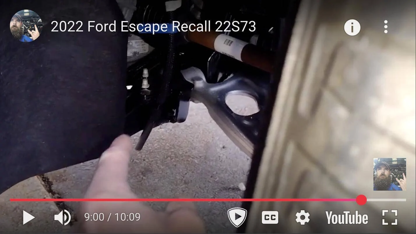

Coopny, does fuel from the drain tube exit above or to the side of the felt cardboard underbody protector? If it drips onto the felt it will likely be absorbed and not show any drips on the ground, unless it’s gushing out of a cracked injector. A person should be able to smell the fuel though, which will advise you not to drive your vehicle and get it in for inspection.
Based on the video @Mark S. posted here for the Escape in 2023 in the last minute or so, the drain tube is not behind/obstructed by the felt and goes straight to the air/ground:
Ford Bronco Sport [RECALL] 25V46 (NHTSA) / 25S76 (Ford) - Fuel Injectors MY21-24 1.5L I3 Engine 1752845397756-h8
If they allowed the tube to drain on / behind the felt, it'd be pretty pointless... pooling fuel into an absorbent surface...
