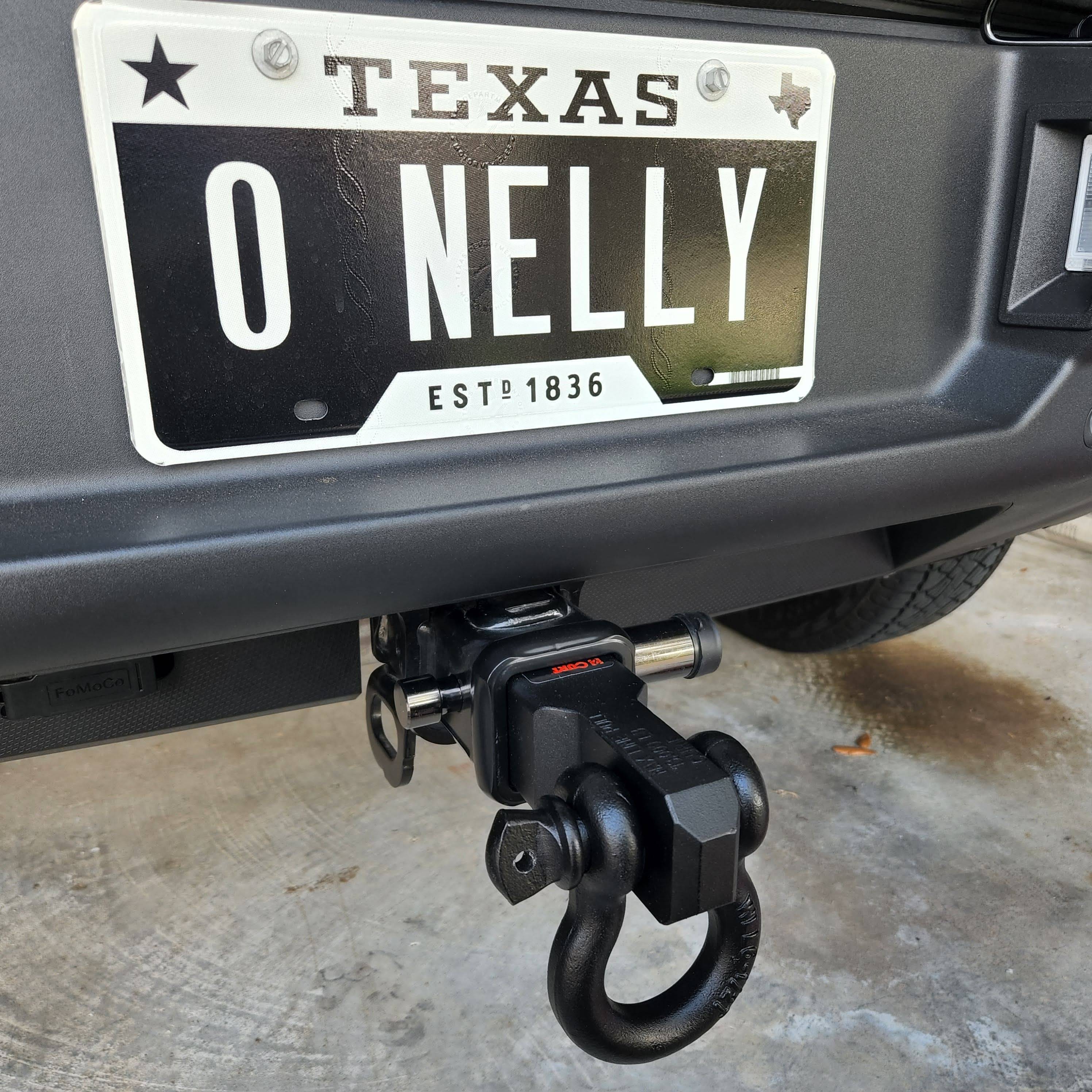

UpDate:
Purchased from Ford with points...10K+
Hitch pin purchased from Northern Tool. The O-ring will keep water from the key mechanism.
Hitch stowed around full size spare. I put it in a shorty sock to stop rattles.

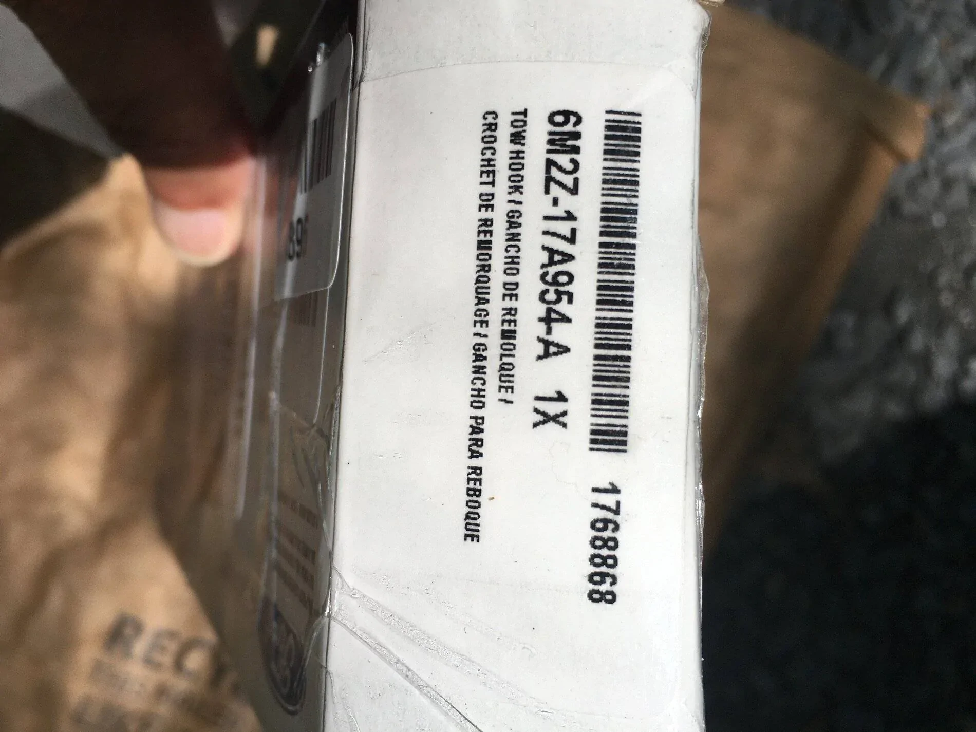

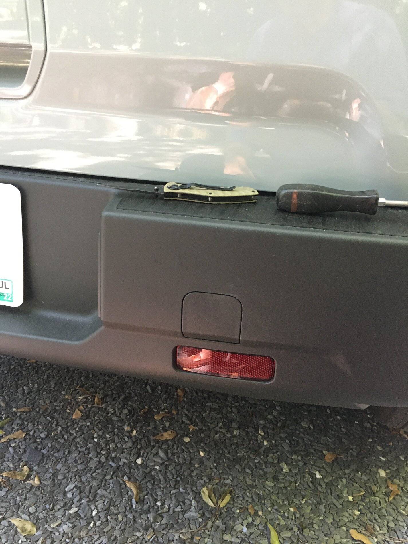

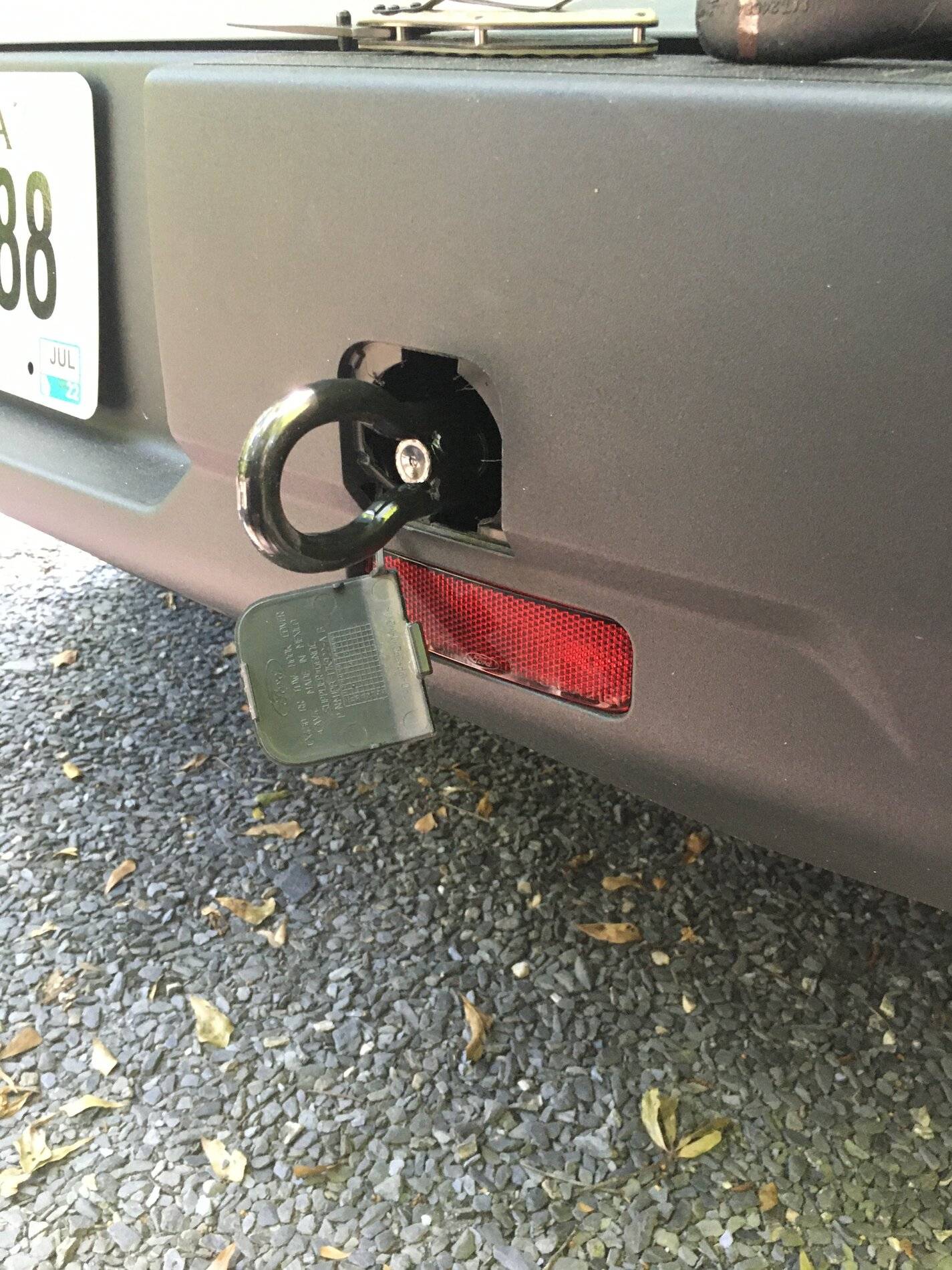

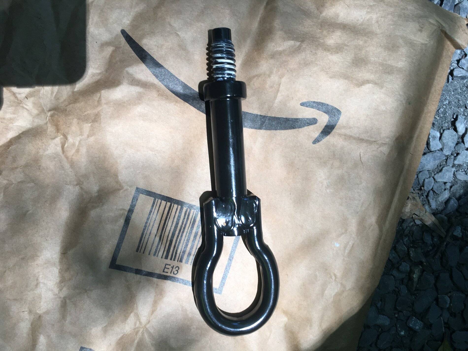

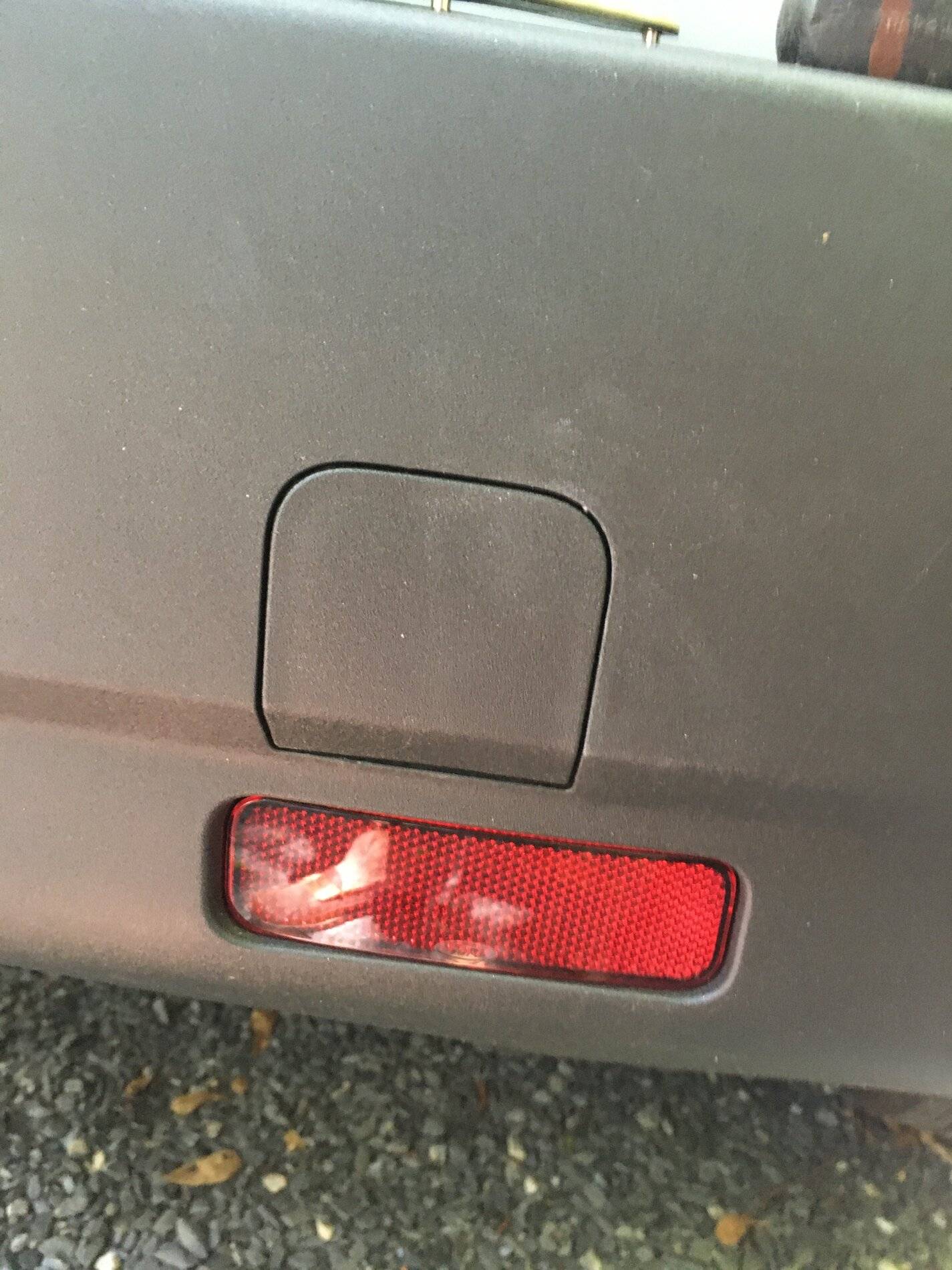

Since there didn’t seem to be any specific part numbers listed for a BS rear tow hook, I took a chance on this one (6M2Z-17A954–A) listed on Amazon. It seemed to fit various years of Escapes and Transits but no mention of Bronco Sports. I learned the other day that Ford doesn’t list parts that fit your vehicle but rather parts that came with your vehicle. I gather no one’s BS came with a rear hook therefore one doesn’t show in the parts list. This will be tucked away for emergency use in the spare tire area along with a strap. Cost around $35 but I bought a “used” one for $26 and free shipping which wasn’t used but the box was damaged. Very good week with hood struts and insulator hood pad added as well.
