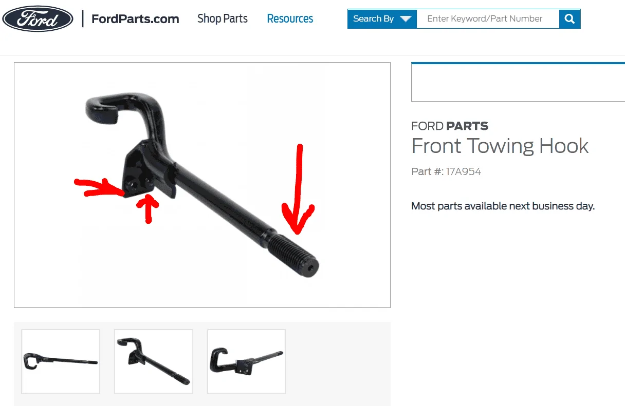

Has anyone determined if the bolt hole(s) exist for the front tow hook?

If it does end up being a "not gonna happen" it's on to plan B
Plan B
Find suitable Bull Bar
Here's what I've noticed though
Of the bars being offered
None of them have a hook accessory at the bar/frame mount location?
Seems like the best combo one could ask for
Strapping the bar could be a leverage weak point
hence a hook right at the frame/bar connection point

The bolt hole is there, but only the BL and 1st ED get the mounting bracket. Without that, the hooks will pull out...
Okay, if I understand this correctly
  • the hole is present for the threaded rod portion of the hook
  • But the mounting plate (bracket) towards the hook end is absent?

Bracket is at the back, and is directly attached to a body rib. I don't belive anyone has fabbed up a replacement piece... yet.
