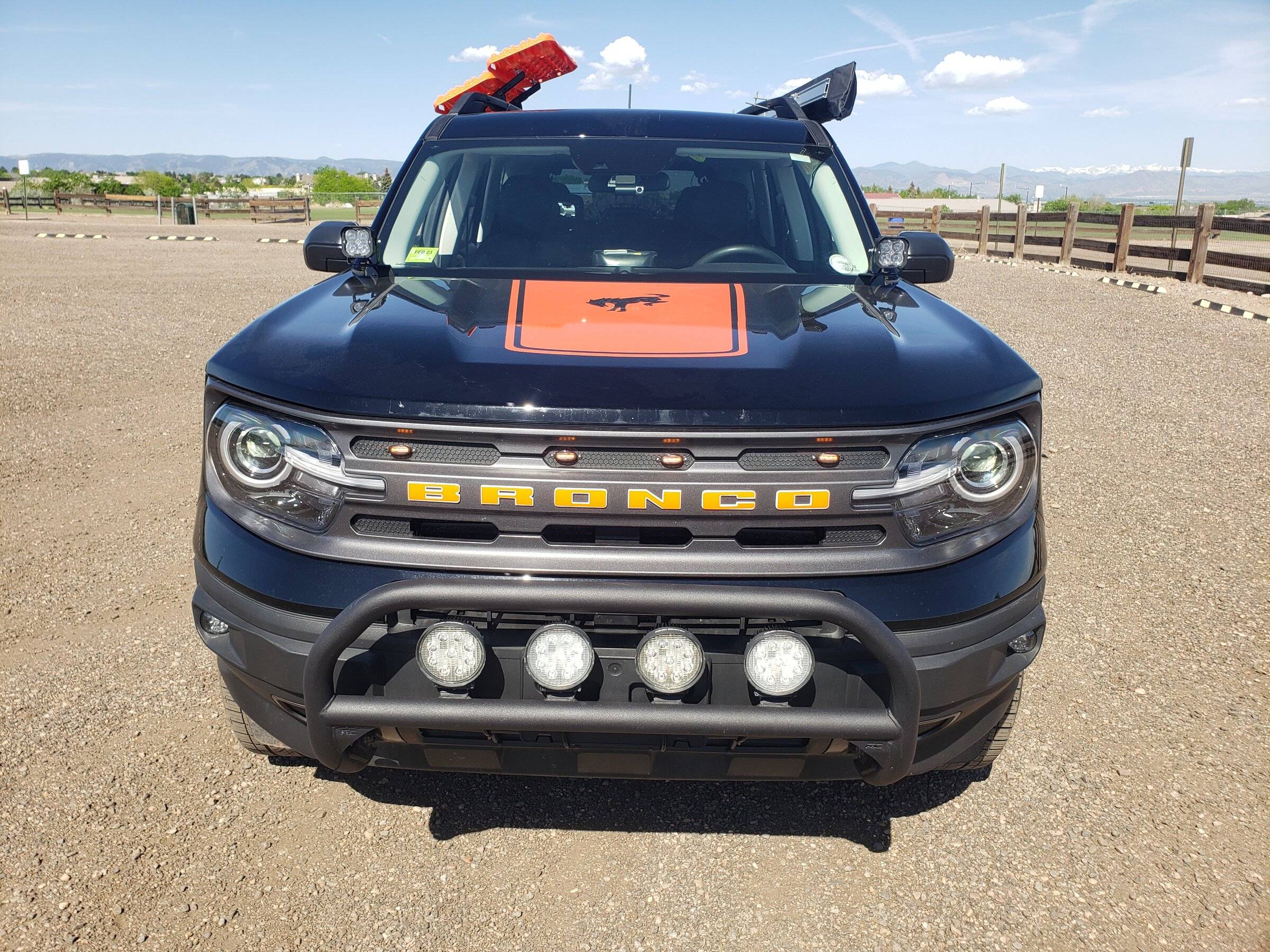

Noted :), I'll most likely install the mesh sometime next week. Looks more slick and flush with the whole setup.
When you finish send pics. Your BS is looking sweet!

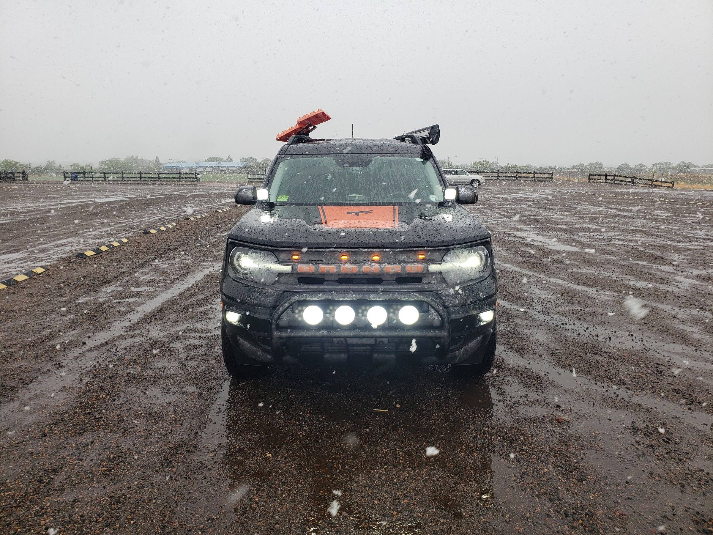

Ford Bronco Sport Raptor grill accent lights 20220520_132001
eather Late April???
#coloradonative
You mean, late May! It was 88 yesterday and the high was this morning at 42 but now 33. In 24 hours it is 55 degrees cooler. At one point last night at my house it dropped 30 degrees in about an hour.

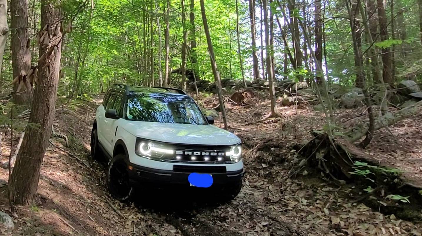

Has anyone with a badlands grill installed raptor/accent lights yet?
OB_Bronco21
Ethan
Mar 11, 2022
I spliced into the driver’s side front parking light and it worked perfectly.
Ford Bronco Sport Raptor grill accent lights ED3EE127-ED87-43B3-9BC6-056E68DE0AE6
How did you get to the parking light? Looks pretty tight
madfella
Apr 5, 2022
54
100
El Paso
I removed the wheel well liner and then removed the black fabric tape that has the wires doubled back. It was a little tight, but there was just enough room. Use the three way wire taps I linked in an earlier post.
