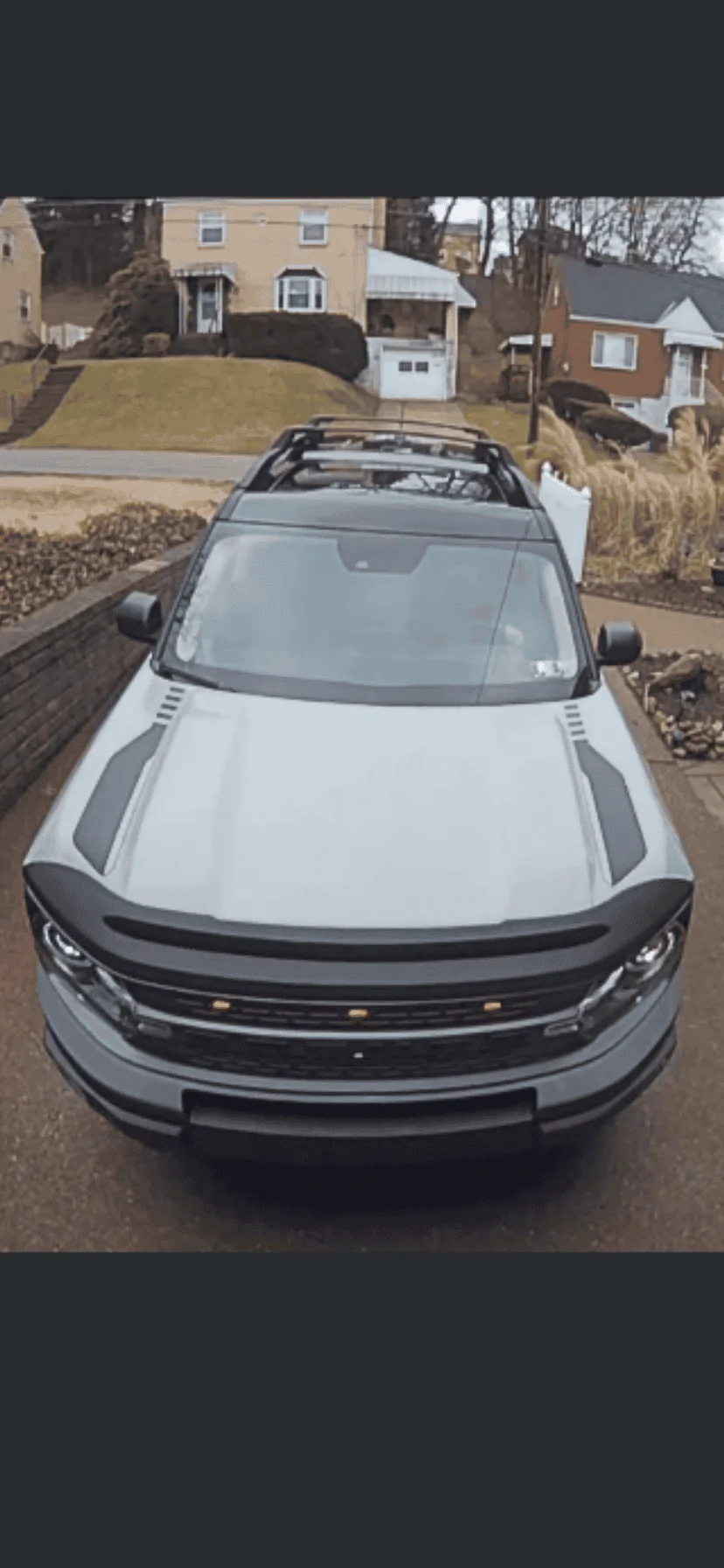

Thanks, red wire to the fuse then black wire to ground ?
Ford Bronco Sport Raptor grill accent lights 23B54F12-40B2-4F3B-868B-E5C160071C88
Yup. I think I grounded them to where the battery grounds to the body.
Snaking the wire under the dash was fun. Lol. There is an opening to go through the center
1,423
1,468
Thanks ; then you broke the hot with a switch , yes or the ground with a switch ? Thanks Josh Done

@GoatsyBanks
Ford Bronco Sport Raptor grill accent lights 2D57BCAE-EF57-4306-922D-5E4E1314EAA0
All hooked up and working. I’m Loving the Raptor trim lights!
This is the first picture I've seen where the nudge bar can be used with lights as to not interview with the 360+ radar. Is that the Rough Country Nudge bar?
Pmk1710
Peter
Jan 11, 2022
116
157
Yep, no interference at all.Yes, this is the RC Nudge Bar.
originally was supposed to receive DRL ready Light Bar/Nudge Bar combo (which would also not interfere with 360+) but the DRL light bar was on back order for 5 weeks. I had just purchased my BS and eager to pack out, so I wasn’t going to wait that long.
I ended up getting the light bar that was not DRL, and will eventually mount that to my roof basket, but I found these 7 inch 3 way lights that were perfect for the nudge bar.
Just required a little mounting bracket adjustments, but they work great

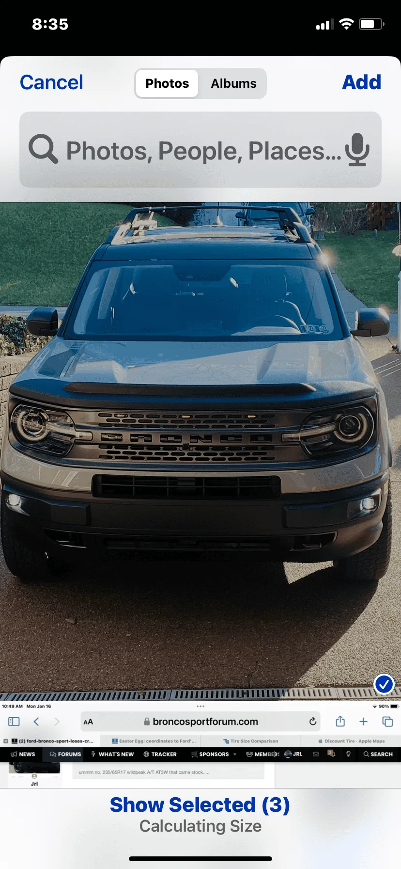

So, I bought some lights, but I have no idea if where I would like to put them is feasible. The picture shows where I would like for them to be. Input anyone?
Ford Bronco Sport Raptor grill accent lights IMG_0132
1,423
1,468

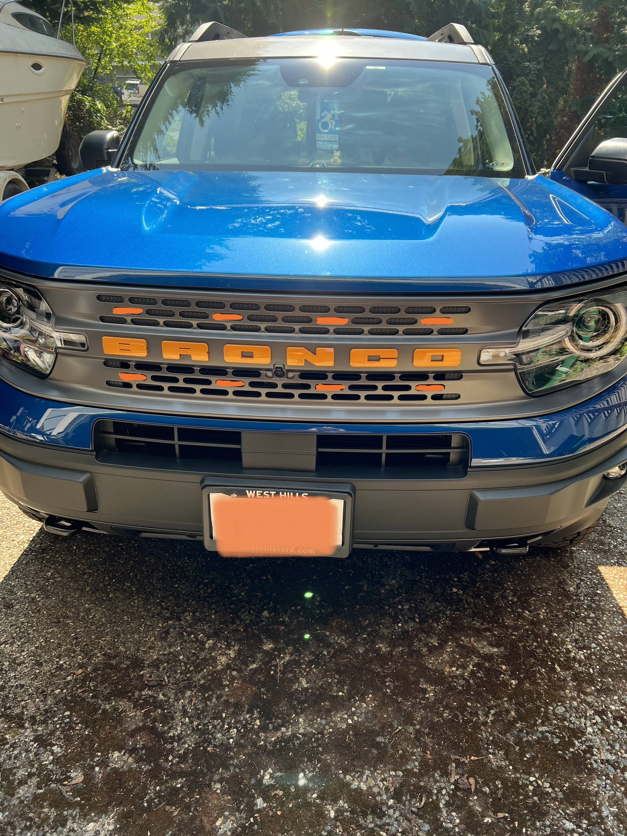

This is what I did .
Ford Bronco Sport Raptor grill accent lights IMG_1107
Ford Bronco Sport Raptor grill accent lights IMG_0833

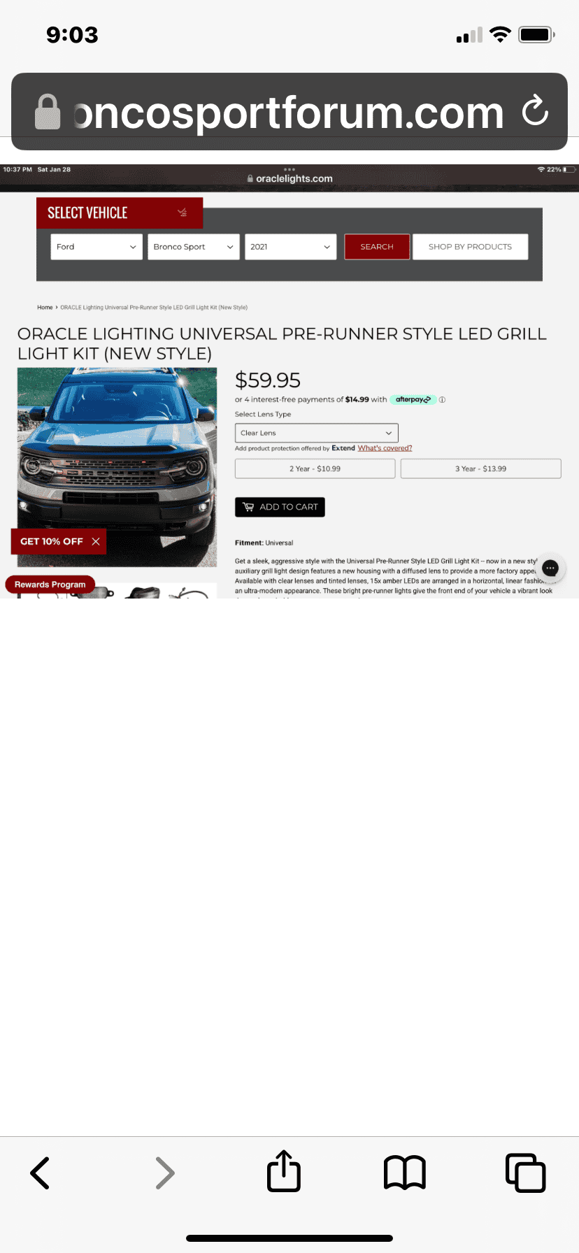

Can you tell me what lights those are or give me a link?
Sure thing .Thant’s actually my car in their add . Good company and the best quality .I bought the tinted ones to match my grill.
