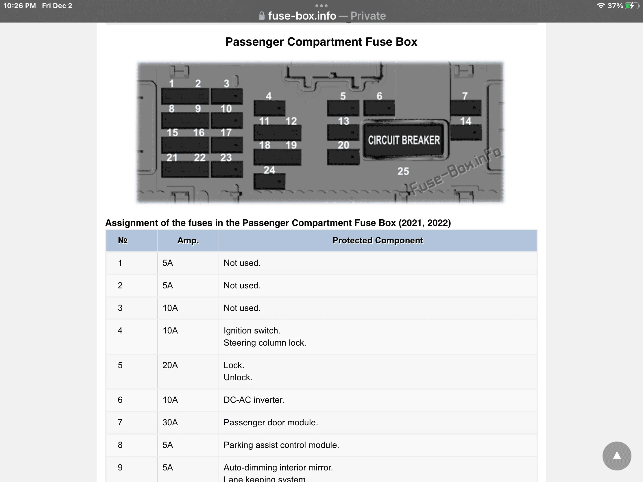

I went into #3 fuse on the inside fuse box , that way when I start up the lights are on at start up,
