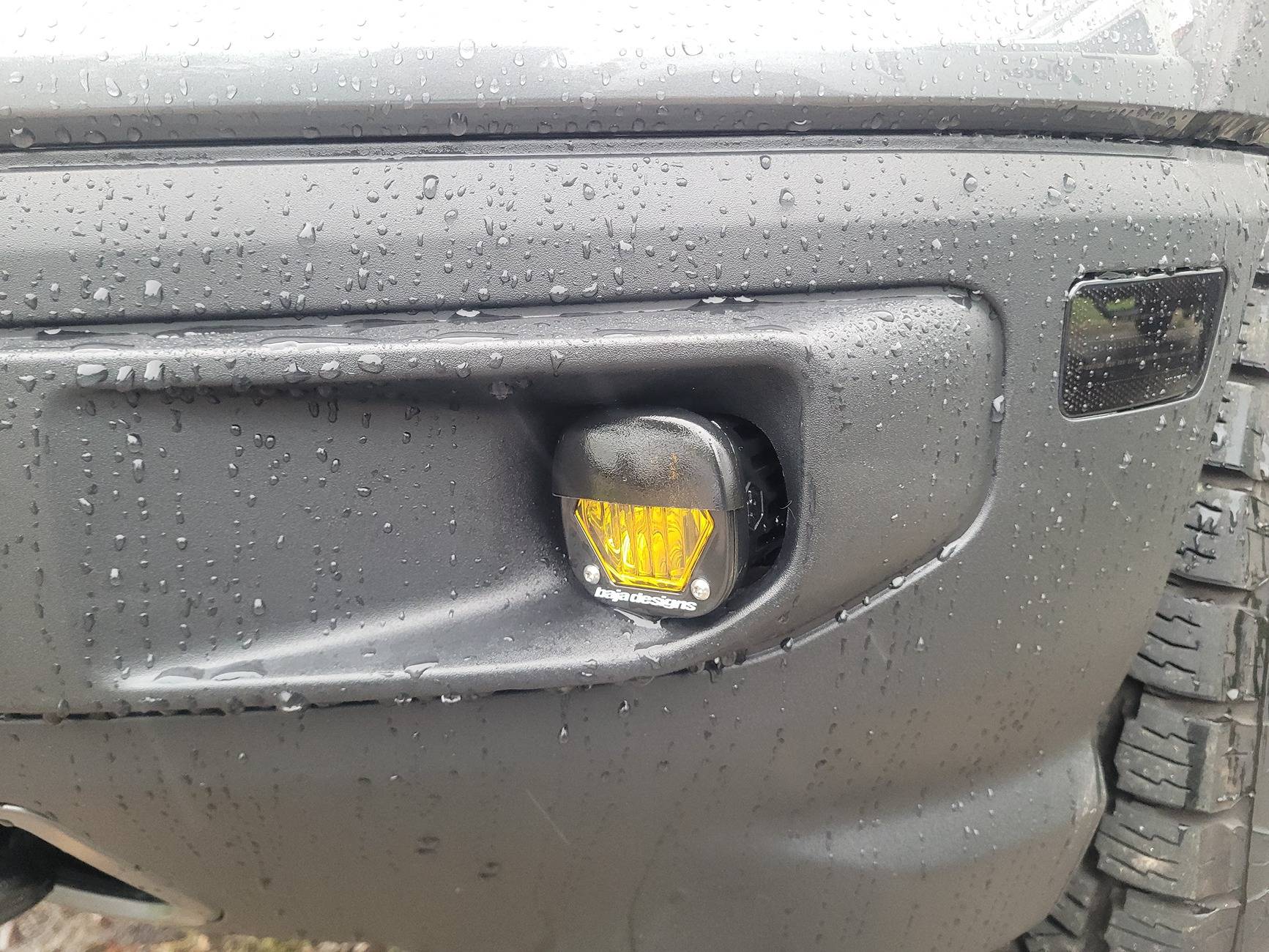

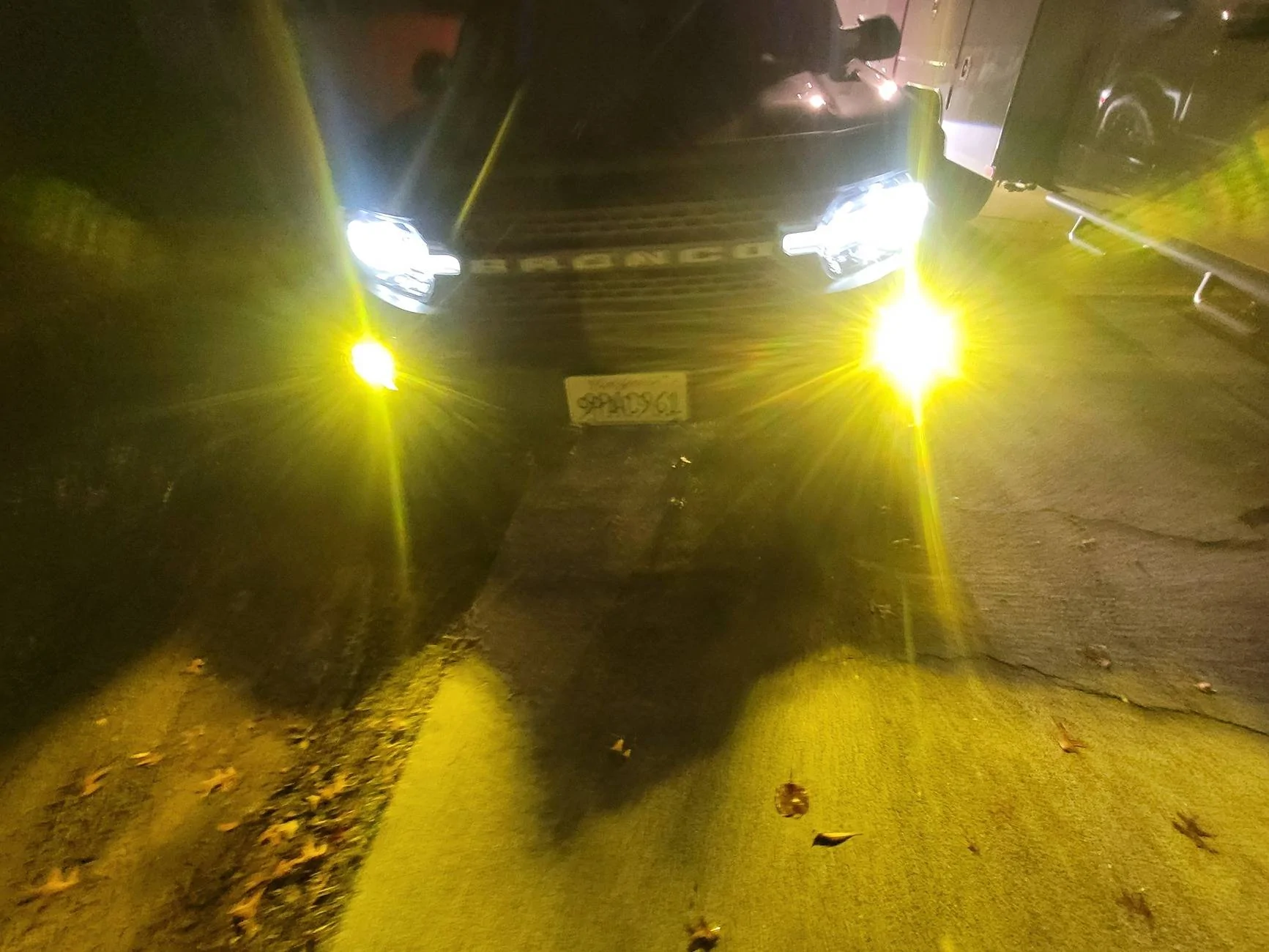

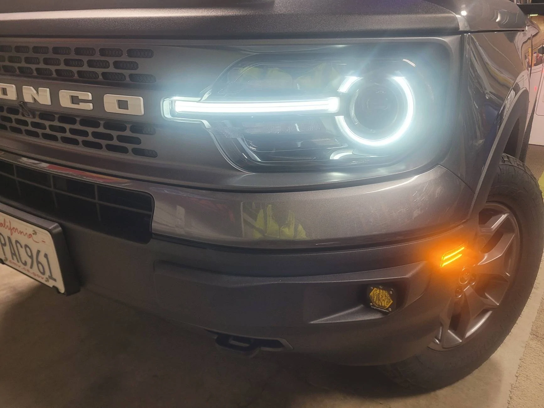

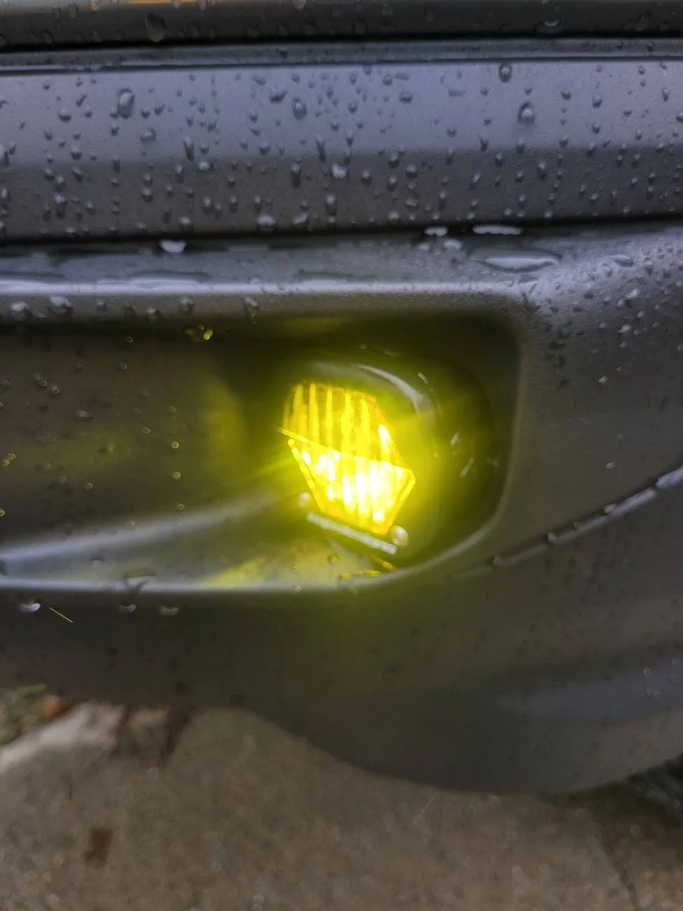

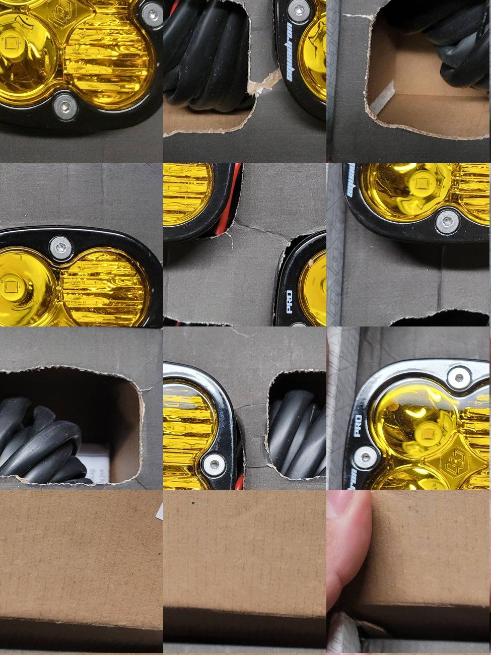

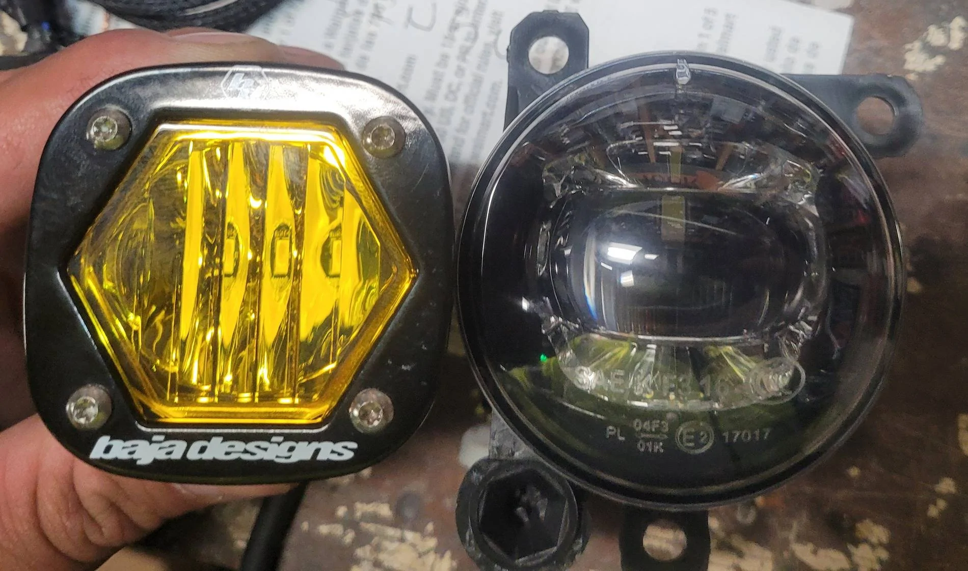

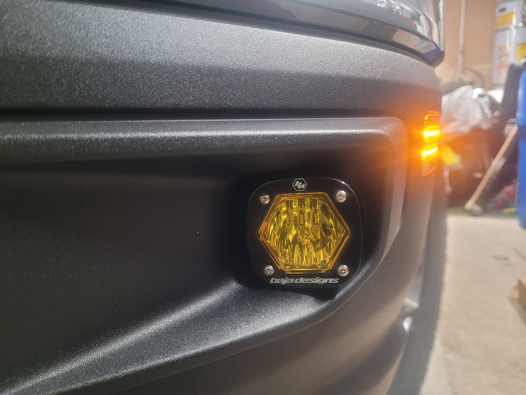

Took less than an hour to install these BAJA DESIGNS S1 fog pocket kit. The one bolt that you have to reach through the tow hook area to remove for the ecu on the drivers side is a pain. Hopefully you have some mechanical skill and can operate blind. It's pretty hard to reach into and I don't have huge hands plus you can't see it while you work on it. Removing the front wheels would make it easier also. But the 245 tires probably made it a bit harder too. Again working blind.

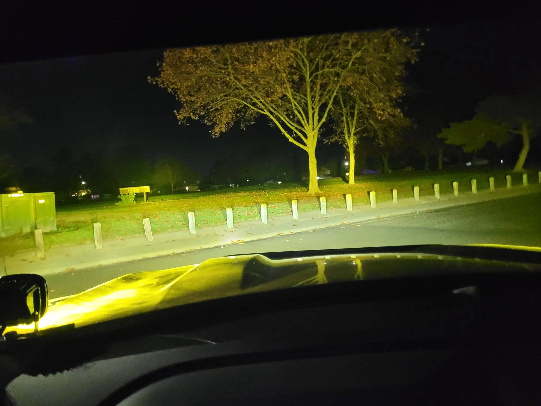

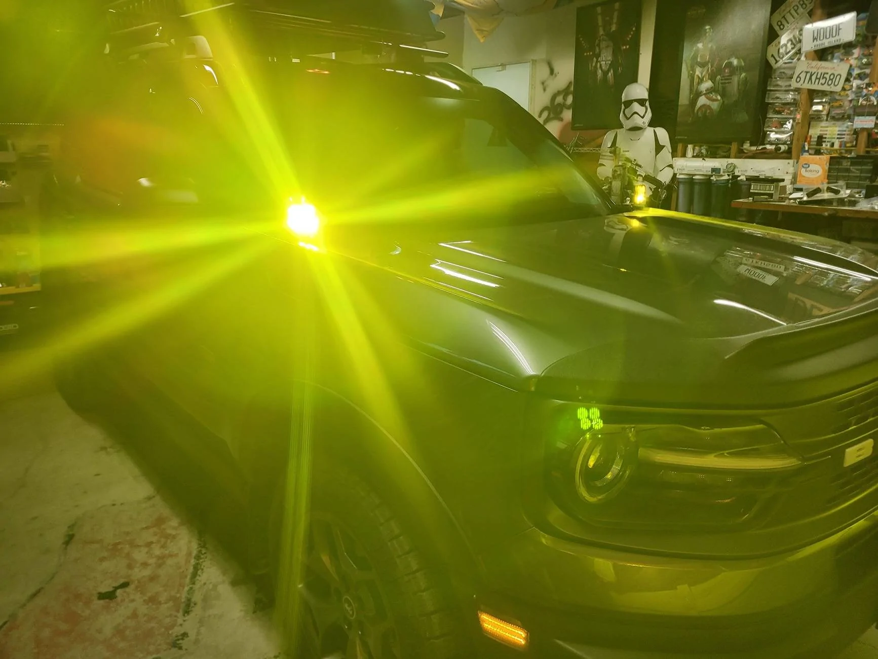

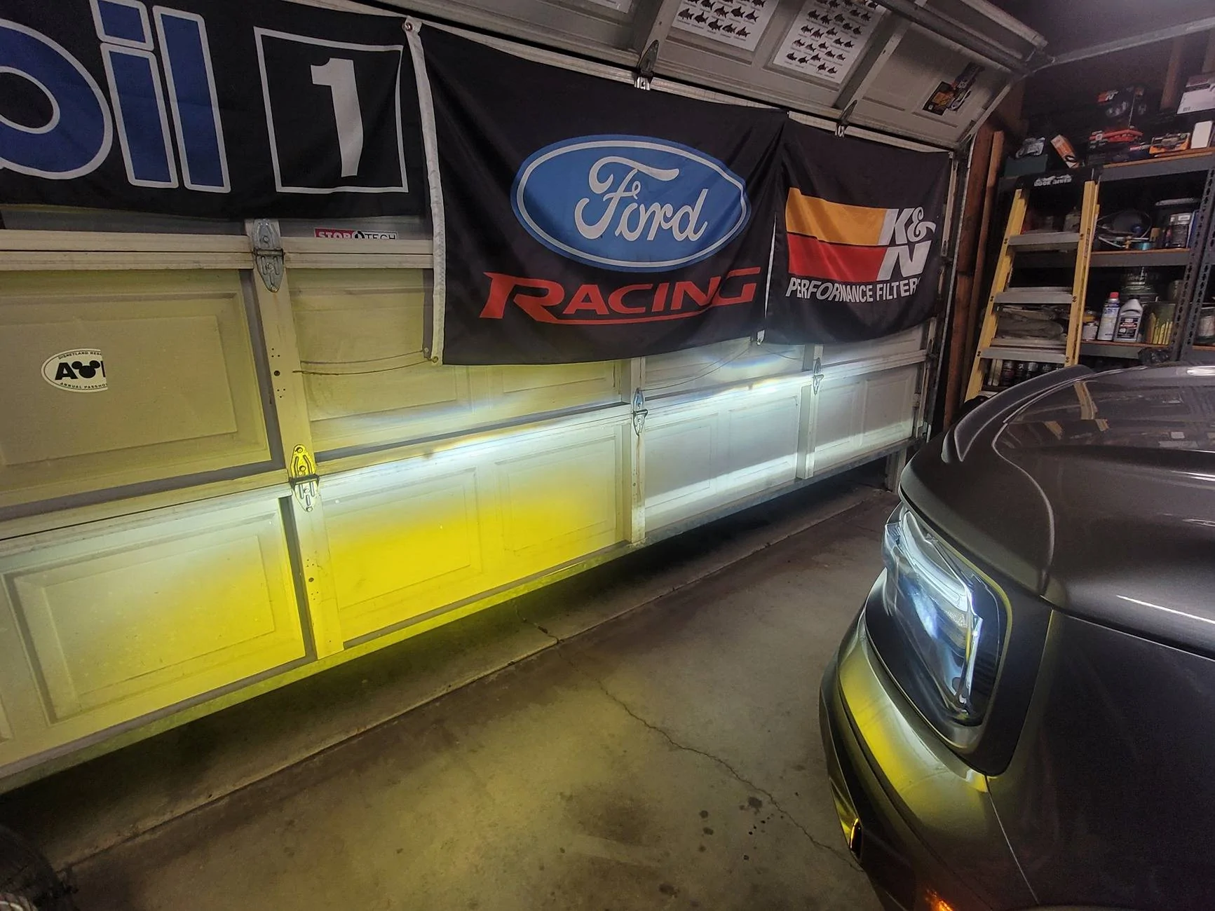

These baja S1 are so damn bright. I ordered the yellow rock guards that go over them and am going to probably hit them with the night shade. So at east they won't be blinding as a daily running light and fog but quickly and easily be removable for offroad use

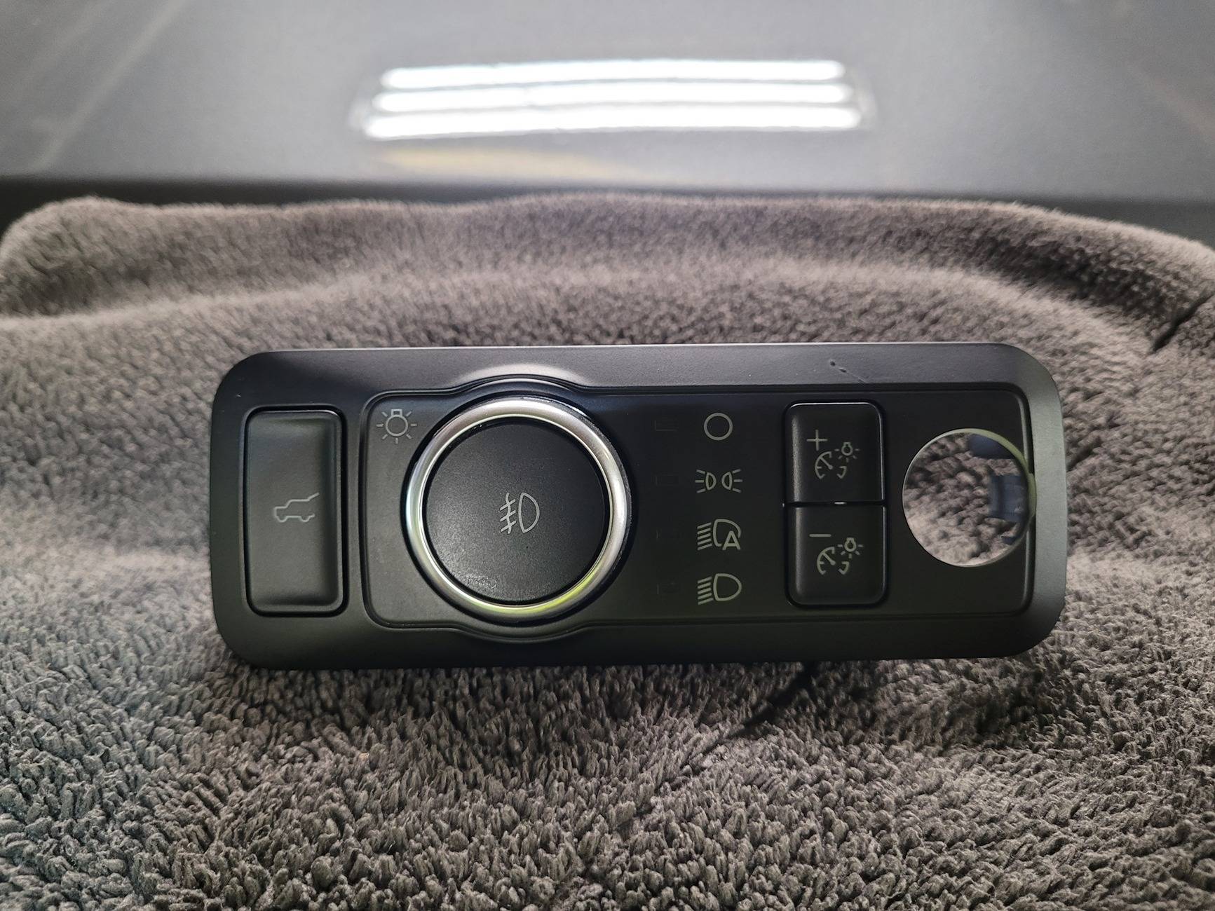

The next question is, TO DRILL OR NOT TO DRILL?

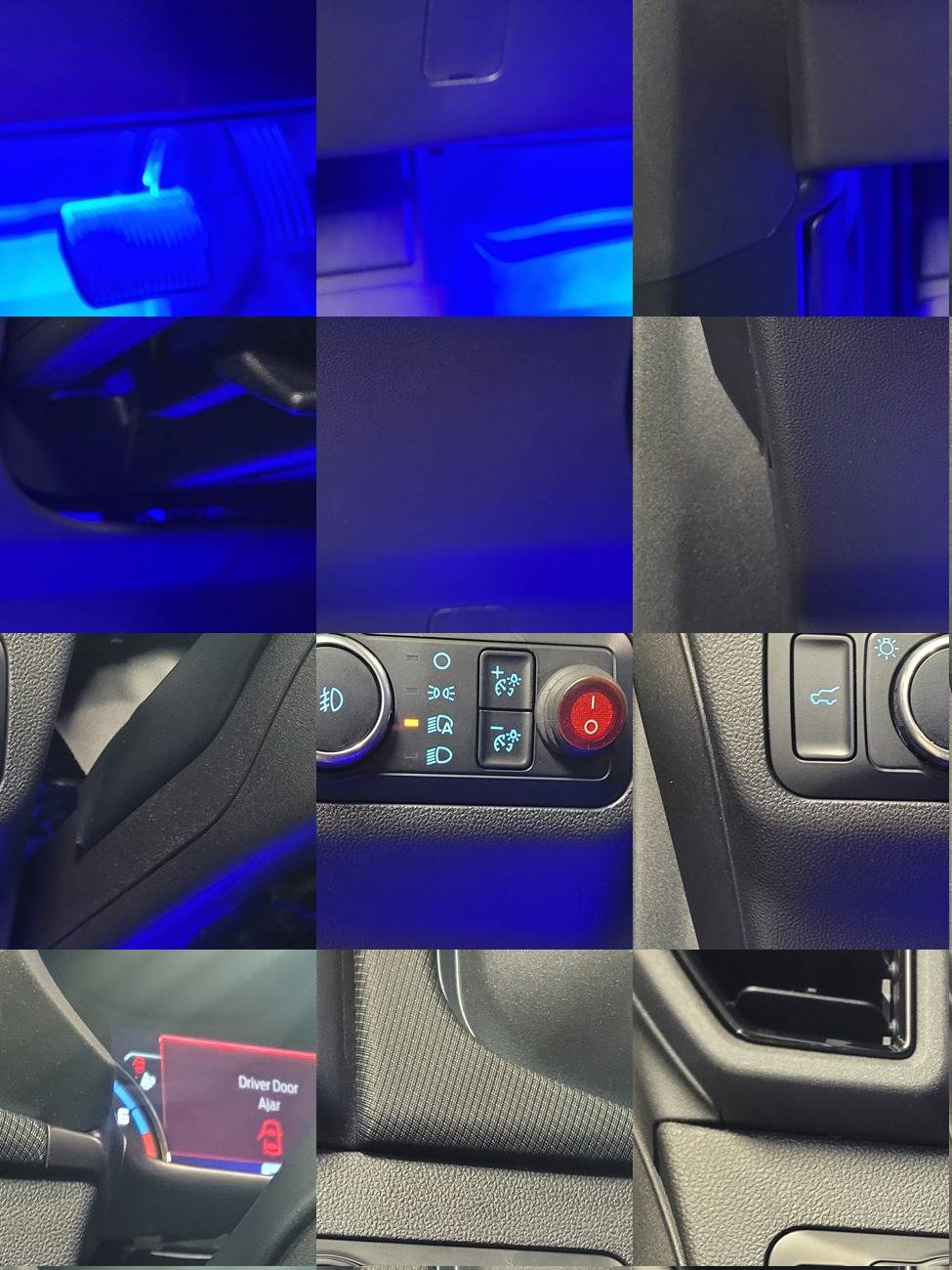

the round switch for the baja designs squadron pro I'll be swapping the current aux beam A pillar ditch lights needs to go somewhere. Ive been coming in with ideas but, I'm really thinking I'll just drill a hole under the factory headlight switch.
Any feedback appreciated

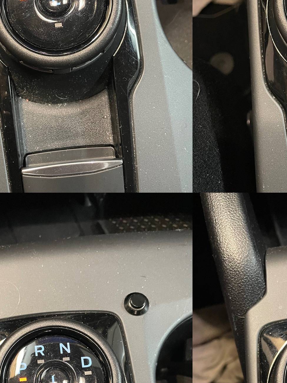

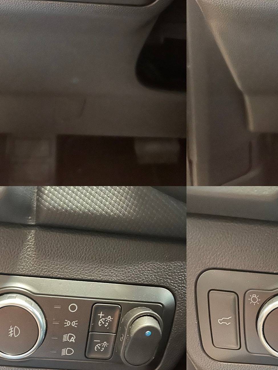

Quahaish, I lifted the light switch plate out with a plastic tool and drilled on the right end for a big clumsy offroad light switch. I could have used a small one amp button instead to the relay. and I drilled by lifting the top of the console for a small button switch for a front camera. The console is locked by a latch at the front edge which can be pushed back with a flat blade theu a hidden slot in the front edge. Console t

ricky, light switch plate easy, all this is on a 24 Outer Banks.

Beaujack I just finished install tonight after work and seen your reply. I actually ended up using the same spot. So what is the small switch on the center console used for?

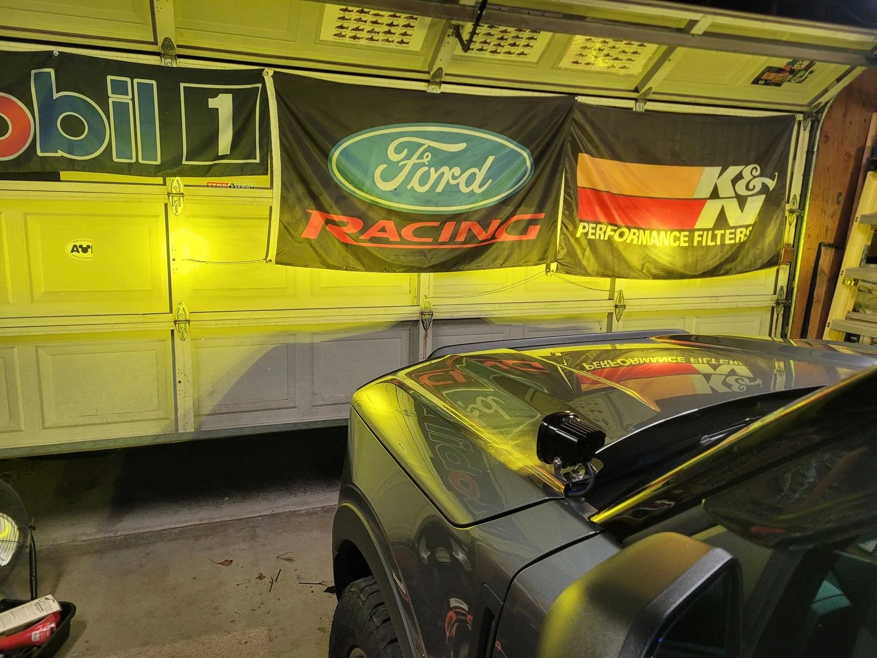

Here's the squadron pro installed. Also changed the brackets to the baja designs bracket as well. Not as thick of steel as the HRG but sit farther back. I think it's a better look. They're more out of the way.

I'm super happy with their performance. I've made some adjustments and pointed them a bit more to the sides. to get a wider field of vision. they'll be put to the test soon going to Yosemite in February
