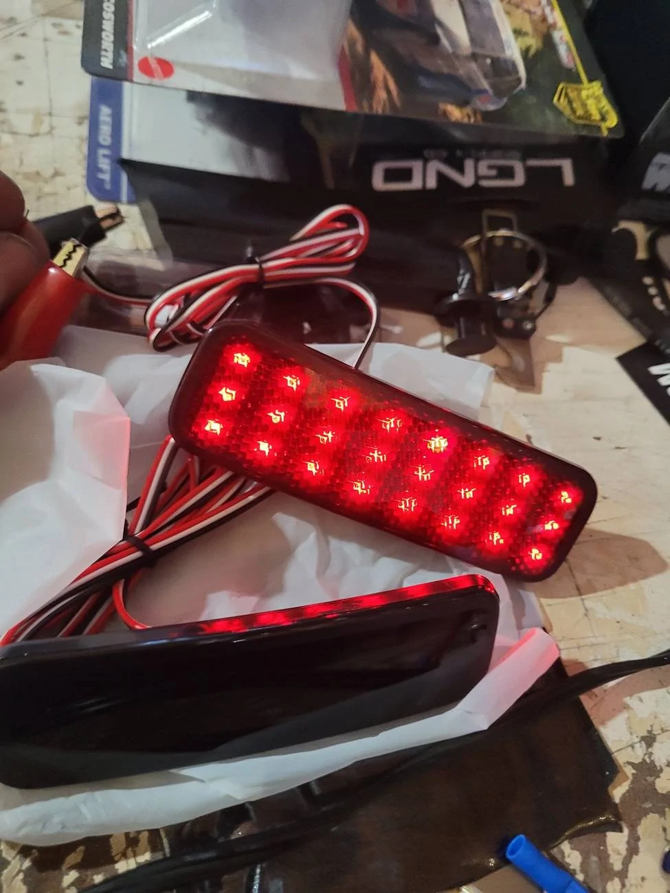

Rear bumper lights arrived today so had to do a quick bench test.
Ford Bronco Sport Quashish Family Ride Thread : 2024 Badlands 20240919_170452
Ford Bronco Sport Quashish Family Ride Thread : 2024 Badlands 20240919_170455

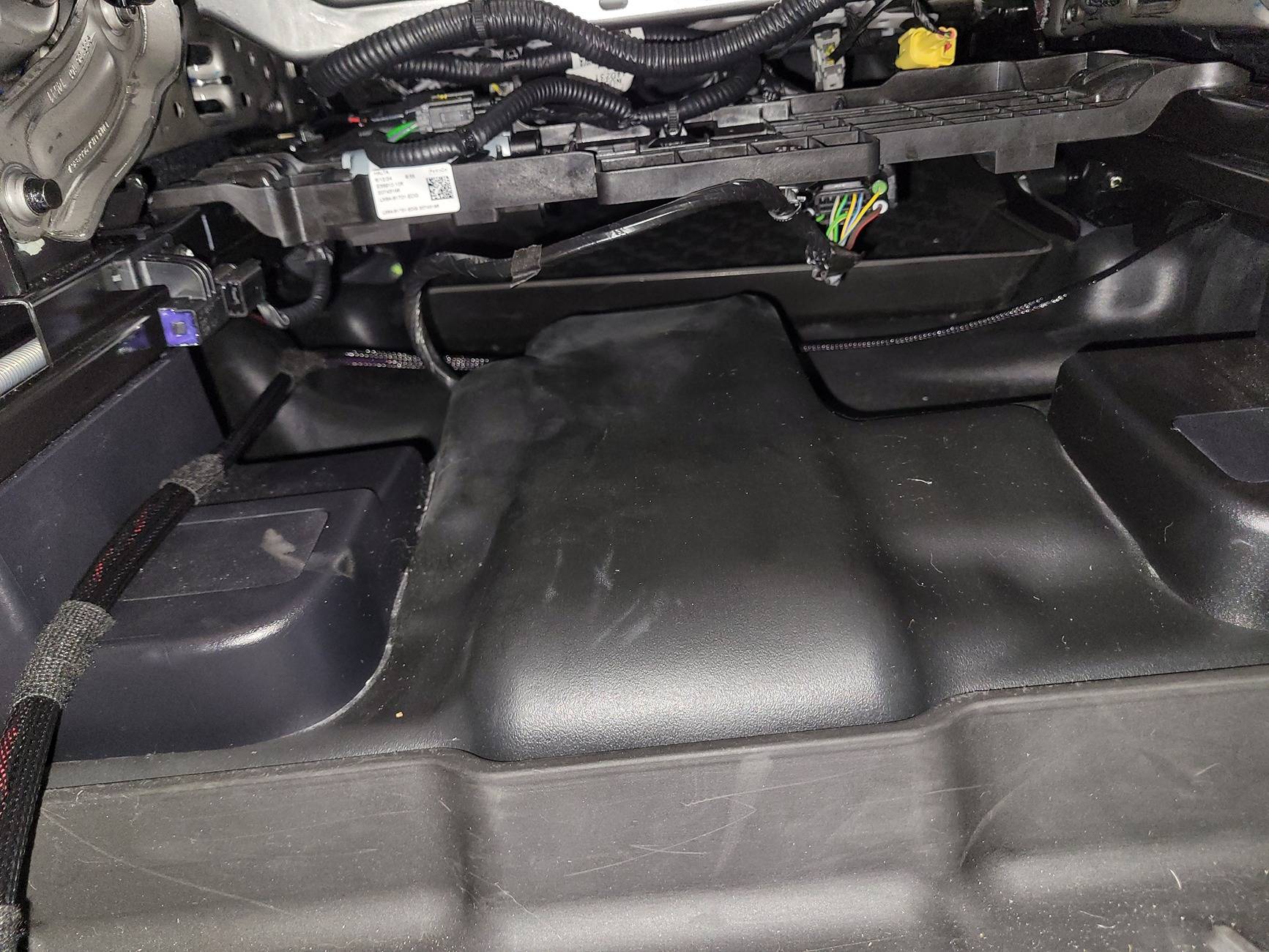

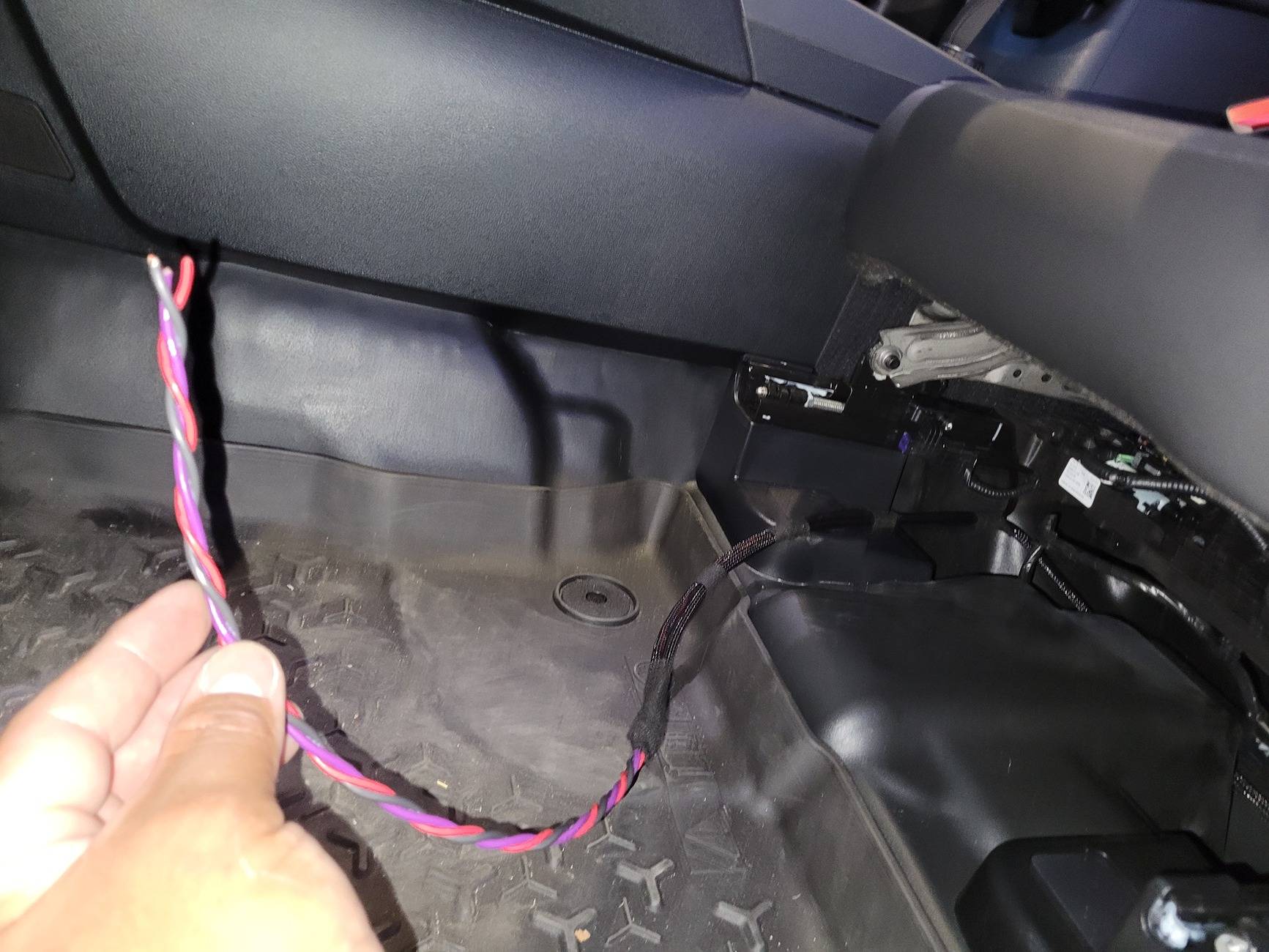

So with those working I went ahead and ran power wires for a switch and a signal wire from switch location to the rear bumper area. Just in time with the sun going down.
Ford Bronco Sport Quashish Family Ride Thread : 2024 Badlands 20240919_191238
Purple wire is my power for high setting I will be using as rear fog.

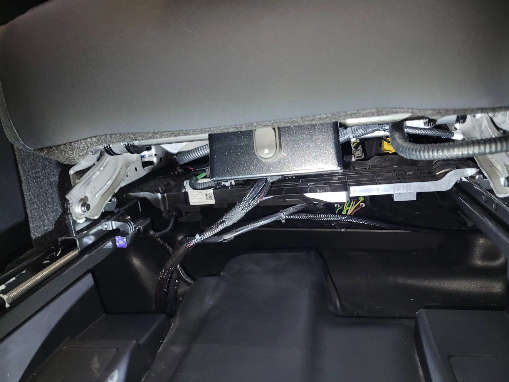

I'm going to make a small box to mount the switch inside and mount box under the seat. Pretty crude solution but I hate the idea of drilling into the dash for a switch. It's a temporarily permanent solution as I may later be using an aux beam switch controller for all auxiliary items.
Ford Bronco Sport Quashish Family Ride Thread : 2024 Badlands 20240919_192225
Ford Bronco Sport Quashish Family Ride Thread : 2024 Badlands 20240919_192249
Power and ground are ran from passenger footwell fuse panel, across to driver side and tucked under center console trim towards the back of drivers seat and then turns forward.
Signal power wire is joined under the seat (will be zip tied out of the way) and ran under B pillar and rear driver side door trim, behind rear cargo trim and through a hole I found into area behind tail lamp harness plug, then neatly ran through that harness plug sleave and taped back up neatly. Ready for further install.

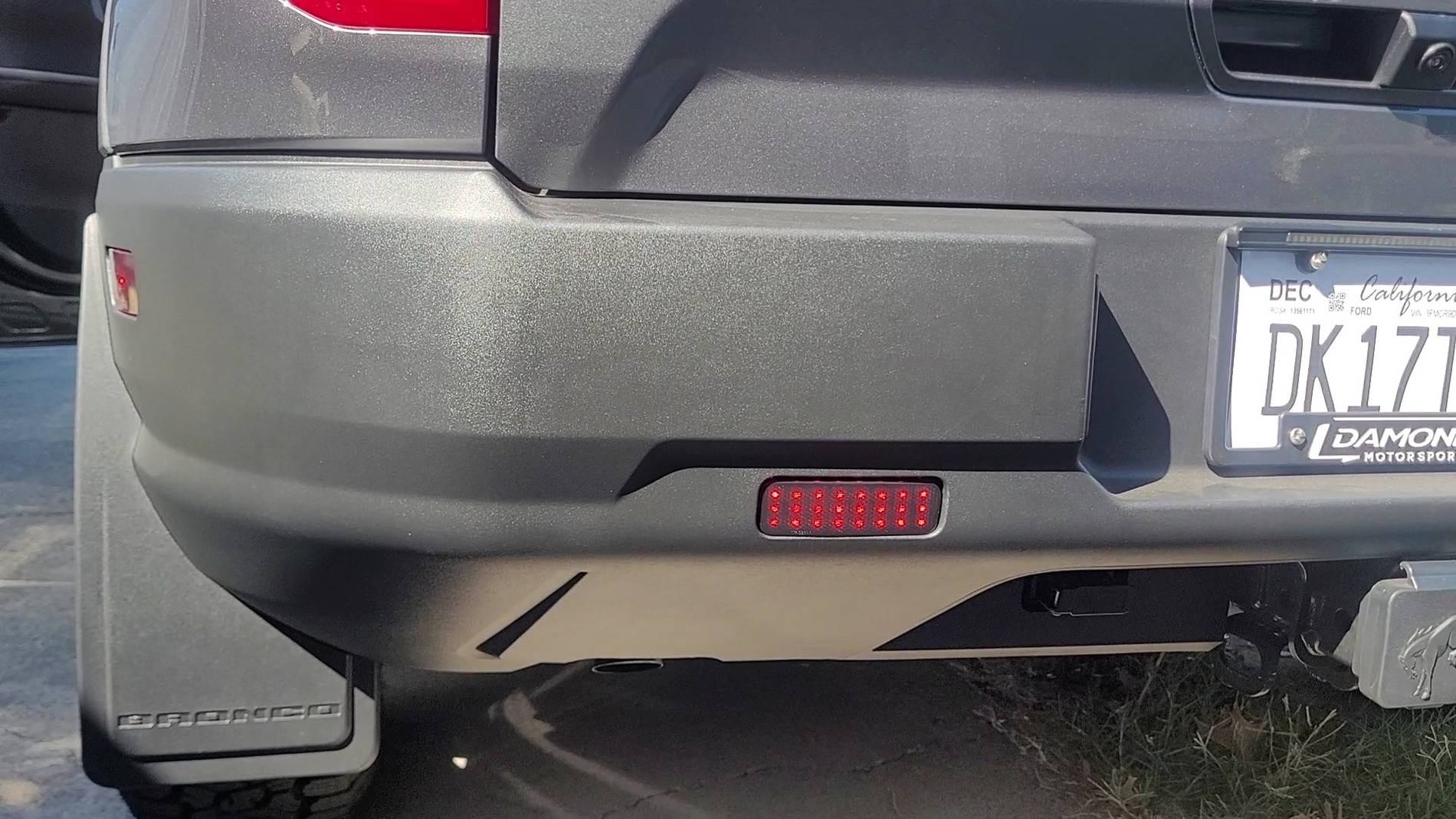

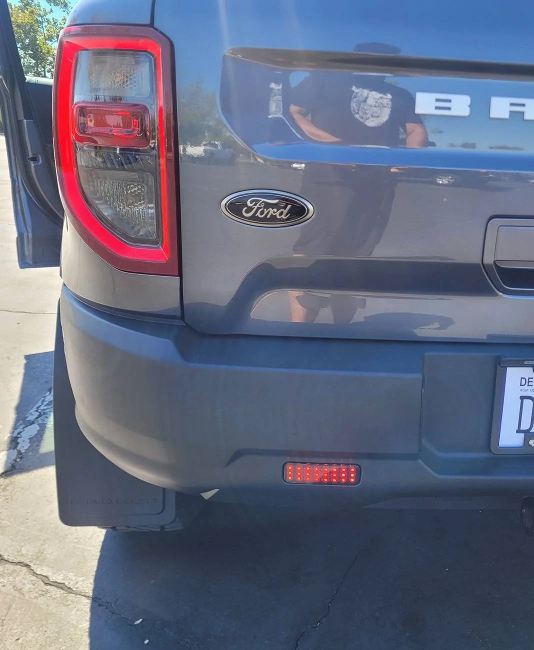

Installed the rear bumper lights/ rear fog lights
Also put the underground graphics light smoke overlays on the front and rear bumper markers, and over the clear portions of the reverse and signal areas of the tail lights.
Not great pics but also in full daylight
Ford Bronco Sport Quashish Family Ride Thread : 2024 Badlands VideoCapture_20240921-212819
Ford Bronco Sport Quashish Family Ride Thread : 2024 Badlands VideoCapture_20240921-212823
Ford Bronco Sport Quashish Family Ride Thread : 2024 Badlands 20240921_132629
I really like how the blacked out rear lights blend into the bumper when off. My only gripe would be how the led design of these Chineseium lights don't match the factory lighting. But it's whatever.
I liked having the rear fog in my old accord because I could flick it on when someone was riding my ass and they would fall back. So now research and development needed on these. But they're decently bright in person

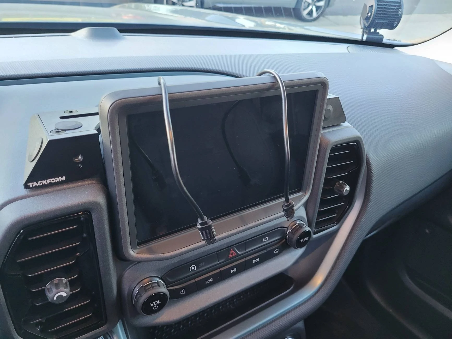

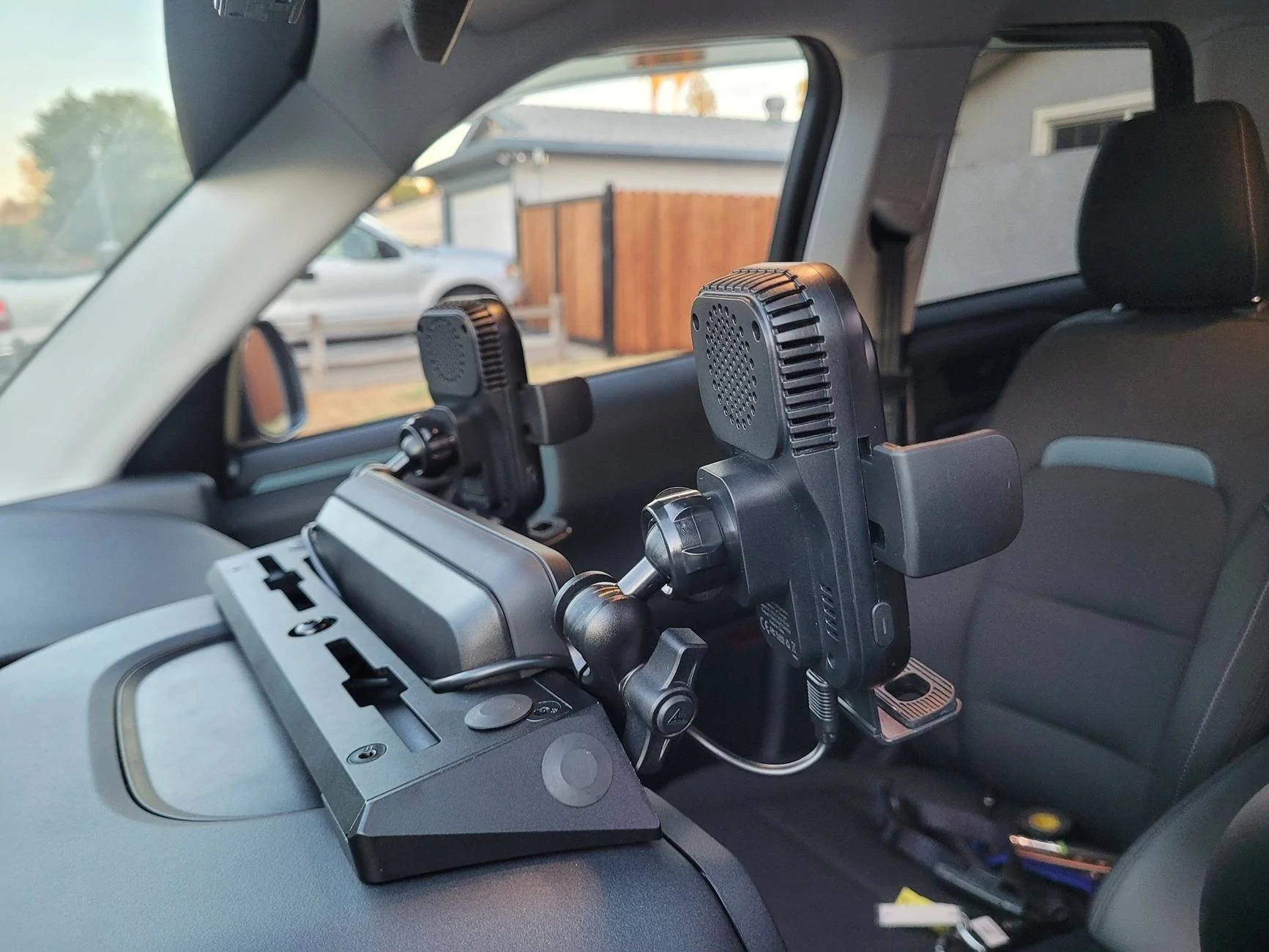

Came home today and installed the tackmount system. Would've been nice to have it on the trip but got delivered after we left.
Ford Bronco Sport Quashish Family Ride Thread : 2024 Badlands 20240929_181331
Ford Bronco Sport Quashish Family Ride Thread : 2024 Badlands 20240929_183731
Ford Bronco Sport Quashish Family Ride Thread : 2024 Badlands 20240929_183753

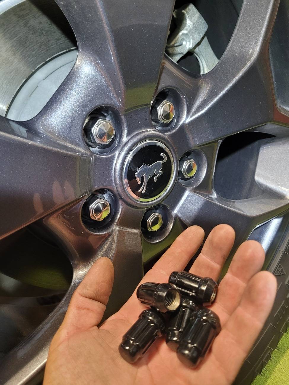

I swapped the factory lug nuts for some solid ones. Always had gorilla spline style lugs on all my vehicles. So went with those.

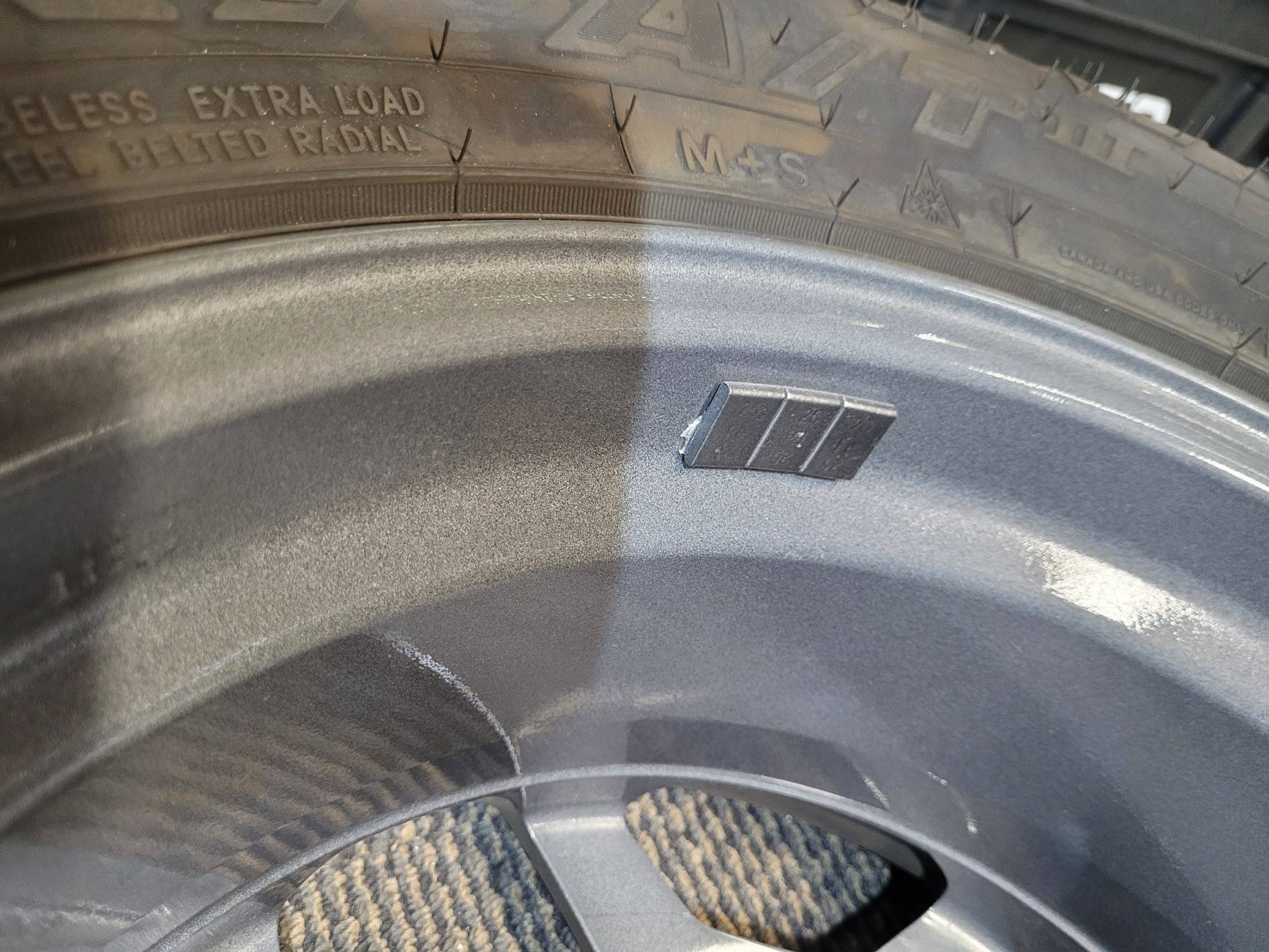

While wheels were off, I removed old wheel weight adhesive ford didn't remove when swapping tires. And somewhat color matched the new weights because I'm obsessed

@Quashish … what is the part # or a link to the gorilla spline style lugs? Are you happy with that brand? Thank you
Gorilla Automotive 21133BC Small Diameter Acorn Black 5 Lug Kit (12mm x 1.50 Thread Size) - Pack of 20
https://www.amazon.com/Gorilla-Automotive-21133BC-Diameter-Thread/dp/B001O0AMZS/ref=mp_s_a_1_1?crid=19832EGKFGXPF&dib=eyJ2IjoiMSJ9.5tTwn5UJ3P6UjPelktKh9Fk__IbRNvldLMl8hfsq1iNx2Af4AE-eOVdDQhav8FyJZI41JVmcJkpYl48OvBjt0Q56-h3Ub62Y56sG5_wbtqjXSq3r5dXfzrZDZ8AshggvpwjFjL7ufsq0Dxn6dBbMJxfCfJVvhQ4bcvYpJ2szlQnk1SxGAa5_8U4U33DxvxDkhk_9gRFugUSt4Ls9H4M5Iw.jV1OnRRh3GS7CKORDny8U3sUNc_08HOUh4lwxuMngSI&dib_tag=se&keywords=m12+x+1.5+lug+nuts+gorilla&qid=1726988605&sprefix=m12+x+1.5+lug+nuts+gorilla,aps,161&sr=8-1
Avaliable on Amazon. But most reputable online sources sell them too
had these these on 4 vehicles either black or chrome. They keep their finish well, and add a small layer of security.
