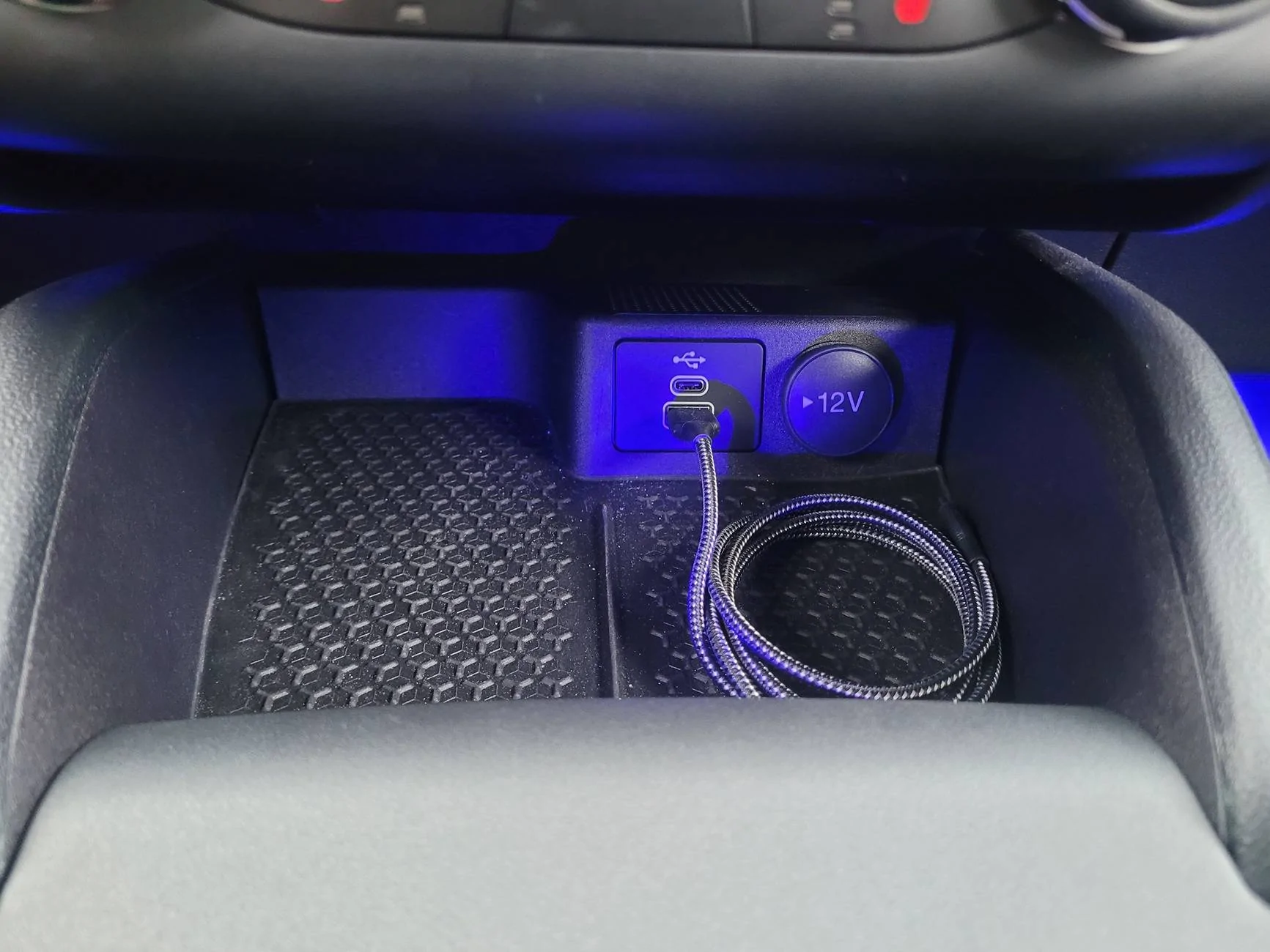

Is this going to be facing forwards towards the driver or downwards?
The 1st cubby light i put in I put it pretty far back in the cubby facing downwards towards, when I put my phone in the charging slot I could see the reflection of the led on the phone screen and it bothered me, alot, 2nd time I installed the light further forward towards the front entrance of the cubby and no reflection is visible on my screen.

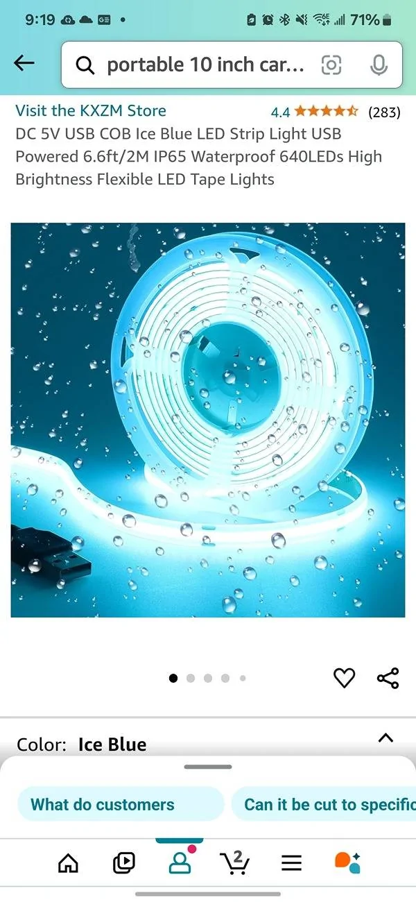

I ended up using a 1" piece of an ice blue cob light which was still very bright and a 5v dimmer switch, the 1" cob led was stuck to the top of the cubby with 3m, it's powered from the 12v in the cubby, all the wiring is tucked away nicely and can barely be seen.

This will be firing towards the gear selector area not down for the same reason you mentioned, to avoid reflections. I haven’t got much time to work on it. It is painted and clear coated, though not pretty. I need to get the wires set up. Hopefully install today. Going to hardwire like everything else so I’ll still have the power points available for options.

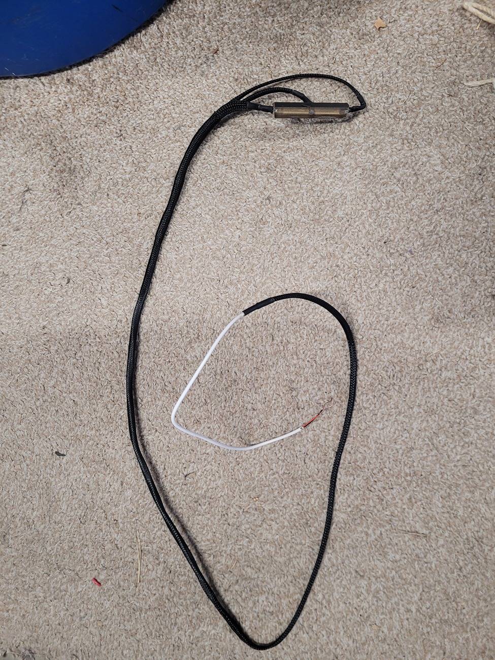

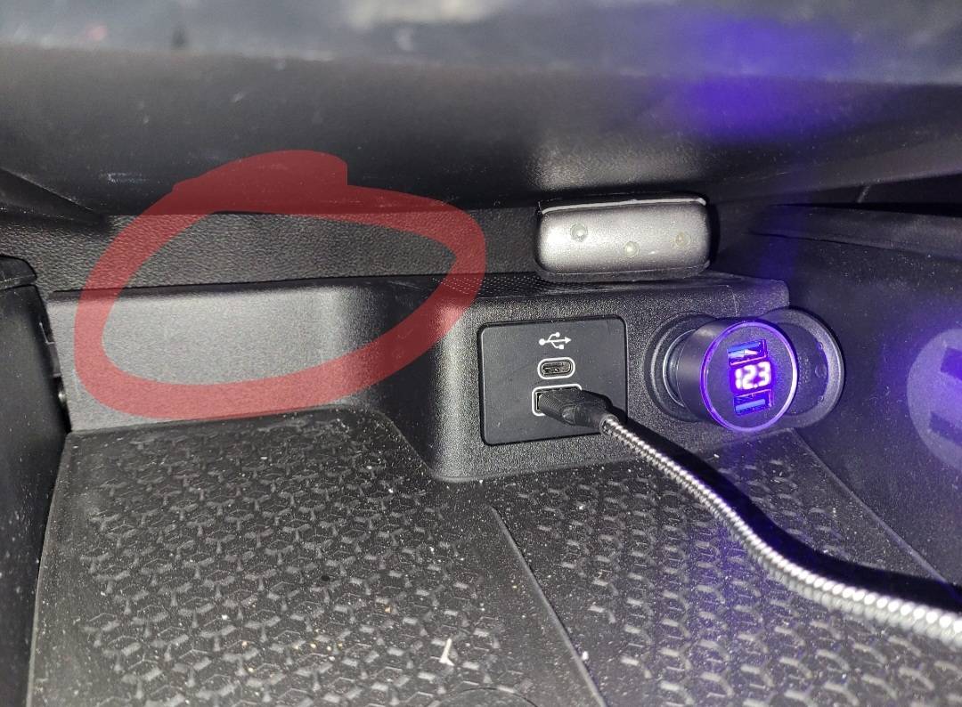

I was able to paint it and get 2 good coats of clear on it. Middle led decided to quit working after I got wire all neat and tidy. Maybe I got too hot with solder or something, not sure.
We'll call this one Version 1. It was supposed to fit in the circled area pointing forward. But 3M tape wasn't cooperating and end result was chunkier than I had needed it. Ended up wedging it in opposite corner.
Ford Bronco Sport Quashish Family Ride Thread : 2024 Badlands Screenshot_20241107_211618_Gallery
Ford Bronco Sport Quashish Family Ride Thread : 2024 Badlands 20241107_210930
End result is good even with 2 leds out of the 3.
Already got ideas for Version 2. Going to work with materials I'm used to. Fiberglass takes too long, too many steps and not very forgiving. For this instance anyways. Itvwas a good experiment though

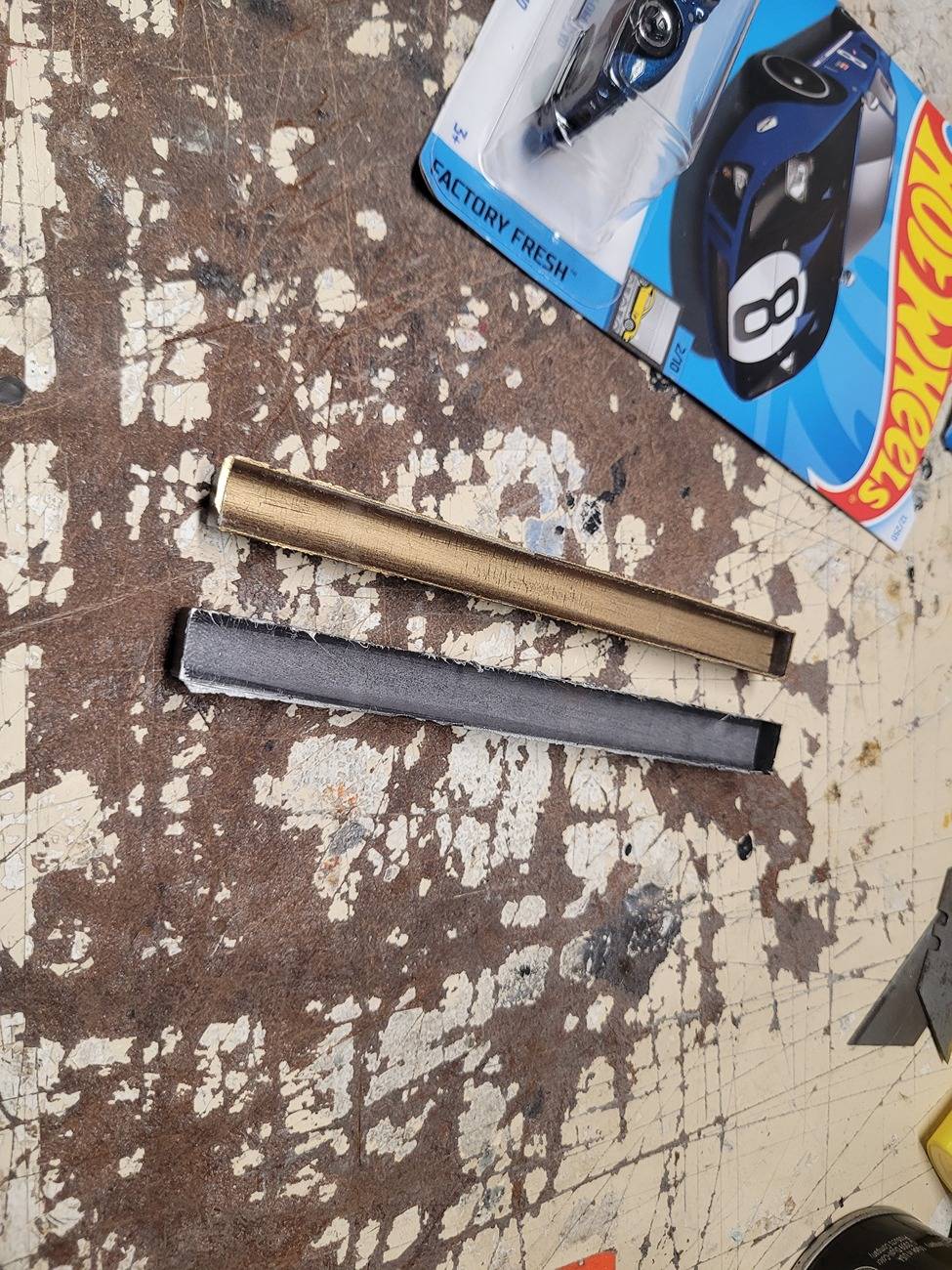

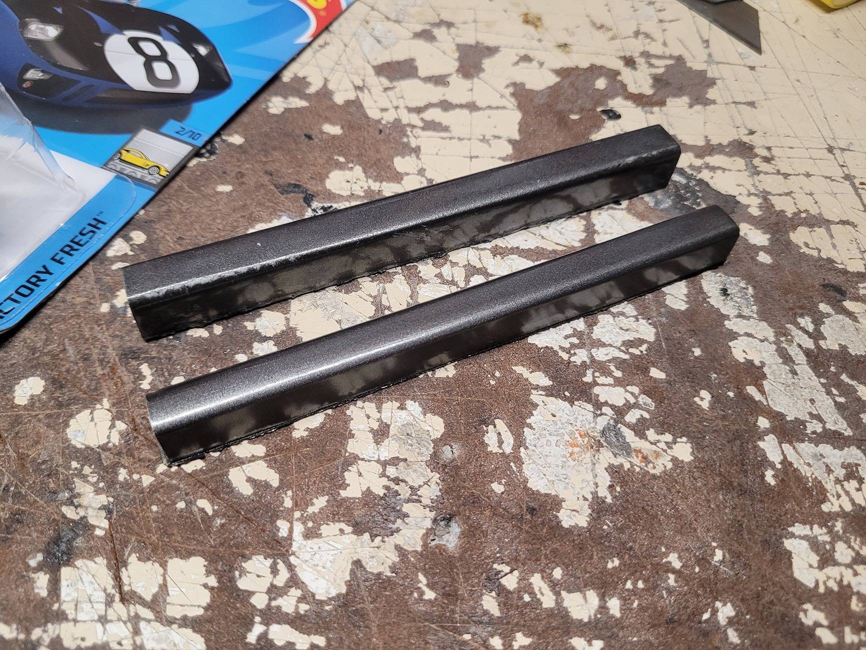

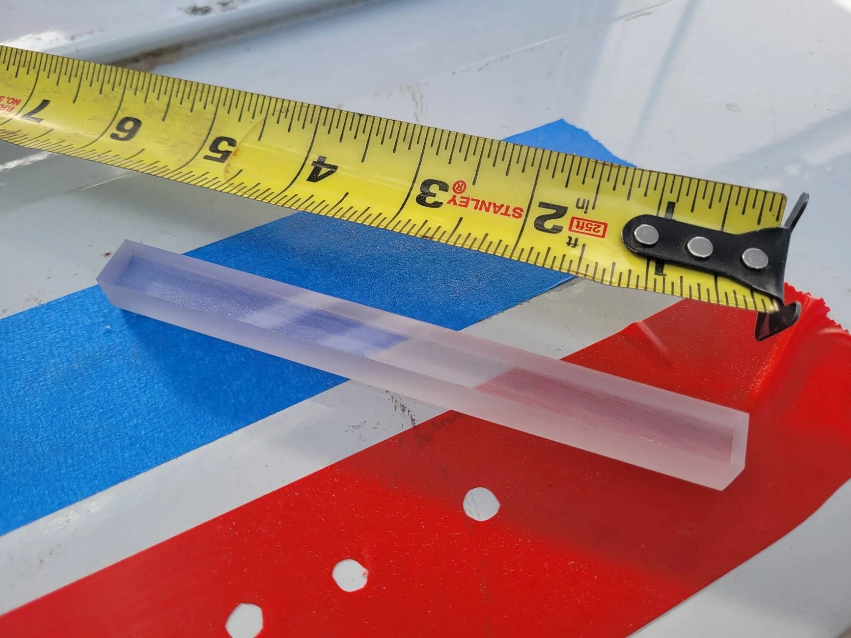

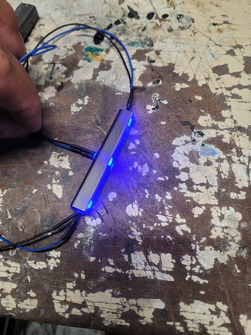

Start of version 2 pocket light. Going to copy the factory pocket light but bigger. I didn't measure the pocket at all yet but cut these pieces of lexan at 5" and 1/5" x 1/5". Sanded 3 sides left 1 clear finish which will be the front.

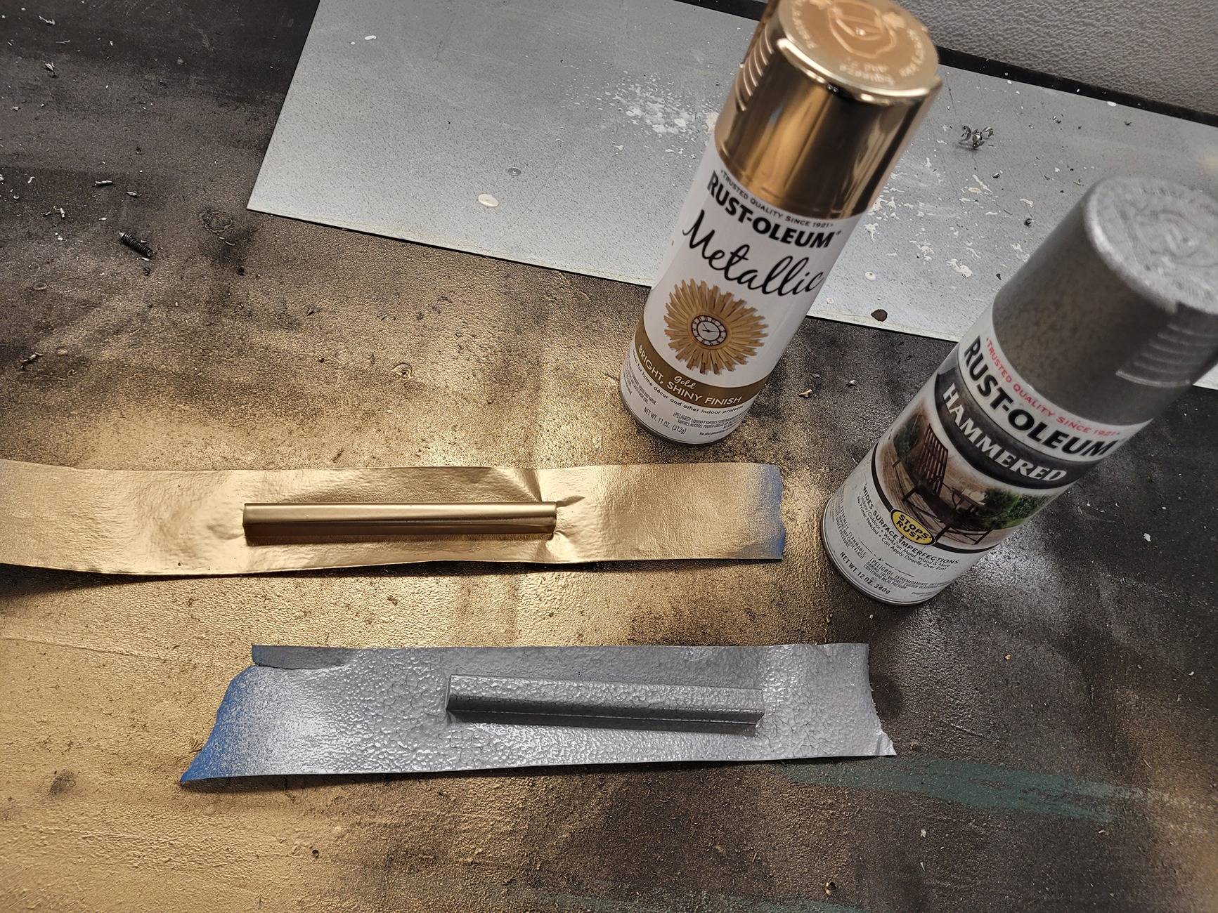

Didn't have chrome paint, only had gold and an almost metallic hammered texture silver. So did one each way to see which one is more reflective or if it makes a difference.
Will be using 2 leds one on either side firing at eachother.
Ford Bronco Sport Quashish Family Ride Thread : 2024 Badlands 20241115_145014
Ford Bronco Sport Quashish Family Ride Thread : 2024 Badlands 20241115_153726
Ford Bronco Sport Quashish Family Ride Thread : 2024 Badlands 20241115_203711
Ford Bronco Sport Quashish Family Ride Thread : 2024 Badlands 20241115_203656
Painted over the outside. Rustoleum and duplicolor don't get along great. Going to get leds in these and test brightness. The install will require some cutting off factory trim pieces.
Either this which is basically free or $50-$80 for the factory one and still have to mod it like the cup holders.

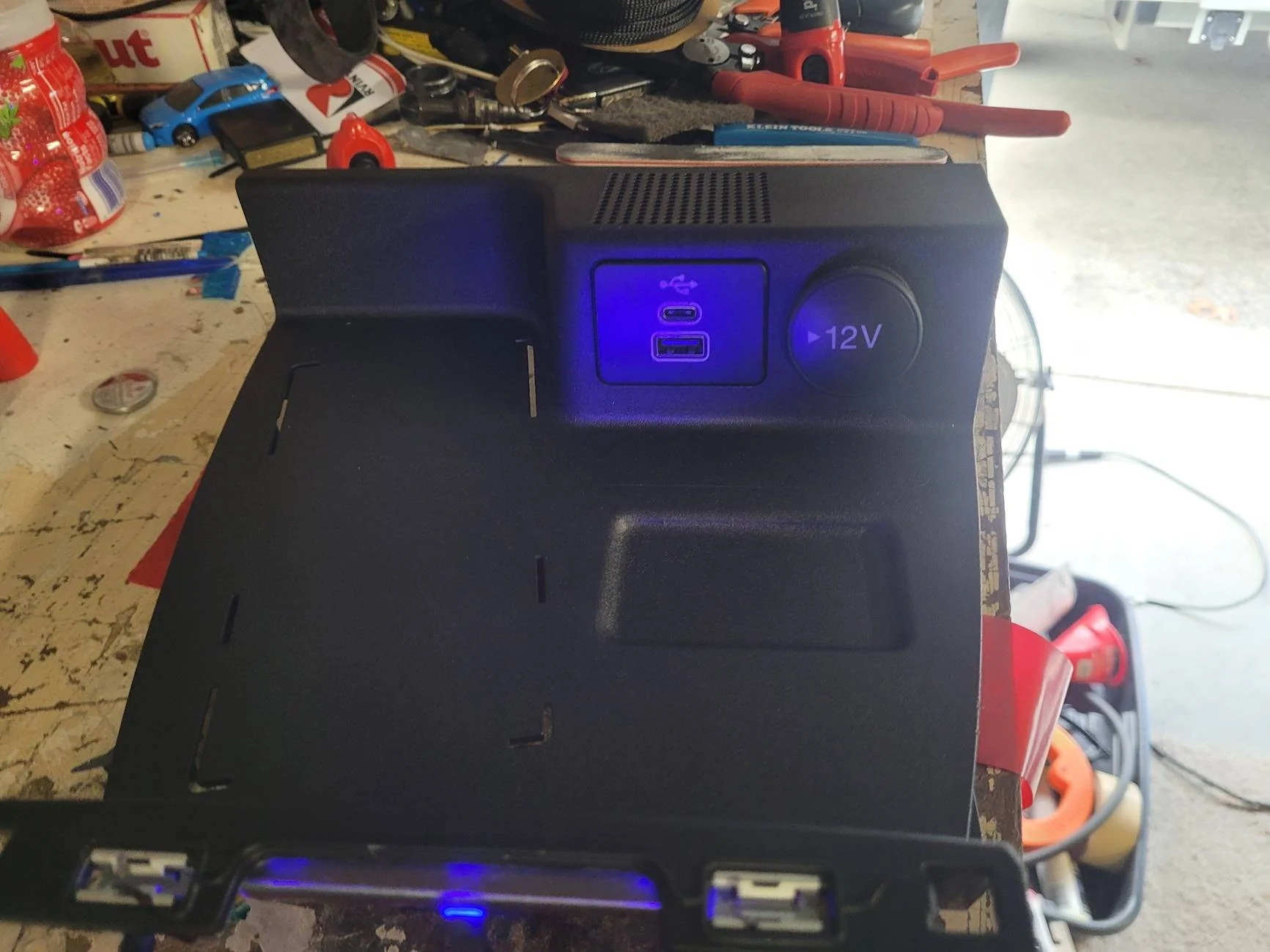

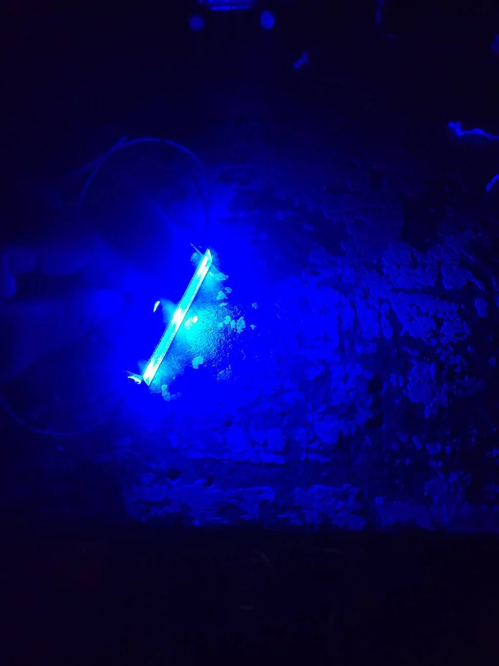

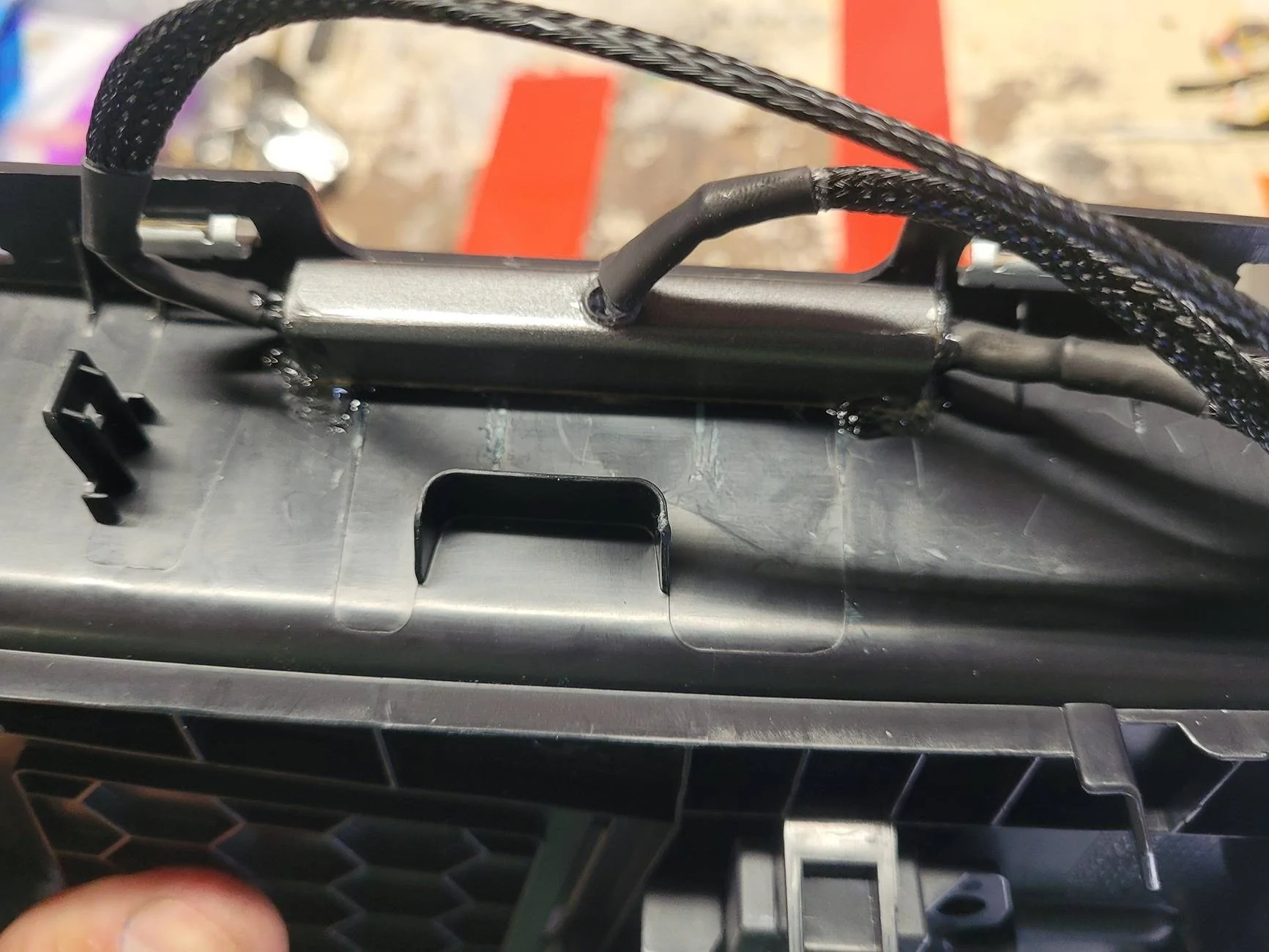

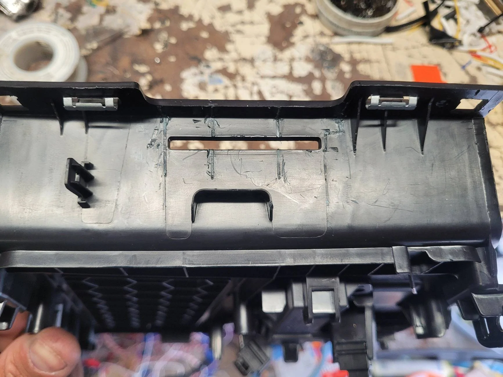

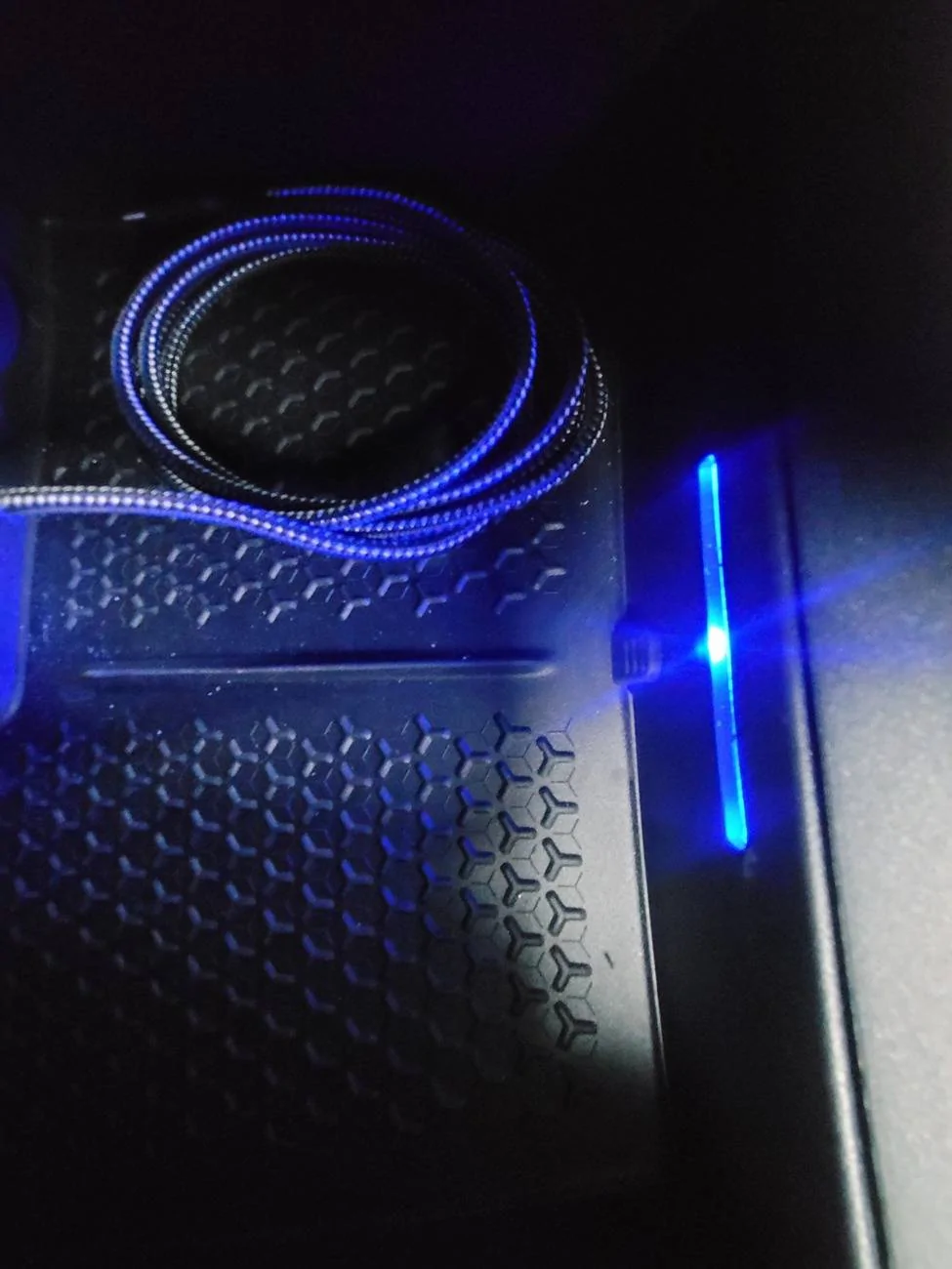

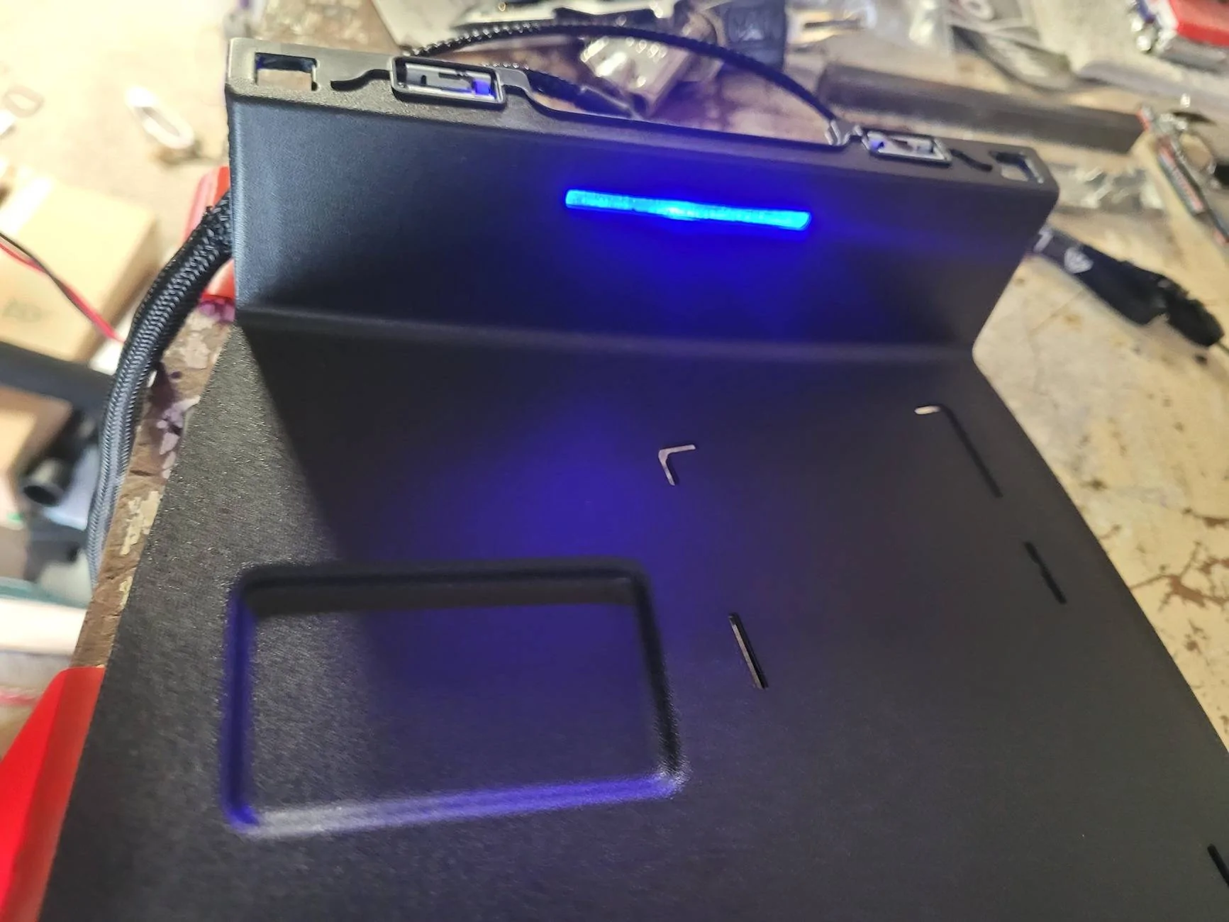

Well here's what I made work. Not sure if it's brighter than the oem light but it matches the blue.
Started by removing the piece not too bad clips were the hardest part.
then shaved off the plastic where the factory clear plastic light emitter would have gone.
Ford Bronco Sport Quashish Family Ride Thread : 2024 Badlands 20241117_142408
Ford Bronco Sport Quashish Family Ride Thread : 2024 Badlands 20241117_131642
Ford Bronco Sport Quashish Family Ride Thread : 2024 Badlands 20241117_131634

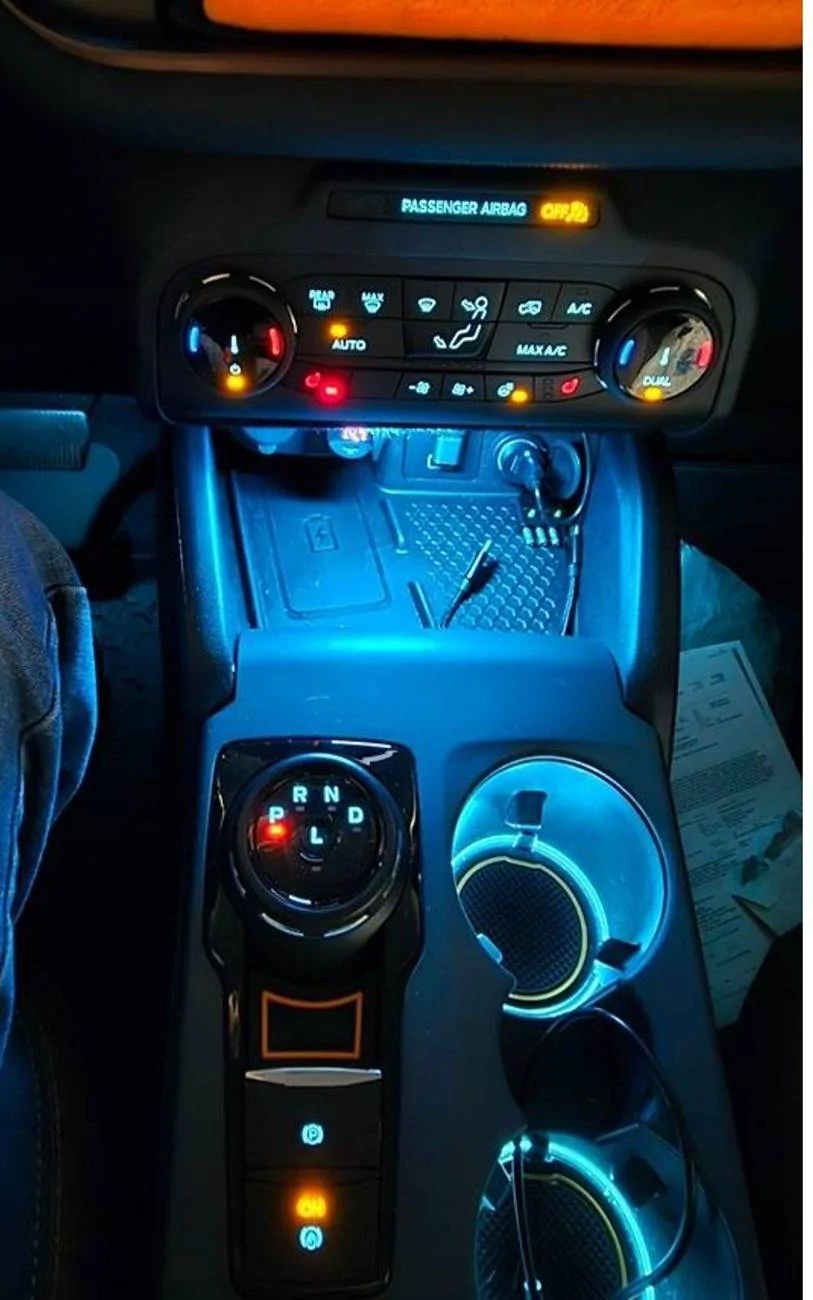

Oh yeah and I added a 3rd led after all. Did some pretty wiring
Ford Bronco Sport Quashish Family Ride Thread : 2024 Badlands 20241117_142431
Ford Bronco Sport Quashish Family Ride Thread : 2024 Badlands 20241117_143504
Couple dabs of crazy glue. Then a couple more. This stuff is really good for plastics.
Ford Bronco Sport Quashish Family Ride Thread : 2024 Badlands 20241117_150927
Ford Bronco Sport Quashish Family Ride Thread : 2024 Badlands 20241117_143536
Ford Bronco Sport Quashish Family Ride Thread : 2024 Badlands 20241117_143542
Ford Bronco Sport Quashish Family Ride Thread : 2024 Badlands 20241117_145805
Ford Bronco Sport Quashish Family Ride Thread : 2024 Badlands 20241117_145817
Ford Bronco Sport Quashish Family Ride Thread : 2024 Badlands 20241117_151643
There you have it! Cheers!

Look really good, where did you power it from
Quashish
Quashish
Tomas
Jun 2, 2024
1,066
1,427
Sacramento
2024 Bronco Sport Badlands

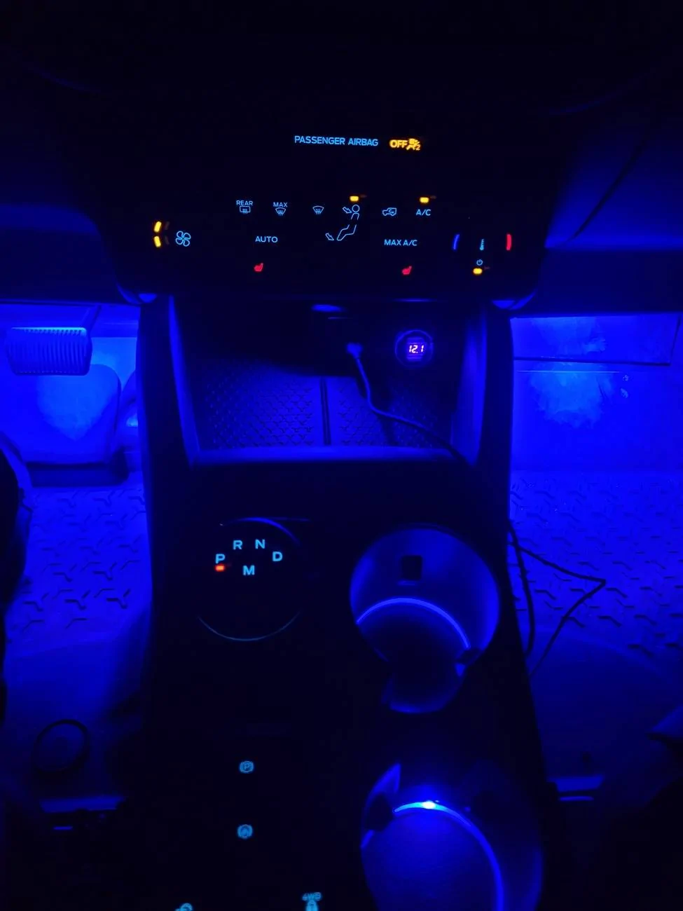

I have all these extras going to An add a fuse on the passenger side fuse box. I'll probably get a distribution block of some kind at some point just haven't found one I like that's small enough. I got all the positive leads wire nutted together from the add a fuse, and the negative wires wire nutted together from a circle lug to one of the 10mm bolts down there for ground.
The two usb c cables for the wireless phone charger holders are in their own cigarette lighter type power point down there too.

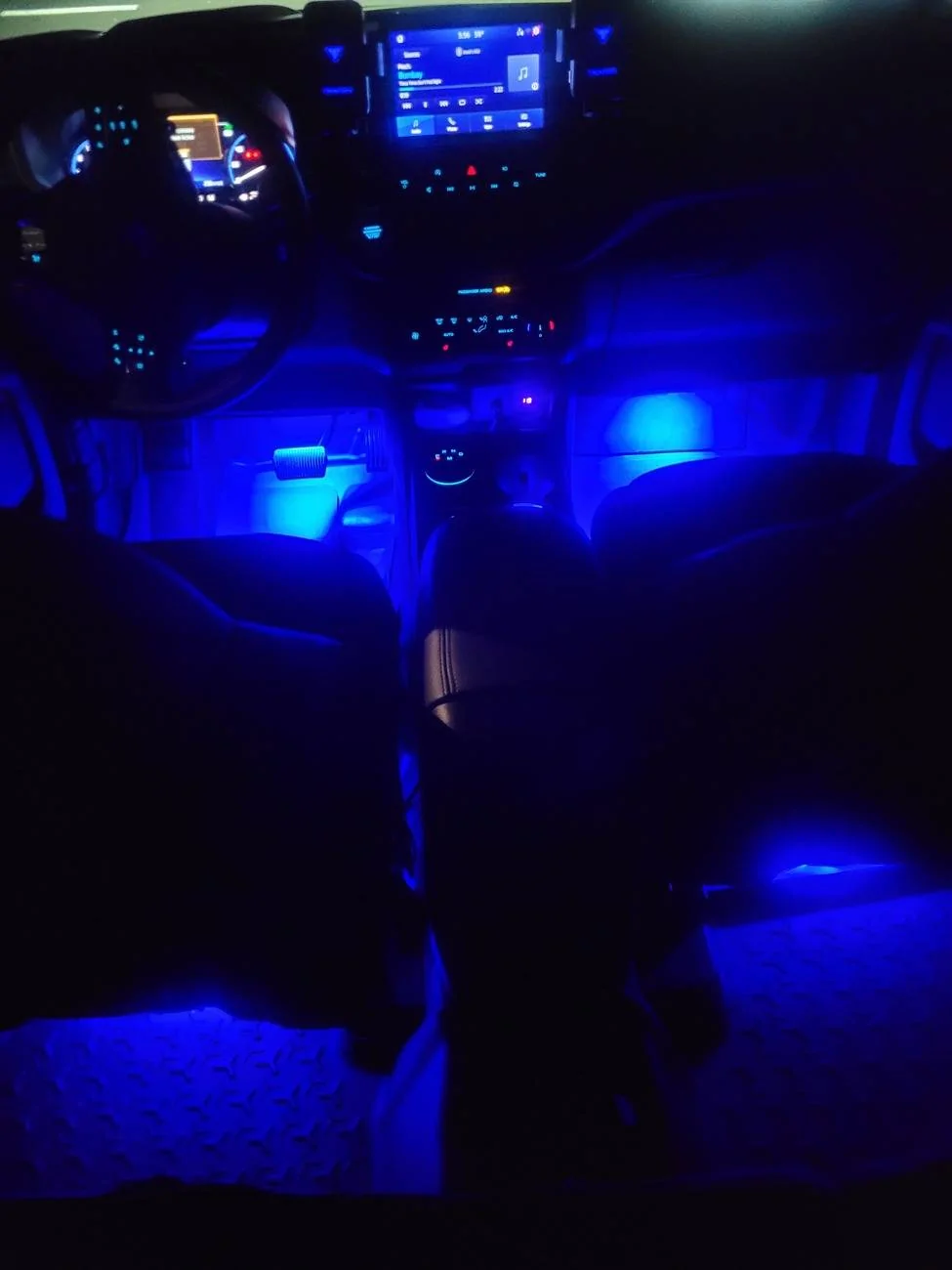

I'll get a night pic tonight. We're supposed to hit a movie later
