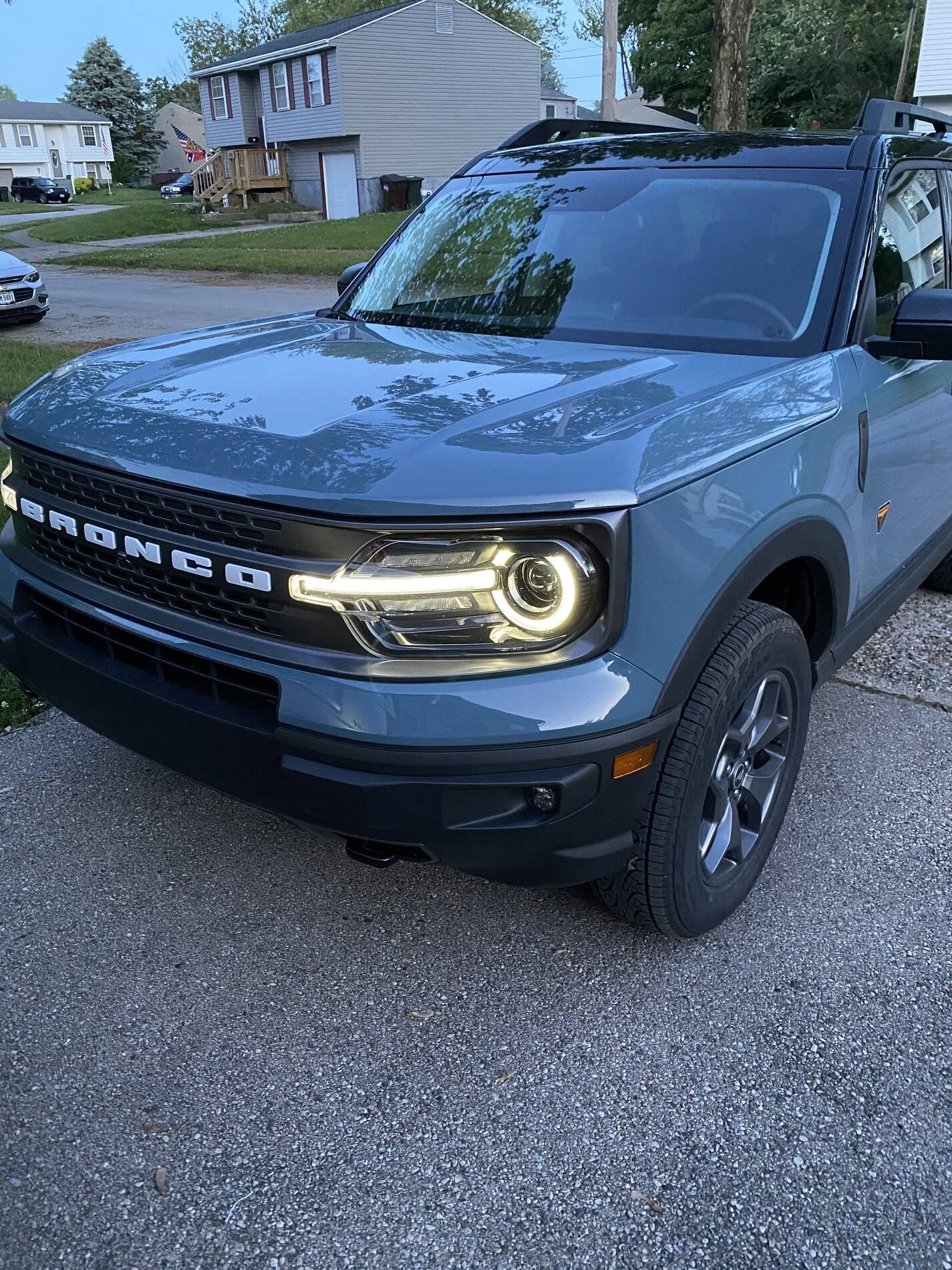

I know this is an old thread but I recently bought a First Edition. I noticed the DRLs stay lit long after the lights went out (set to 120 seconds).
After seeing this post it set the delay to 20 seconds and everything turned off as it should. It seems my issue is on the longer delay. I have 6 weeks remaining on the basic warranty so I'm debating if I should bother having it looked at.
Are you stating that setting the delay to 20 seconds the lights turn off at 20 seconds but setting the delay to 120 seconds the lights will not turn off even after much longer than 120 seconds?
if it’s that easy to replicate you can show the dealership but if intermittent it might be difficult for the dealership to diagnose the issue.

The lights go out at 120 seconds but the DRLs stay on. At 20 second delay, everything goes off as it should
Be sure that all doors including rear hatch are fully closed (others reported a door left open and DRLs stay on).
and are the DRLs staying on more than 10 minutes? (when you have the headlamp 120 second timeout selected)
and if it is repeatable you can have the dealership diagnose.

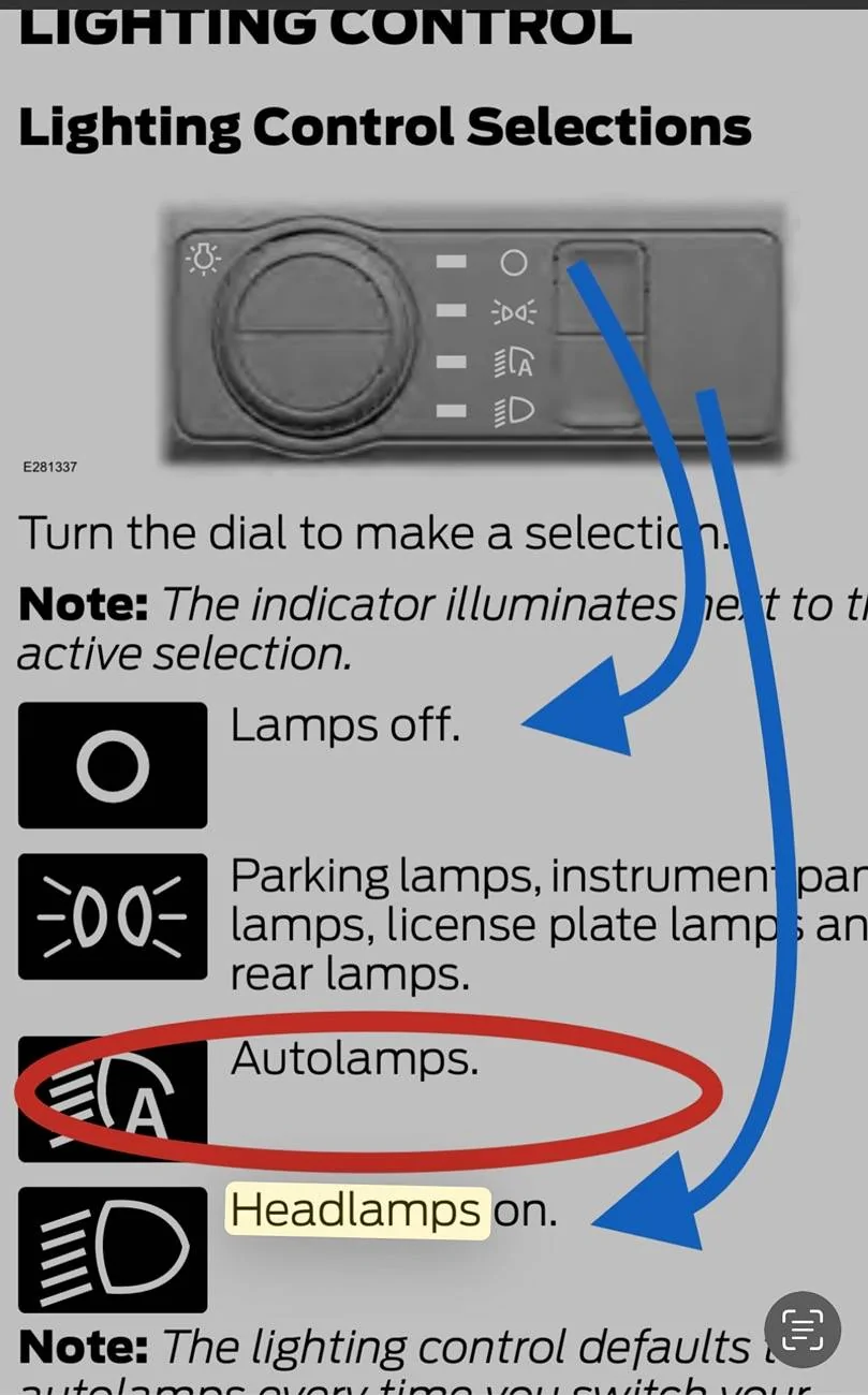

”most” people who post about the lights staying on for ‘21-‘23 models have had the headlamp module replaced which solved the excessive time lights remain on
I think the part is relatively cheap and seems to have been redesigned to correct the issue
There is a TSB or SSM on the issue but I can’t recall what it is. The only similar SSM I have is this one (not saying is applicable to your post it’s just one I recall):
SSM 51645 ZUZ1-ZUZZ Bronco
Sport - Low Beams Turn On By Themselves While The Vehicle Is Off For 10 Or More Minutes - DTC B1533
The headlamp module applies to this instrument panel switch and is often difficult for a dealership to diagnose as the problem (because owners have reported the issue cannot be replicated every time):
