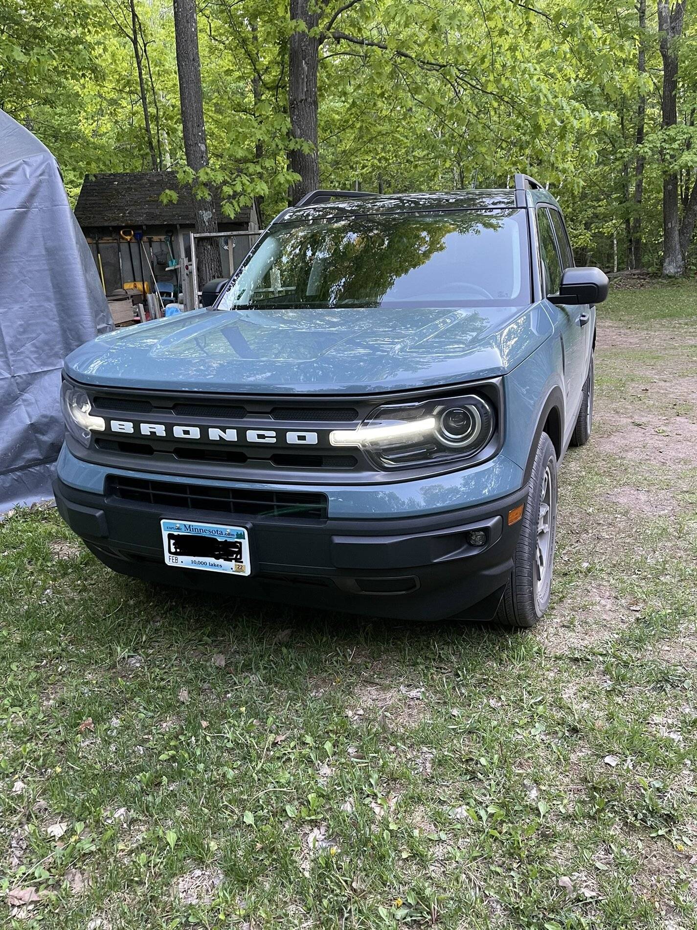

2021 Ford bronco Sport
I’ve had my Bronco sport for a few months now and love it. The other day I went into a store and came out (30 min later) and part of my headlight was on. I opened the door and closed it and it went off. I blew it off. A week later I looked out the window and saw the same thing. I have no idea how or why this is happening. Anyone else have this happen or know what’s going on?
Ford Bronco Sport Part of headlight staying on 286F0807-3875-4716-A656-7FAAAB87152E
The daytime headlights can be configured to turn off at different times when you shut off the engine supposedly to illuminate the path to your home door. On your display, hit settings and navigate to headlights settings.
