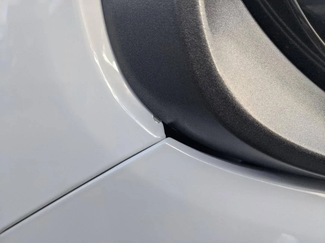

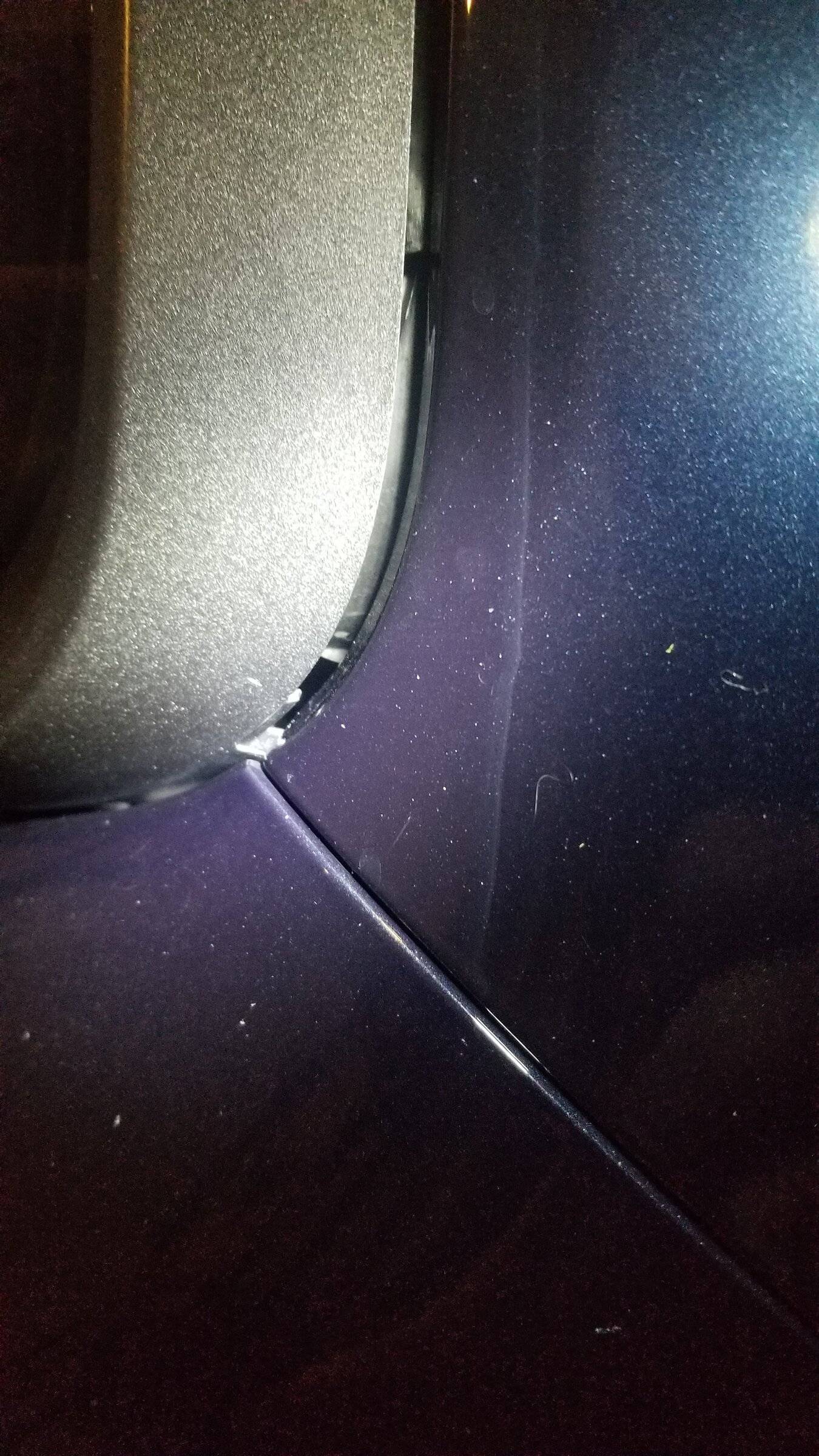

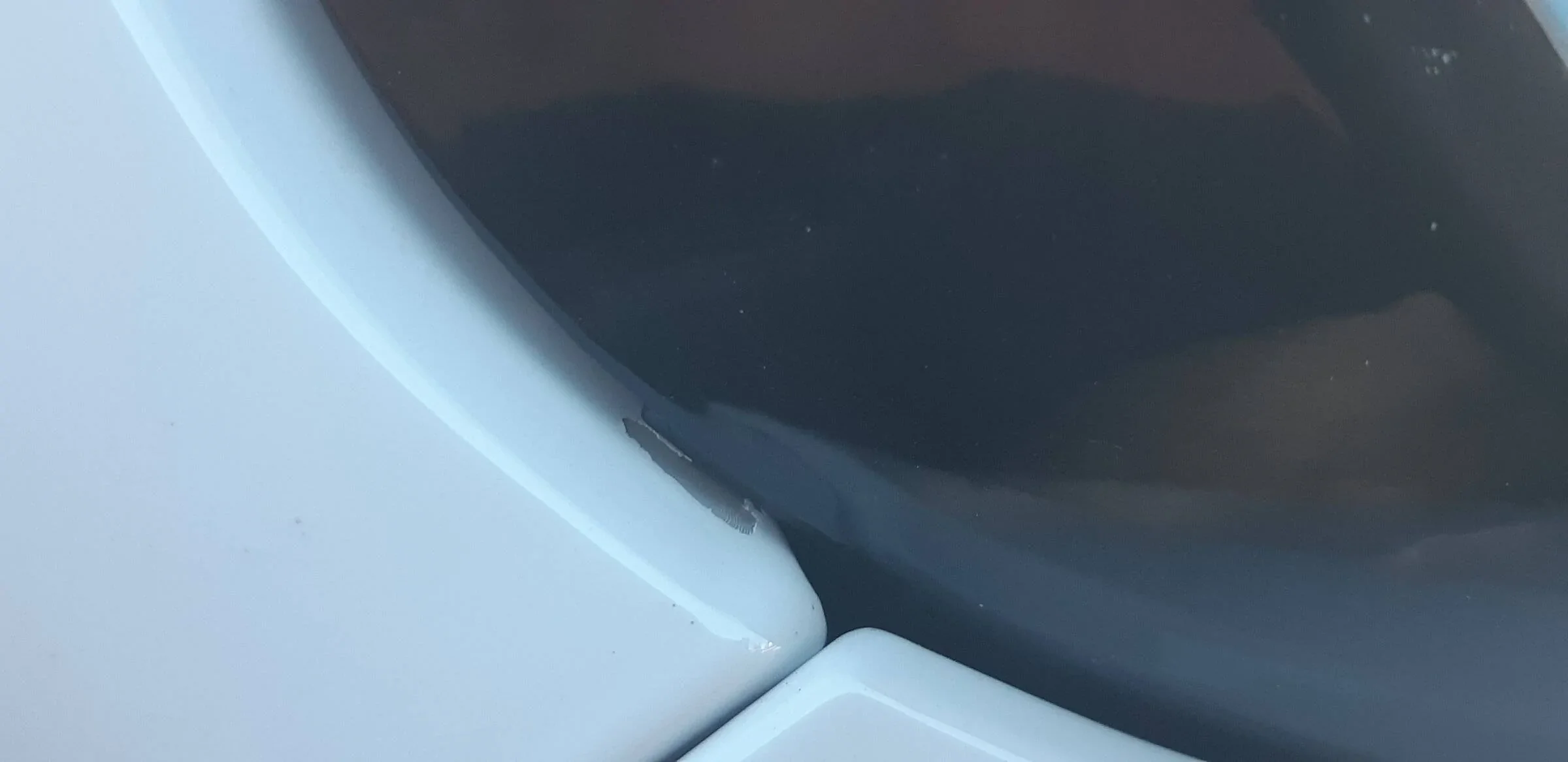

I've joined the club, crap. I was keeping my eye open for the issue and found it today. Ford dealer took pictures and will get to me on course of action. Did anyone get a resolution?

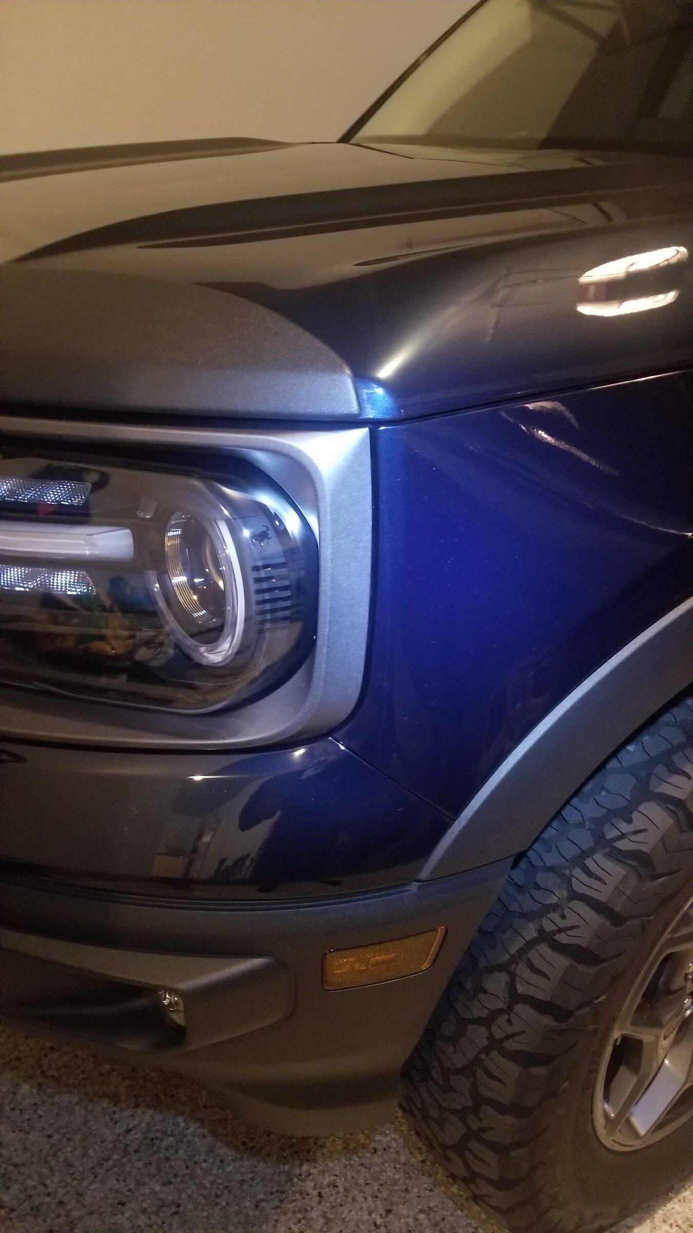

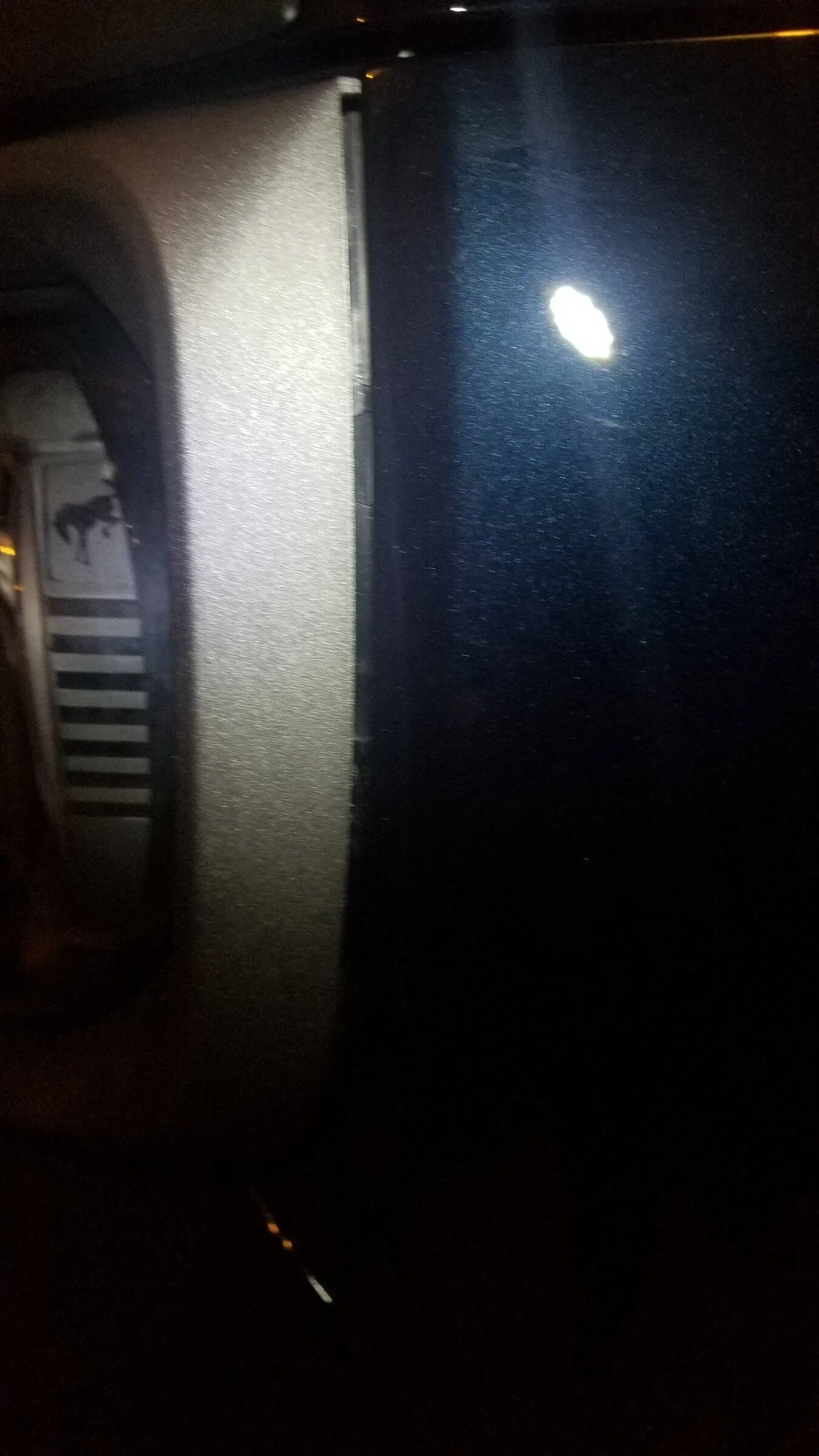

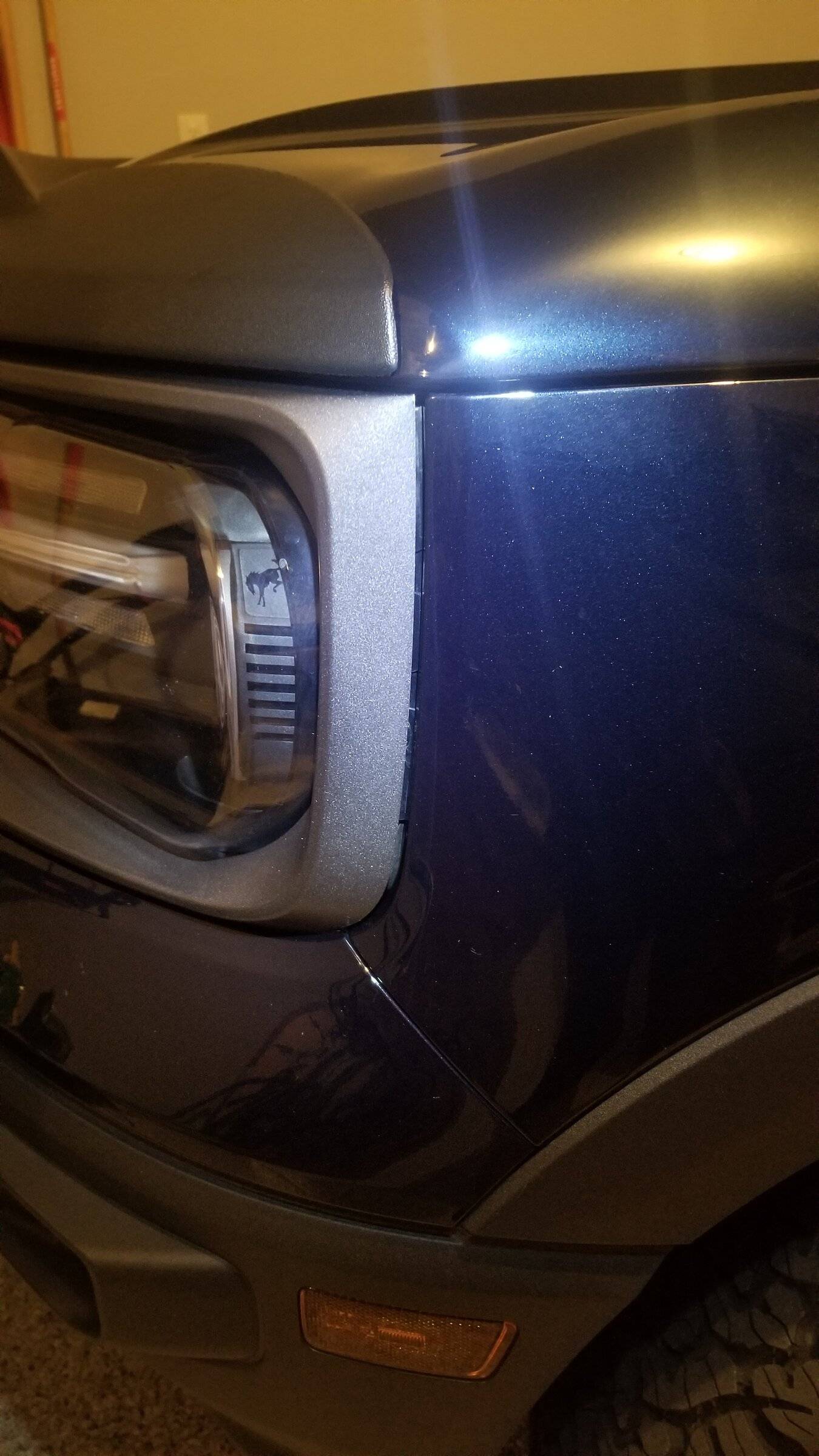

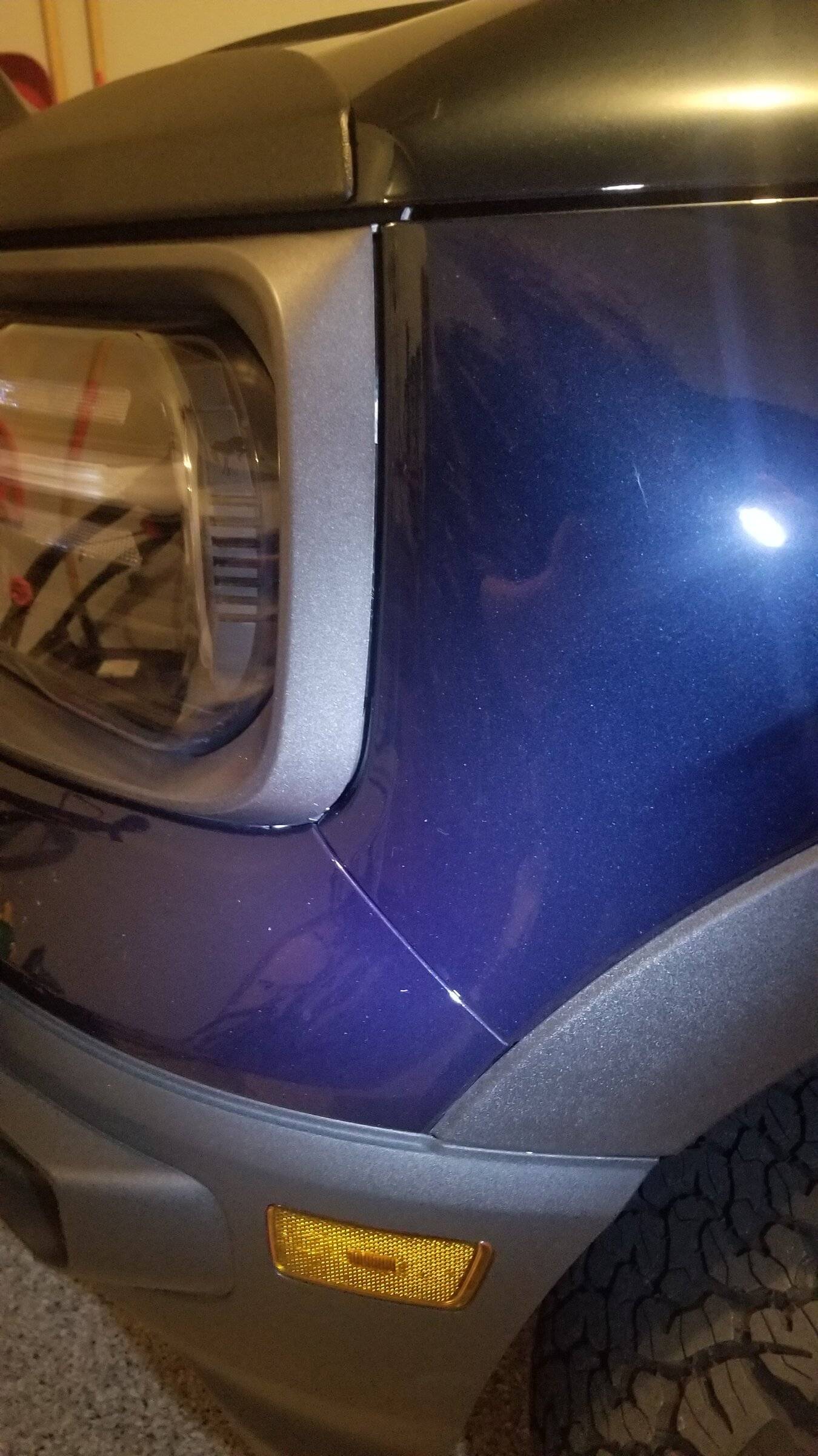

Just picket mine up, took 2 days, all under warranty again. Looks good, they added some spacers to the light assembly to make it flush but not touch.
Does it look any different with the spacers? That sounds intriguing, would love to see a pic to compare.
Oct 20, 2021

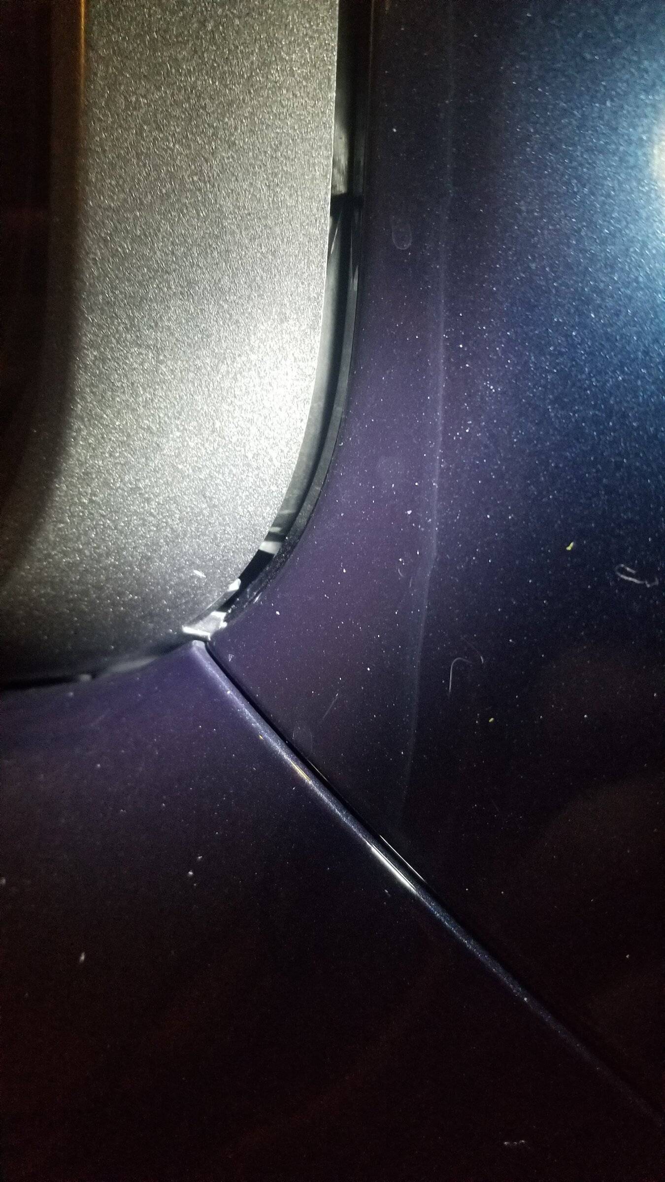

Oops though I added them. It does not look any different other that there is a bigger gap, but maybe 1/8 of an inch. I am not the best photographer and I'm not in my garage with the shop light but hope you can see it. Drivers side but passenger is the same.

Those are great, thanks for doing that. I hope that solution works! Doesn't seem like a very complicated fix.

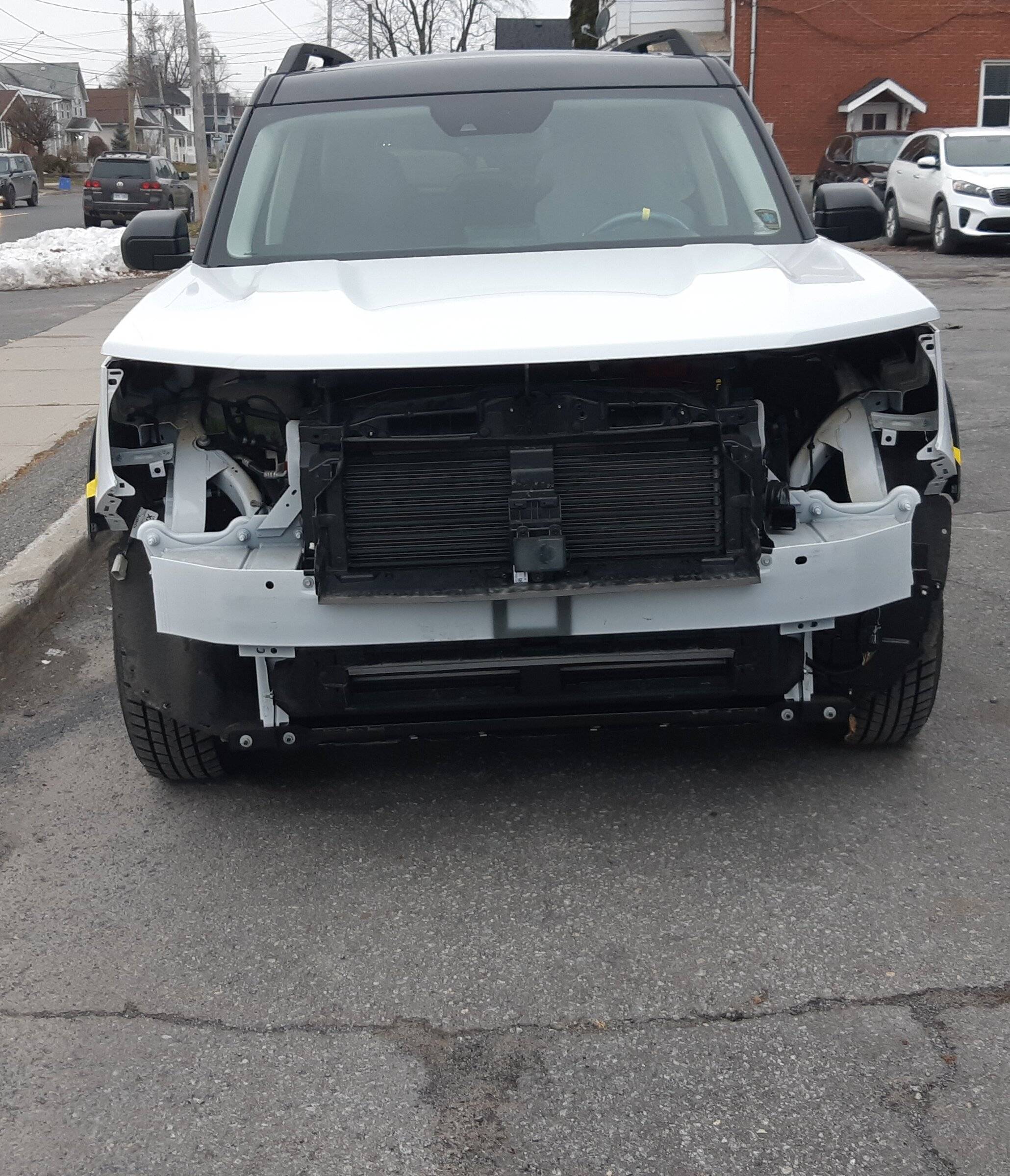

Update: I went to the body shop (excellent one btw) and they underestimated the time frame. It's more like 4-5 days. They use a labour guide on performing this job. A lot of disassembling goes on. Most of the cost is in labour and little for the paint and finish (total job is expensive).

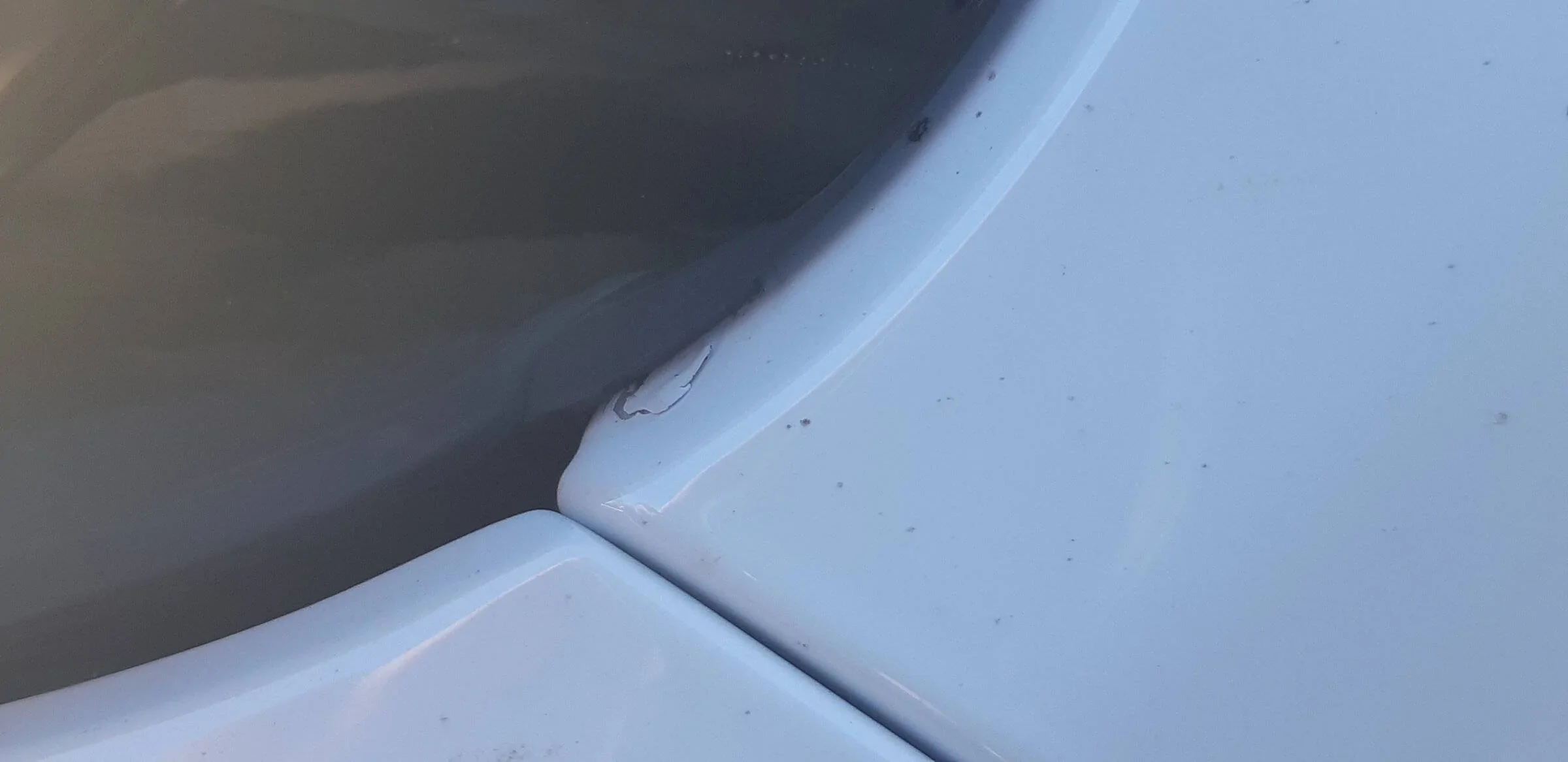

The body shop advised that thers is not a fix for the problem as per Ford. They are re-painting and adding a clear coat film to assist in a repeat from happening again.
