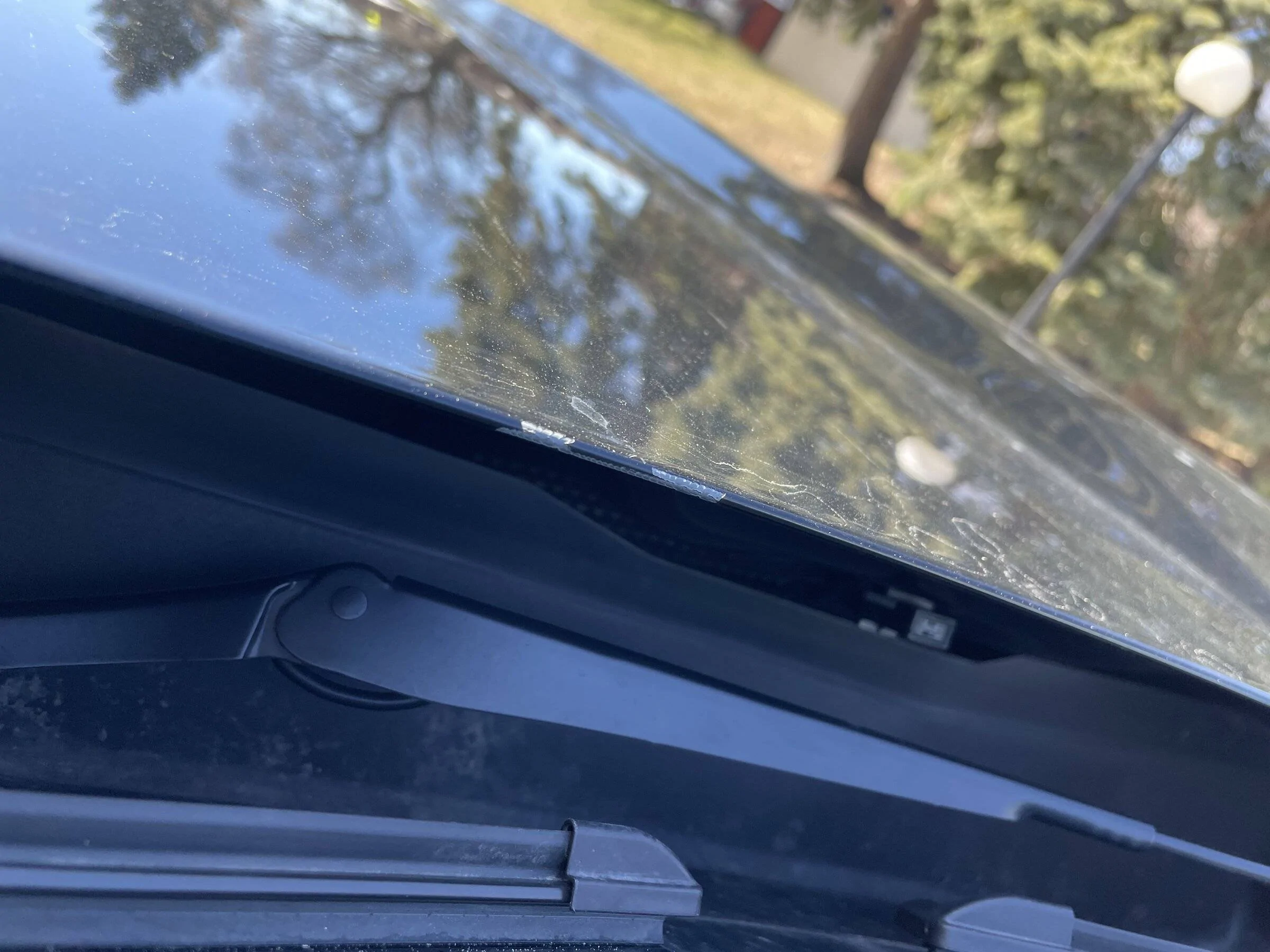

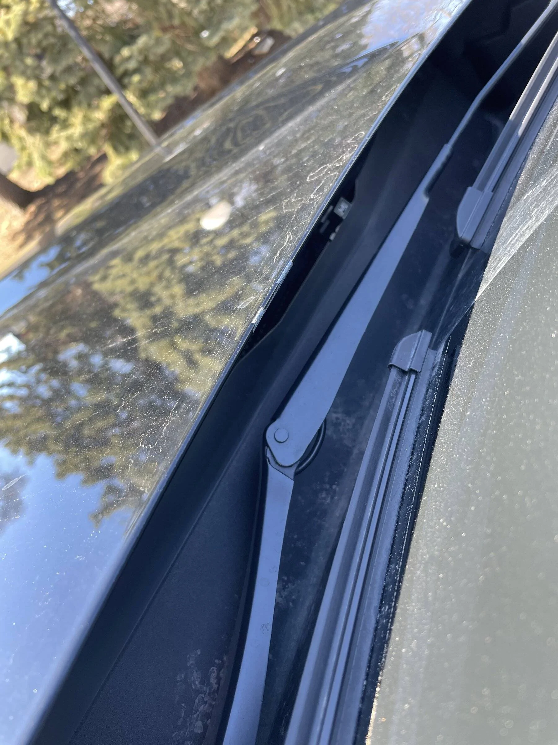

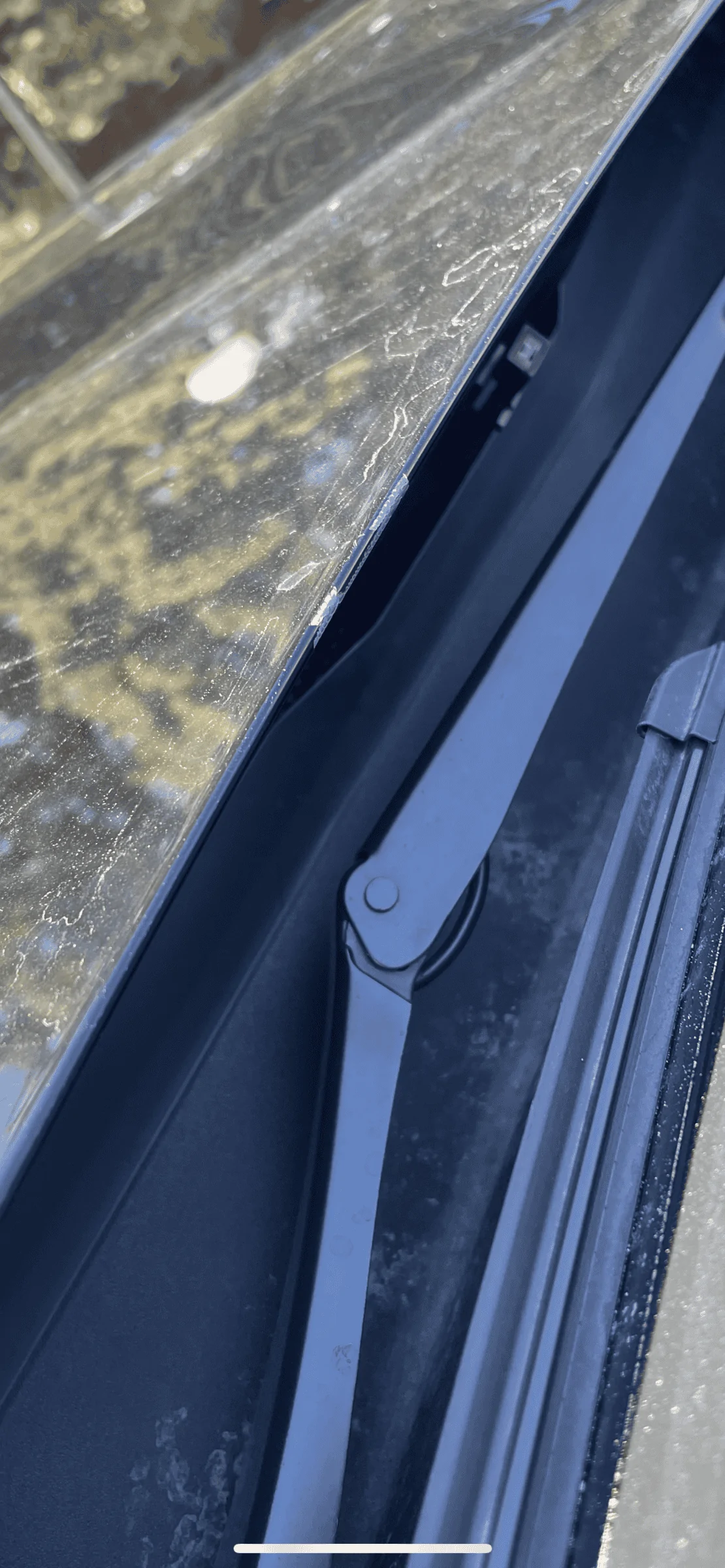

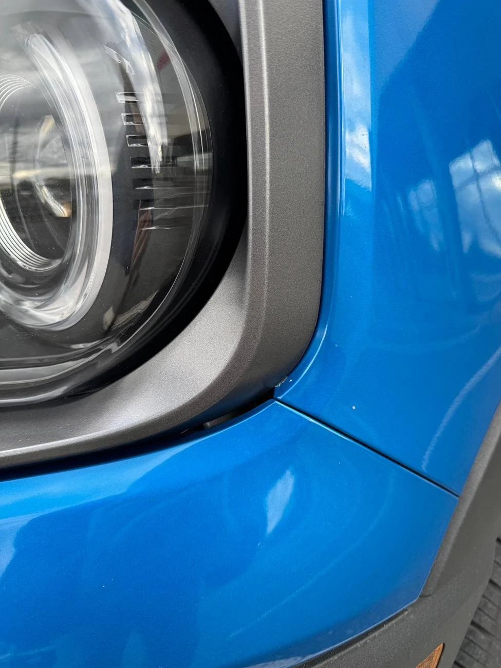

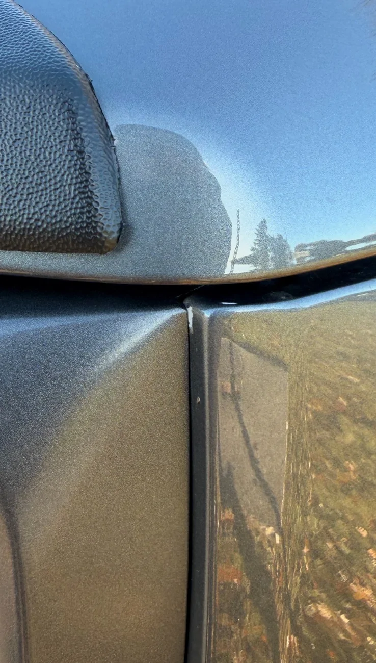

dealer told me today I must have used my snow brush and scrapped along the trim causing the damage I’m having, pathetic service, seriously considering taking a loss and just getting rid of mine. I’ve had 4 big problems in 3 months
Ford Bronco Sport Paint chips 132E373B-60AB-42E6-B7F1-48B036517D7F
Ford Bronco Sport Paint chips 72B7466D-7A89-4A6F-8DEC-1349EB5EDDCC
Ford Bronco Sport Paint chips 7E5BF845-5BD9-4A2A-BF5D-43520264BD74
I had the exact same chips on mine, within 3 months of buying it. There were actually paint marks on the arms of my wiper blades, but the dealer agreed that the wipers would have to be at extremely odd angles and be flexed out pretty far for them to hit the hood, and my chips started before the first snowfall, so they felt the paint on the wiper arms must have come after the chips began and they repainted my whole hood. (I *just* got it back from the paint shop today.)
I also had the chips/scrapes near the front headlights where that weird tab rubs, plus a chip on my tailgate, and one by the taillight. They repainted them all.
- BUT when they reassembled it the tab on the headlight still hits the paint and the brand new paint is already damaged. It literally did not survive reassembly. It was already through the paint by the time I got my Bronco back from the dealer this afternoon.
My collision guy is going to move the grill and put some space so that tab does not hit the paint. Crazy design. I know several other Bronco Sport owners and ALL of them have the same paint rubbing off by the headlights. I am having to pay out of my pocket after Ford refused to do anything.

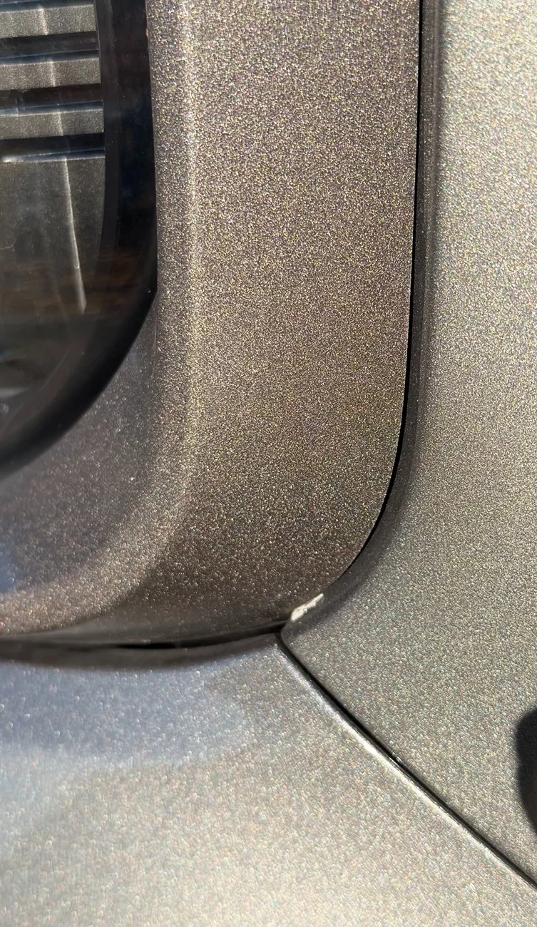

Add my 2022 Big Bend in Area 51 to the list.
28k and headlights are chipping paint just like the photos in the thread. I love this vehicle but this is disheartening. :(

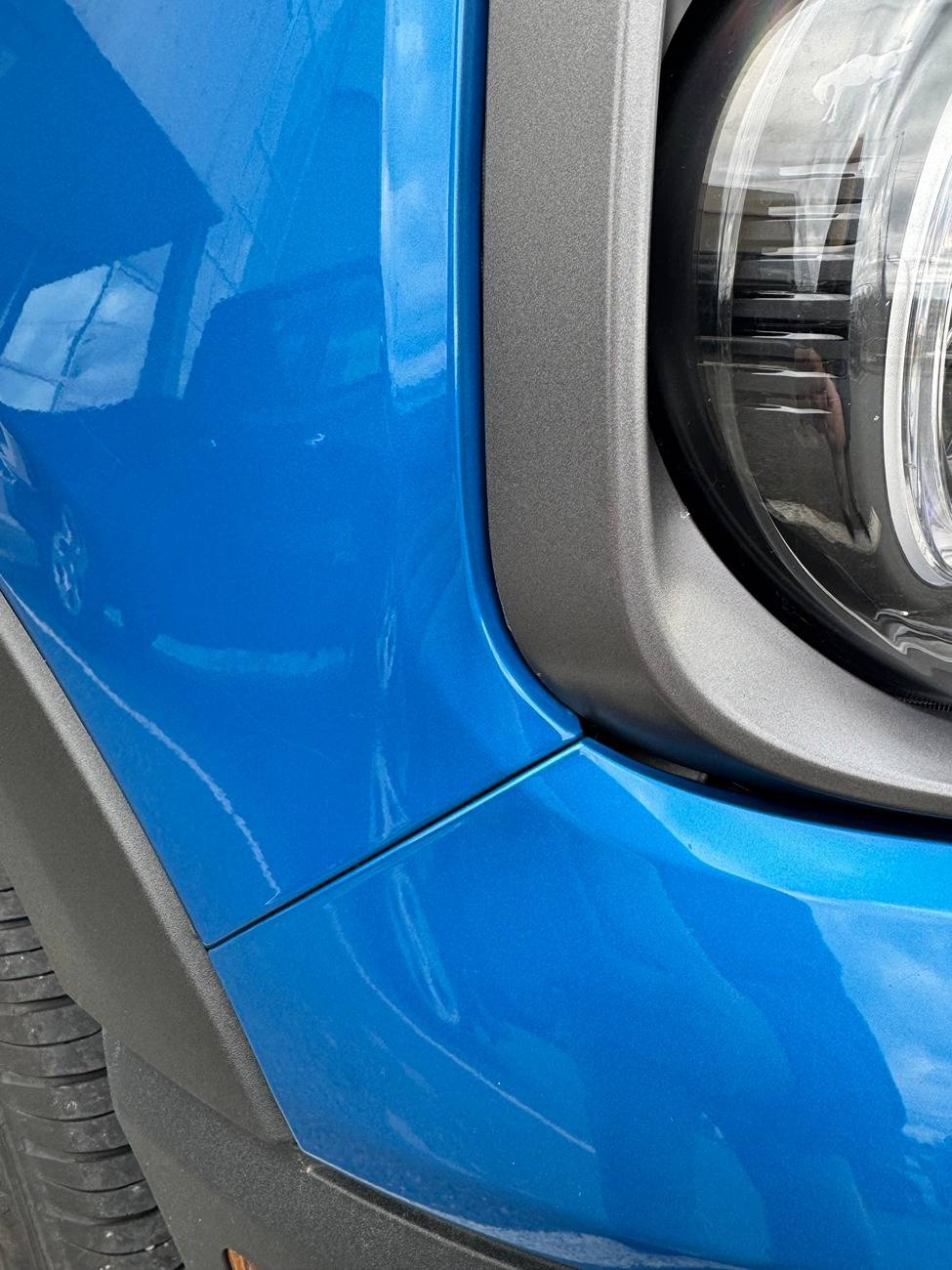

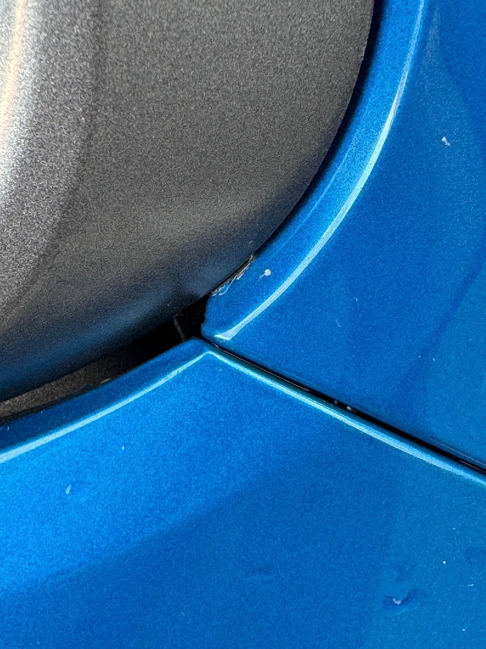

I was overwhelmed with how many other sport owners are reporting this issue, so I figured I would the same. I have a 2022 Bronco Sport Big Bend. Got it brand new in September of 2022 and just noticing some paint chipping around the headlights. Driver side is much worse, but the passenger side is starting to peel and mileage is only 23,000kms. I called my dealer this morning and they told me to come by after work so a Manager and shop foremen can check it out and to troubleshoot/ discuss further action. As you can see, yes there is some chips from road debris for sure, but you can clearly see the damage around the corners is not caused by rocks, etc.. This area is steel, so it will rust and I live up here in Ontario Canada where we see lot's of snow and salty roads. Hoping my dealer can find a resolution as I really enjoy my BS Sport! Other than this, there's no other issues that I found concerning paint chips.
