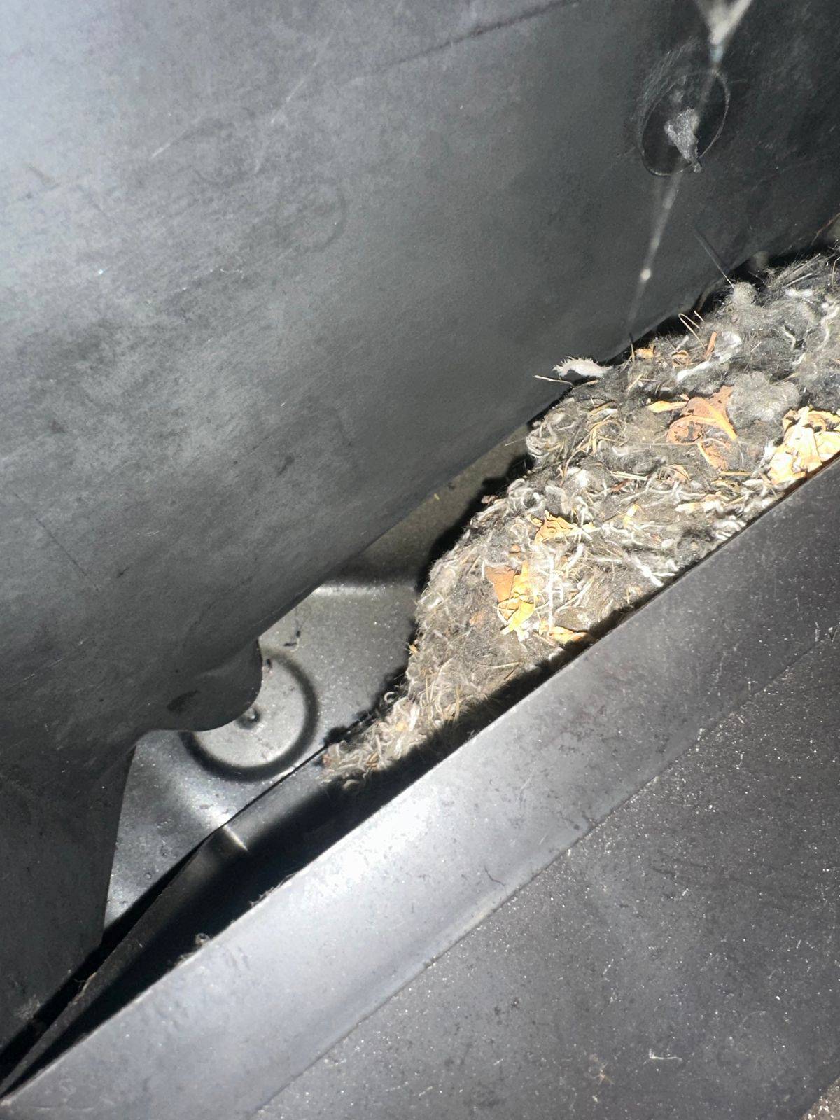

I go 15k miles or so and 10K or so on the cabin filter.
3,525
5,198
3,525
5,198
So you are saying 125k and 18 years is too long on the cabin air filter? Turns out the rodent nest basically replaced the cabin air filter. Here I thought the smell was my shorts all this time!
