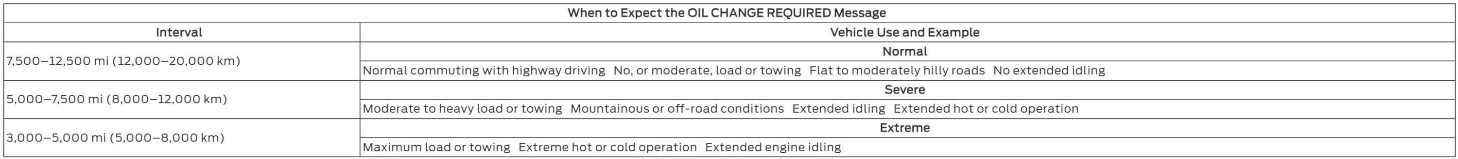

This Bronco Nation article, at best, misunderstands what the owner's manual actually states.
2023 Ford Bronco Sport Owner's Manual
Depending on your operating conditions, you can get up to 12,500 miles on synthetic blend oil no issue...on the most severe side, it could be as little as 3000 under "extreme operating conditions". Ranges are 3k-5K extreme, 5K-7.5K severe, and 7.5K-12.5K normal.
Most people are bad at recognizing that, even if they get groceries and aren't trying to emulate Dale Earnhardt on public streets, that many drivers would fall under severe operating conditions easily. I remember renting cars in the Quad Cities with -15F air temp in the winter and... those are not fun conditions for engines. 15 minute drive, 13.5 minutes in hot air would just start to come out of the vents (and at that temp, idling for engine heat isn't gonna matter... you could idle for 30 minutes and the engine would still be stone cold.) Same time summer days could be 100F+ easily. If you were in the Mediterranean-esque climate of some parts of Socal, sure maybe you'd fall into normal conditions. A person who commutes 30 minutes each work will get that car to temp in cold winters... a person with a 5 minute commute at -15F isn't going to get the engine to temp either day.
The intelligent oil life monitor tracks this. It knows the outside temperature, it knows the engine temp and RPMs. It understands that 200+ highway miles at 2500rpm is easier on the engine than 15 minutes idling at extremely cold ones.
Per a summary on the F-150 Forums:
All of the above. The computer takes all of this information [mileage] along with coolant temp, oil temp, ambient temp, number of driving cycles, how long the engine runs at operating temperature, how long the engine idles etc. It "knows" if you're in stop and go traffic the same way you can see the engine idle hours in the info display. It "knows" when you're are towing when it detects you have plugged a trailer into the smart connector.
IMO I trust the IOLM up to 10K miles (which usually isn't my oil change factor, which is 10K miles/1 calendar year/IOLM tells me to do it sooner). The only area I don't trust the IOLM is to accurately count 12 months, but otherwise the IOLM sees all operation and operating environment factors of the car while the engine is started.
Generally my oil changes in 2015 Ford Fusion Titanium (2.0L ecoboost) were dictated by time... but one time I had the IOLM drop from 45% to 2% with just 5200 miles on full synthetic. I went to valvoline and had them change the oil.
I also do periodically check the dipstick to see if the oil level is OK, oil doesn't look grimy (darker is normal over time) and doesn't smell burnt separately from the IOLM, but heeding that in Ford vehicles that have had that, I've never had a problem.
