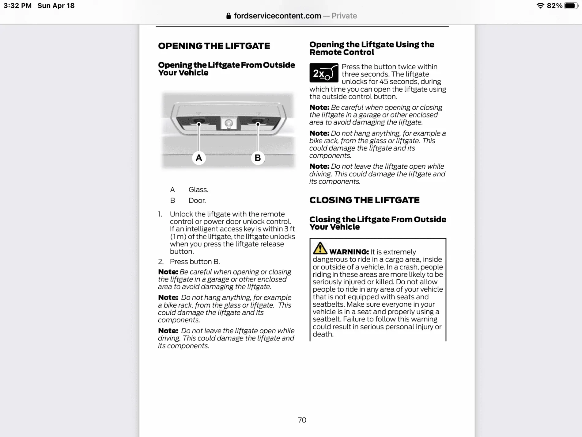

Hey everyone, a friend of mine has a Bronco Sport and I can confirm that you can open and unlock the rear hatch door with the keyless entry Fob in your pocket. This is from the Canadian Bronco Sport Owners Manual.
Ford Bronco Sport Keyless entry on all doors? D175AFBE-2E76-4416-9330-F1F41C2BD1F2
