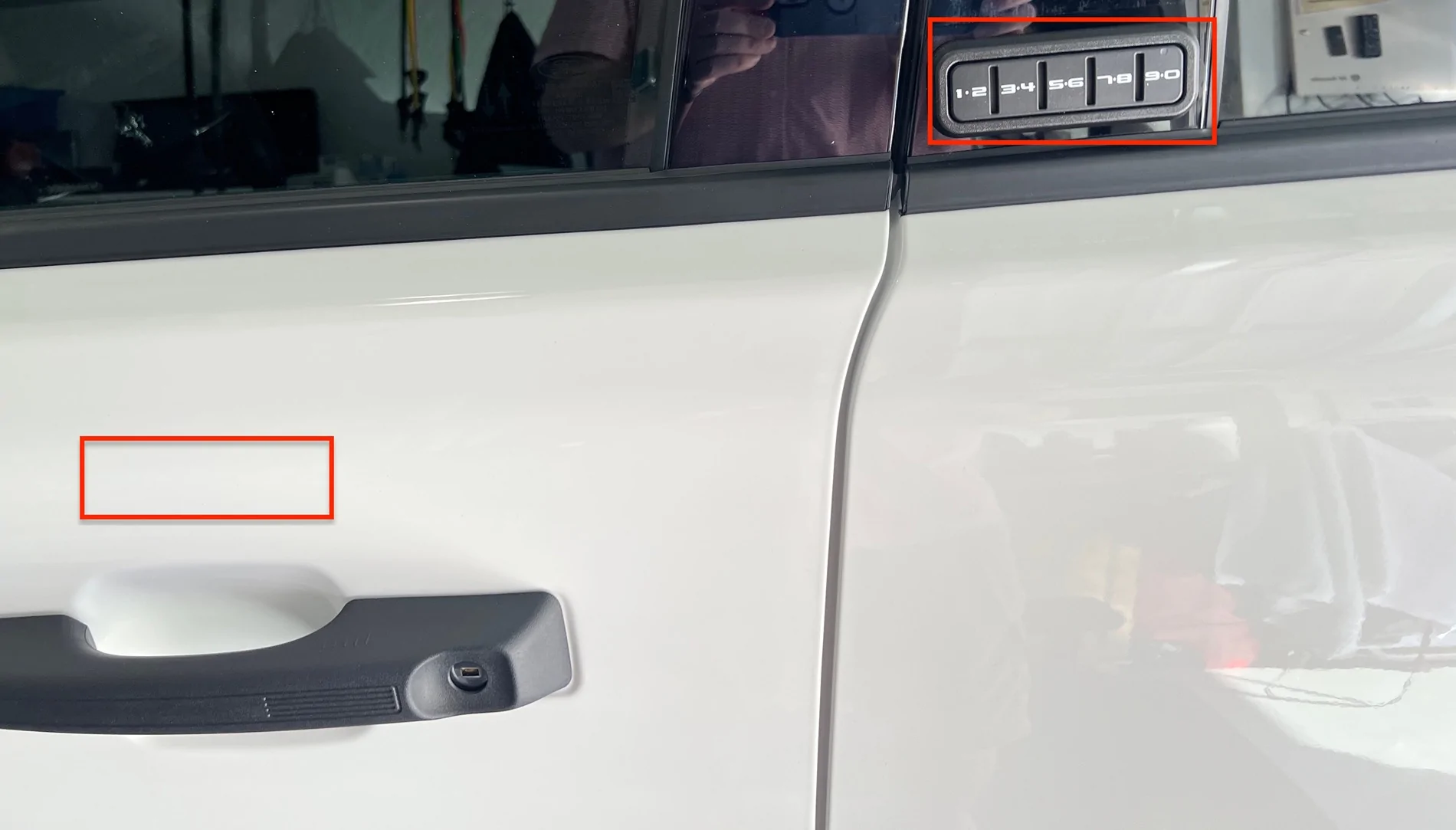

If it was me I'd stick it on the door probably, but the next place would be as you mentioned on the inside of the fuel door. I don't see any other place as a nice option to be honest. I use mine everyday so I'd want it super easy to access. Hiding it somewhere else would defeat it's purpose IMO.

Kind of like the side of the roof rail over the driver’s door it it would fit there. Same orientation as on the door but “black-on-black” would make it a little less obtrusive.

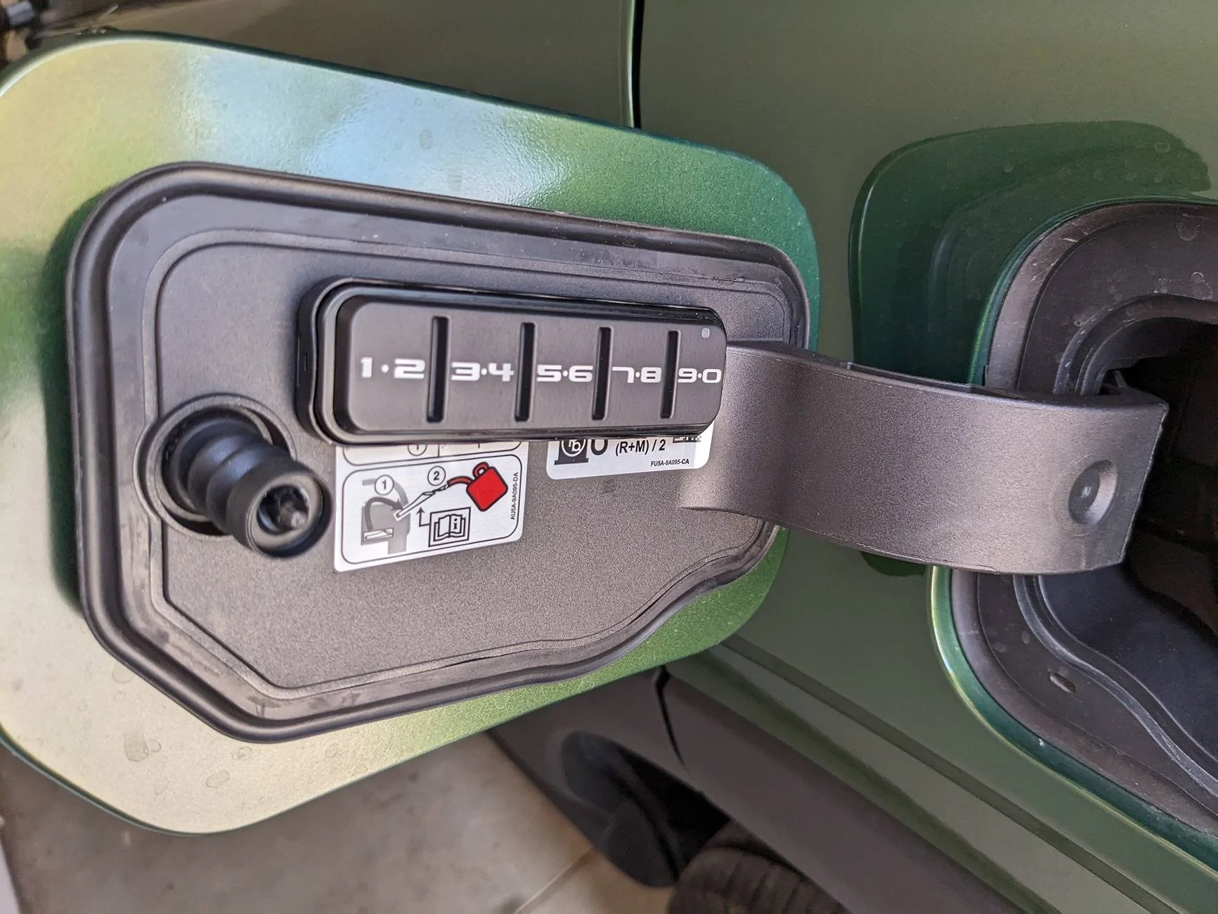

I just ended up putting it in the fuel door. The exterior snap-on bracket that surrounds the keypad makes the unit too large to fit and still properly latch (needs to be a small distance from the circle surrounding the peg because there is a larger piece that mates on the vehicle side), but because it's out of sight and semi-protected from the weather, I don't think it will matter.

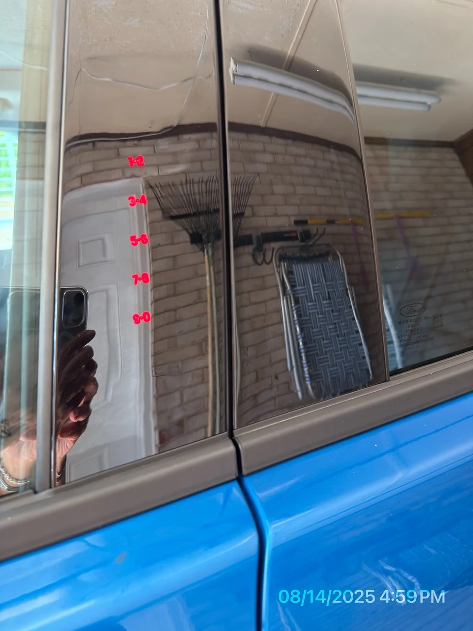

I ended up putting it on the rear door b-pillar vs the traditional location above the door handle. The drivers door b-pillar was not wide enough.

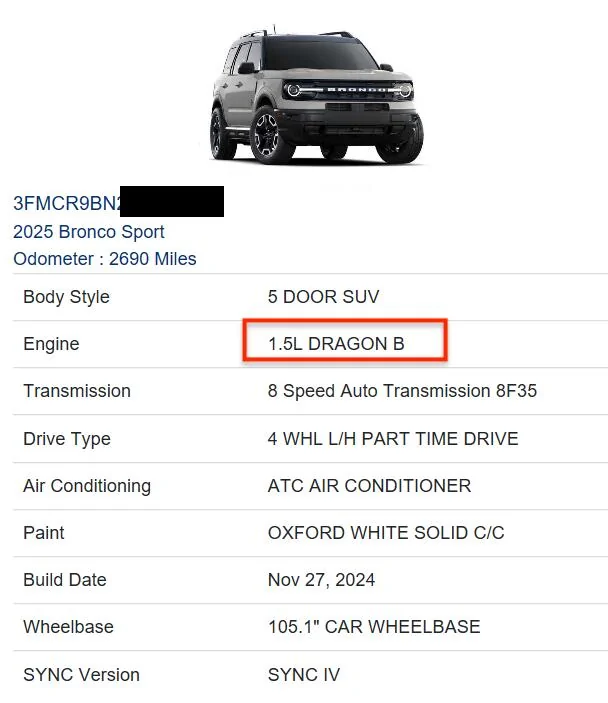

Also noticed the '25 BS new MPC engine is listed as a "Dragon B." I assume "Dragon" or "Dragon A" is the prior generation engine. I wonder if Ford is not promoting the all new MPC engine, as it might be considered an admission the older Dragon engines have problems. Based on everything I've read, my build does not include the GPF, which was introduced Job 3, June 2025.
