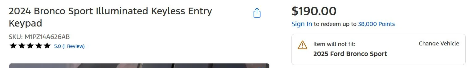

Ford still offers the Illuminated Keyless Entry Pad. You have to purchase it through the Ford website as an aftermarket add on.
https://www.ford.com/product/illuminated-keyless-entry-keypad-p2864816536
If you have it installed it is about $300 for part and labor. If you have Ford points it is a nice option to use those on. I have had this installed on both of my Bronco Sports. Picture on the website is a little deceiving. Numbers are actually red not blue. Well worth it and it is more streamlined than the box option they provide.

Do you have a 2025 model? It is listed is not compatible with the 2025 model on the website. Though that would be an absolutely preferrable option, I imagine that the internal wiring was deleted. You have to take the entire door apart including removing the glass to check, so I am not going to go through the hassle unless I hear from someone that they actually have it on their 2025.

Ah, sorry I don't. 2024 model. That would be such a bummer if they stopped it for the 2025. Maybe someone at a local Ford dealer would know? I guessing since they have those features on the FordPass app they might be phasing it out.

I have noticed a number of differences in the '25 wiring from '21-'24. I suspect the pigtail in the LHS door was deleted for '25, thus eliminating ability to install a '21-'24 b-pillar illuminated keypad.
The following link lists the Ford models, years, frequencies, and keypad part numbers.
https://www.fordservicecontent.com/Ford_Content/Catalog/accessory_files/Wireless_Keypad_Usag_Matrix_Rev_1.pdf
I haven't read someone successfully programming it with FORScan.
I think you either need the dealer to program it, or buy FDRS license and compatible OBD dongle.
