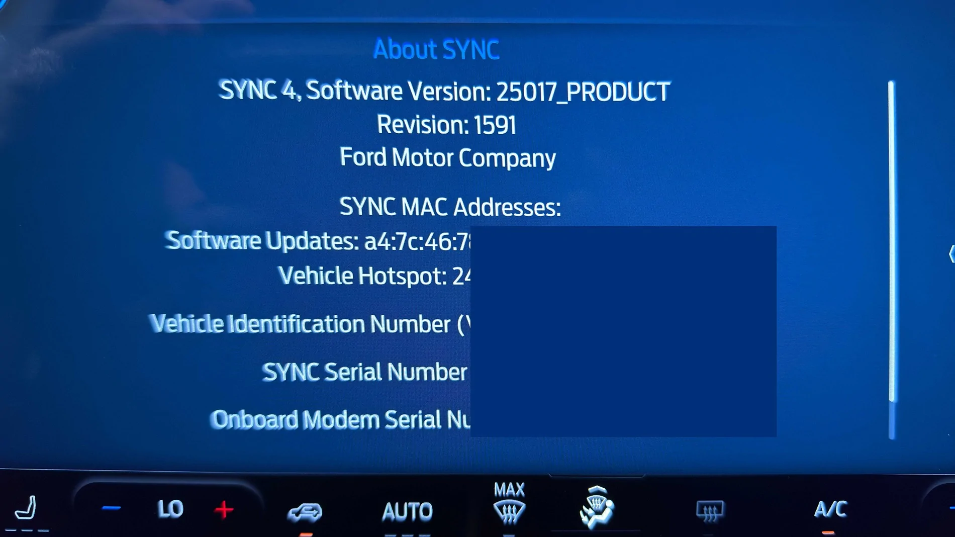

I just bought a used 2025 BL. My Sync 4 version is 24242.
Revision 1356.
I have auto update turned on and when I check, it shows no updates available.
Is this the latest version ?

Ford Bronco Sport Issue with CarPlay IMG_4195
