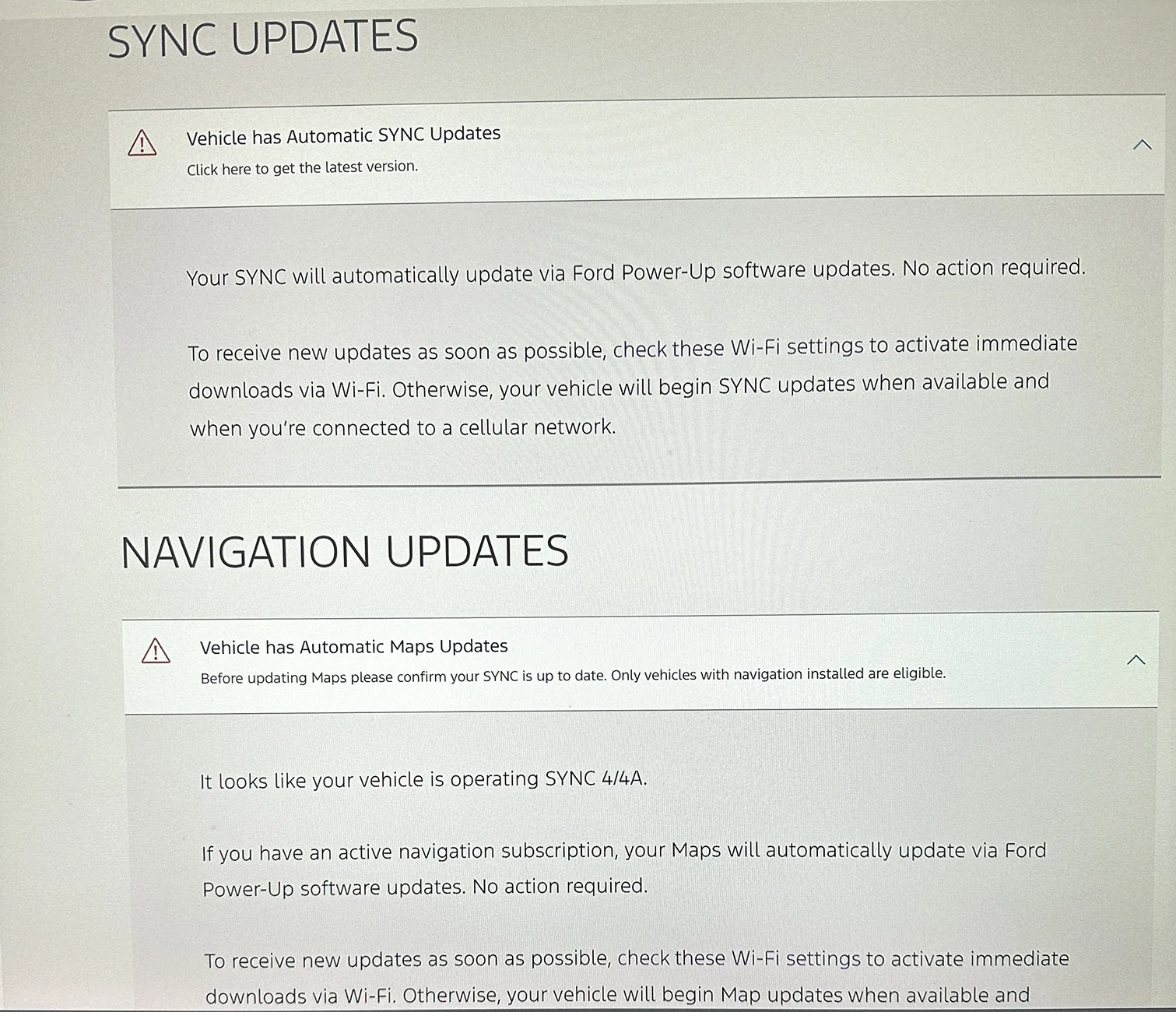

Here's what I got inputting my Vin #. I doesn't say for sure if I have an update needed. But looking at the photo from dwrufus53 his version is probably newer than what I have.
Ford Bronco Sport Issue with CarPlay IMG_7681
What happens when you click on “click here to get latest version” and is there anything useful in this section: check these Wi-Fi settings to activate immediate download via WiFi?

It just says it will automatically update. I connected to my wi-fi network yesterday. I assume I need to login only once and it will connect when in range.
I have the wi-fi symbol in the upper right corner of the screen.
