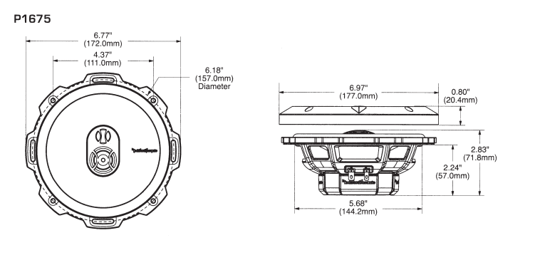

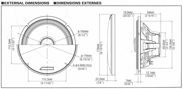

I do, Ill check it out today if possible. The thing is they are built into some like plastic frames as op pictured. If I remember the openings have a little bit of wiggle room. We know the alpines went in, maybe check the dimensions of that model for comparison?
Thanks Forty. Here's the same drawing for the Alpines:
Ford Bronco Sport Installing aftermarket speakers and sub in Bronco Sport! Alpine R-S65 2 Dimensions
They don't provide the diameter from the mounting points, but the diameter of the speaker cage (the part of the speaker that would actually go into the hole on the door) is about 7.7mm larger on the Rockford Fosgates. Not sure how much wiggle room there is in the hole.
Edit: Adding diagram of the RFs for easy comparison.
Ford Bronco Sport Installing aftermarket speakers and sub in Bronco Sport! RF P1675 Technical Drawing.PNG

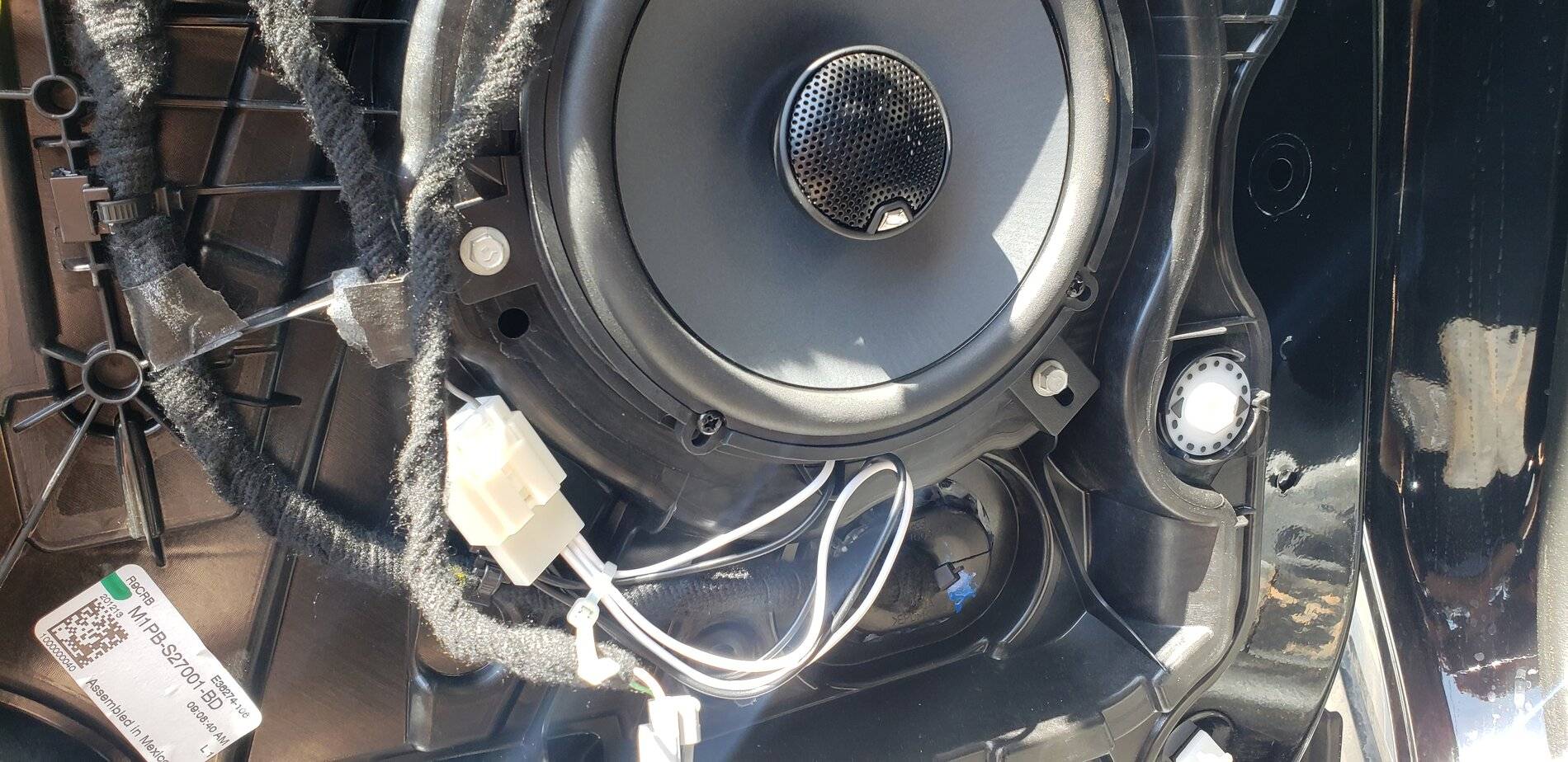

First of all, thanks to the previous posters for all useful information. It made life so much easier. I am adding a bit to the knowledge base.
I just installed JBL GTO 629 in the front and rear door speakers. I used the Metra brackets that the OP suggested in the front while drilling a 1/2" hole in the side to run the wires through. I used Metra adapter cables 72-5602 so I wouldn't have to splice.
Tools needed
5/16 socket and extension for the door handle screw
9/32 for screw behind the reflector, lower panel, and speaker mounts
10mm for screws behind the control panels
I just used my hands to pop the panels but a thin plastic pry would probably help.
Zip ties and end snips for securing cables
Drill and bits for modifying the front metra adapter. I also used a coping saw.
A screw driver with a ph2 for attaching the speakers to the rear JBL brackets (ymmv).
A magnet for when the reflector screw almost drops into the panel and you don't want to pull the panel. Or some tape to temporarily cover the holes behind the reflector.
I did not have to drill anything for the rear speakers as I was able to sneak the cables through the mount plate. (Photo attached)
When putting the door panels back on, ensure the latch and lock connector are rigged correctly, also feed the window control cable out the panel to make your life easier.
I hope this helps. I took some video of the install and may post that later.
