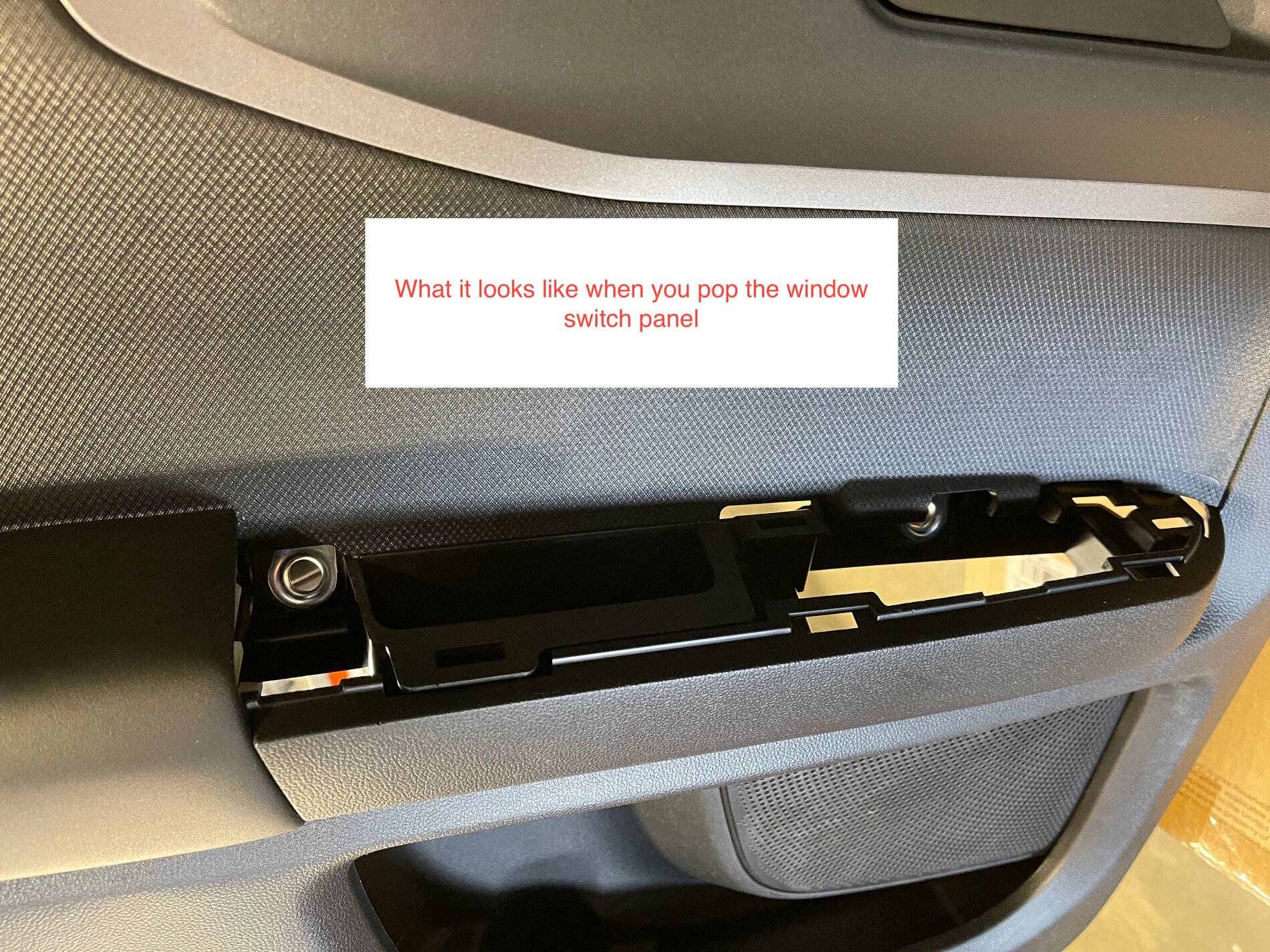

Do it! It's pretty easy to do yourself, and aftermarket speakers are a much more cost effective way to upgrade your car's audio. WAY cheaper and better than the factory "upgrade." A set of $100 speakers can easily provide a HUGE improvement in sound.
If you're going to DIY I highly recommend getting a set of trim panel tools, like these:
https://www.crutchfield.com/p_126CR3NGL/Bojo-Trim-Panel-Tools.html?tp=990
They're cheap, and will make removing the door panels much easier.

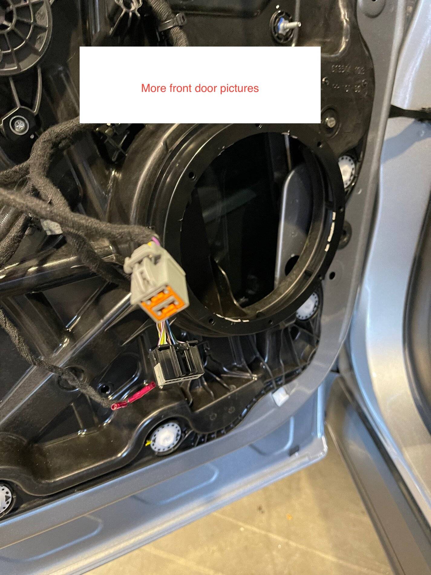

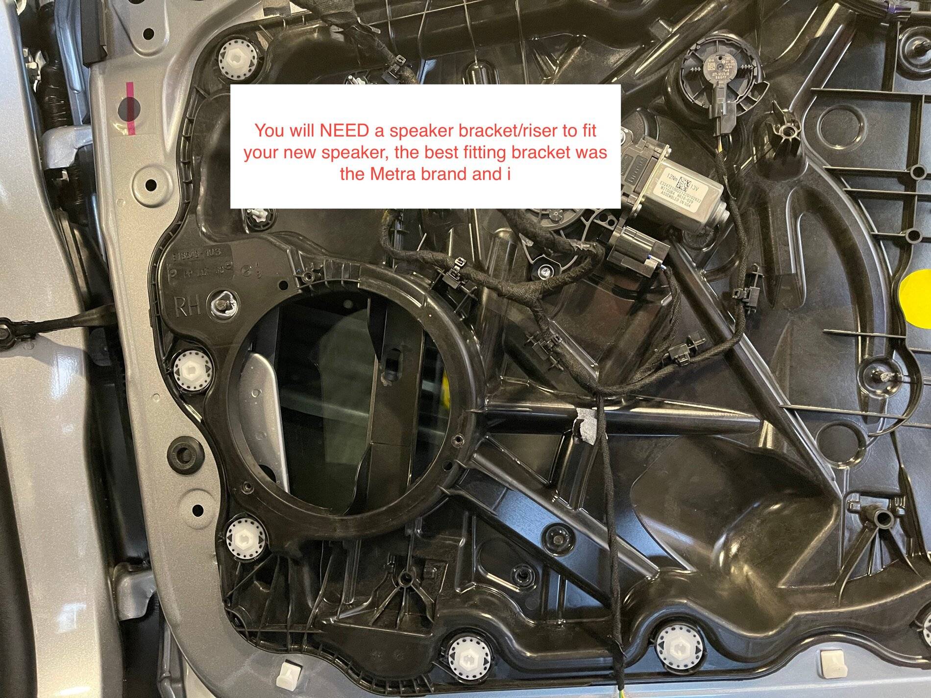

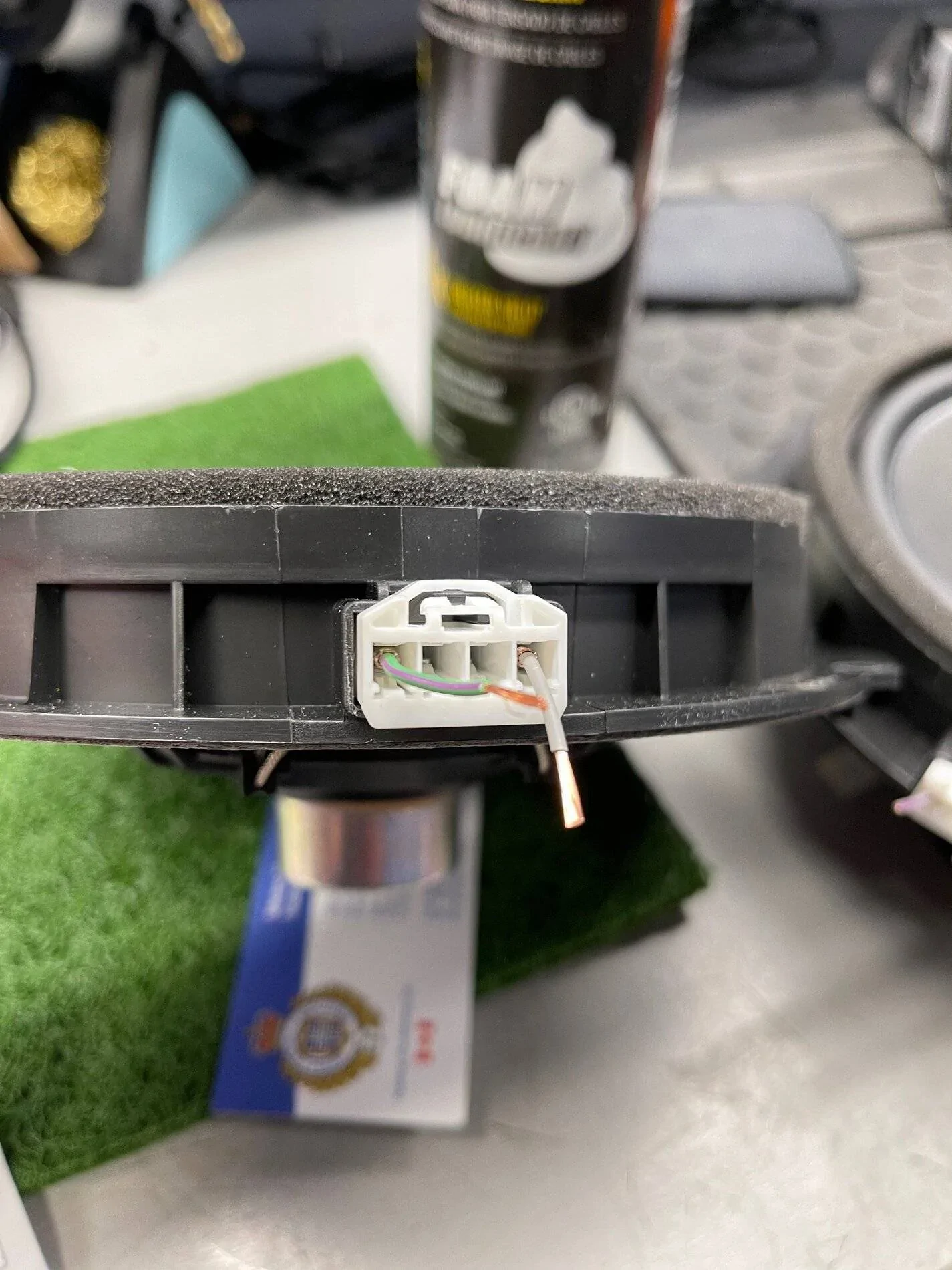

Edit: Can Confirm! These are the correct adapters for both the Front and Rear speakers in the doors. You do need speaker adapters for both the front a rear. http://metraonline.com/part/82-5605
FYI. This should be the speaker adapters and harnesses for the front. (1 pair of adapters and 1 pair of speaker harnesses)
https://www.bestbuy.com/site/metra-combo-speaker-mounting-kit-for-select-ford-2011-2020-vehicles-black/6438740.p?skuId=6438740
Solo Speaker Harnesses
https://www.bestbuy.com/site/metra-speaker-wire-harness-for-select-ford-and-mazda-vehicles-black/5948155.p?skuId=5948155

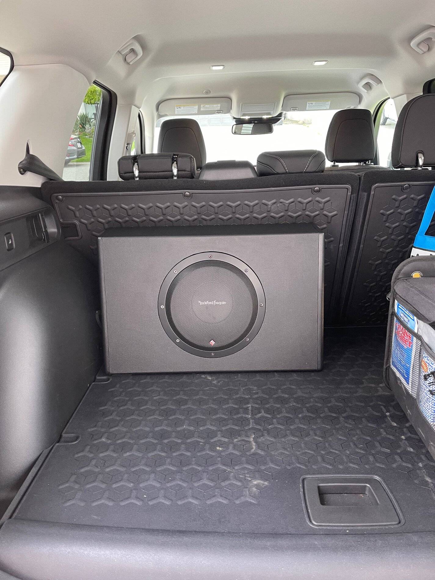

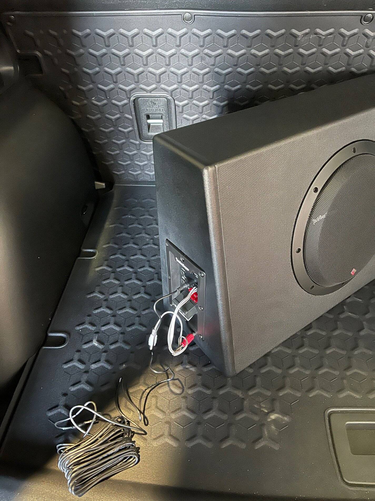

I secured mine in the cargo area with two strips of 2" wide velcro, and it holds quite well. I have to use both hands and my weight to pull it off.
Ford Bronco Sport Installing aftermarket speakers and sub in Bronco Sport! IMG_20210625_080423413
What did you use for the audio line in for the amp? I assume a converter off the rear speaker but which kind if you don't mind. Thanks.
I tapped into the driver side rear speaker input wire, and connected it to the high input harness that came with the amp. Powering the amp was easy as there is a wire harness near the spare tire, the thickest wire in the harness energizes when the ignition is turned to on.

What color wire did you tap into on the driver side? Also, you didn’t have to run a power wire to the battery? You just tapped into the thickest wire near the spare? Thanks for the help - never installed a sub, and am looking to DIY.

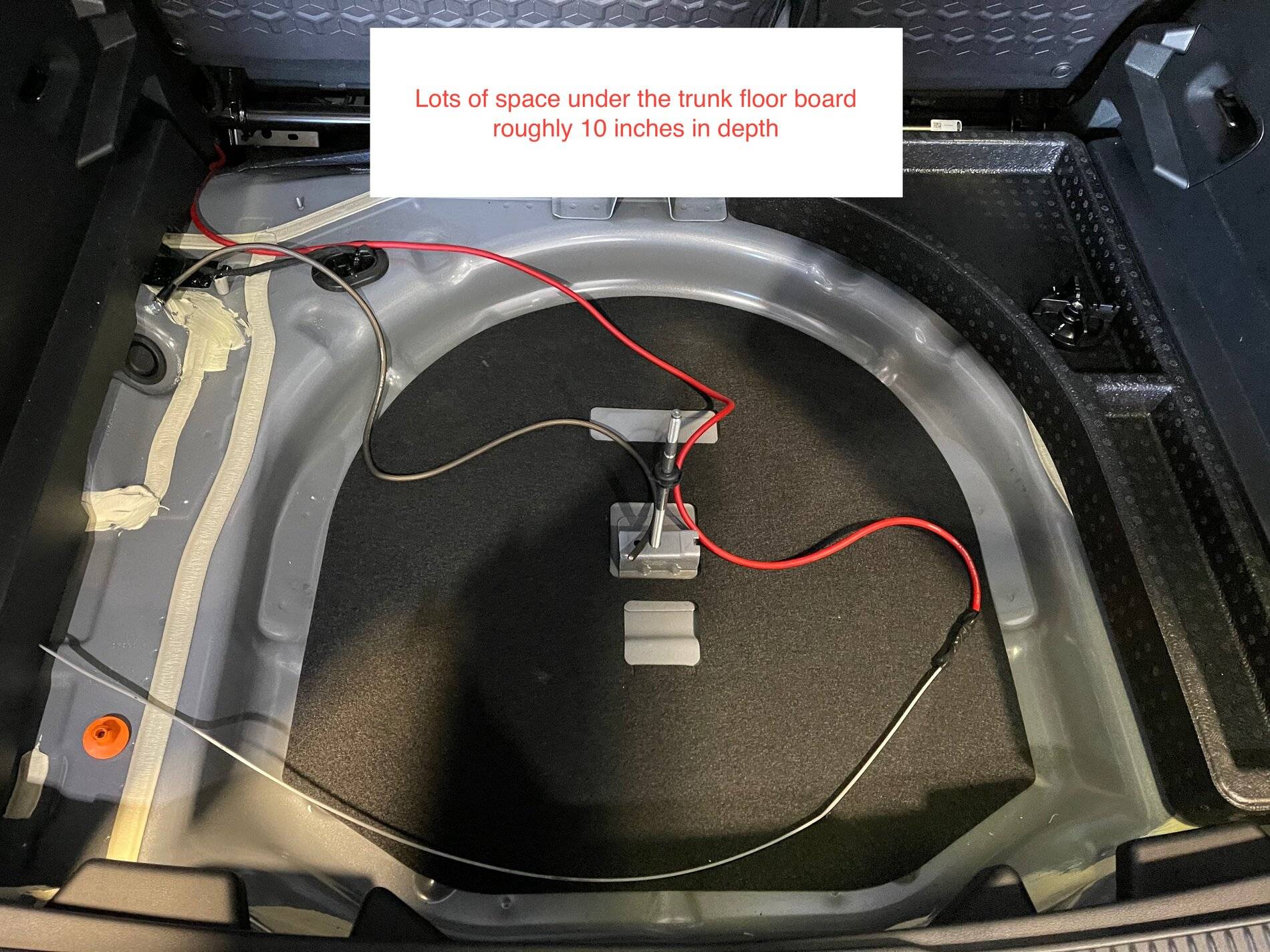

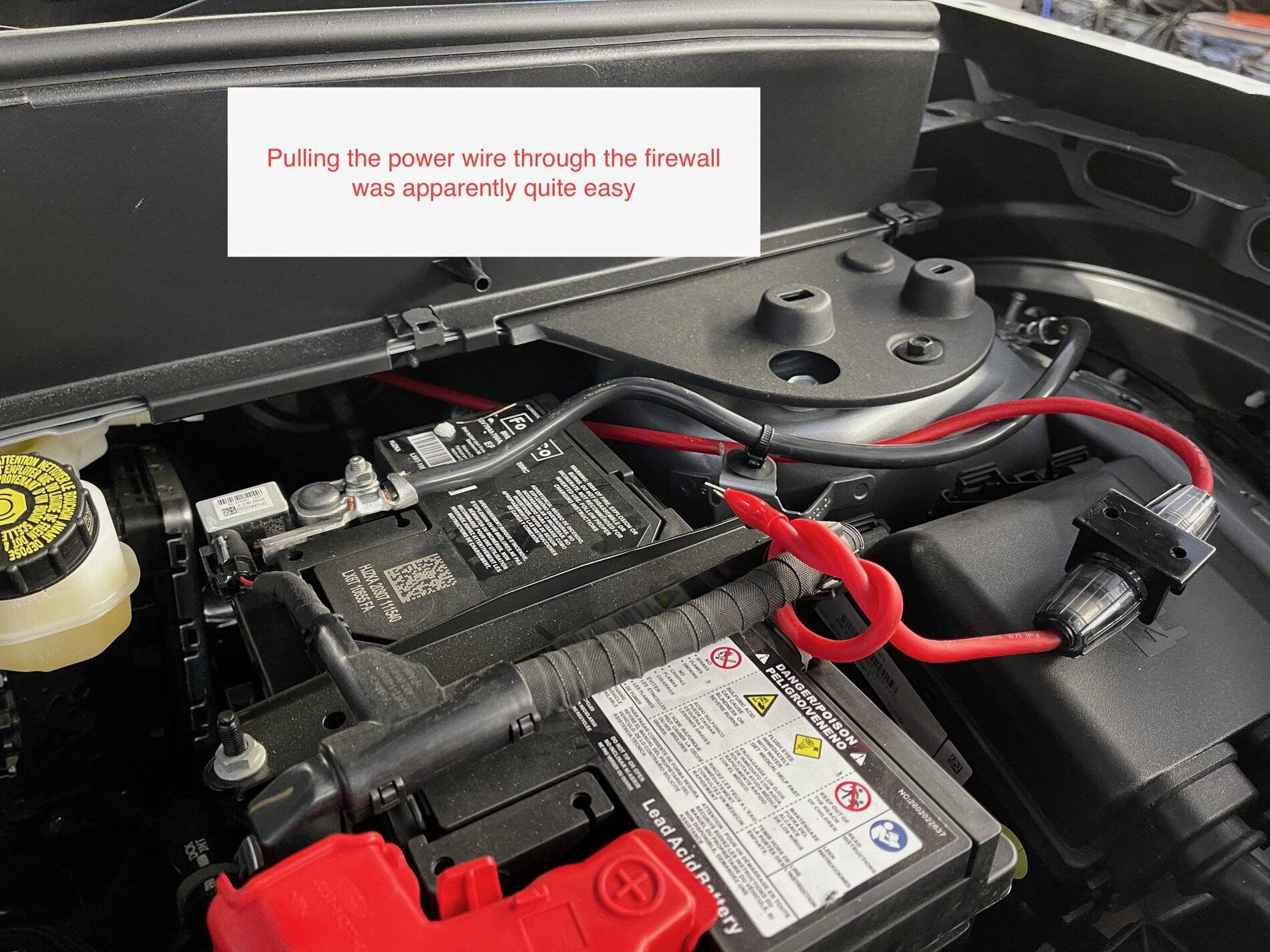

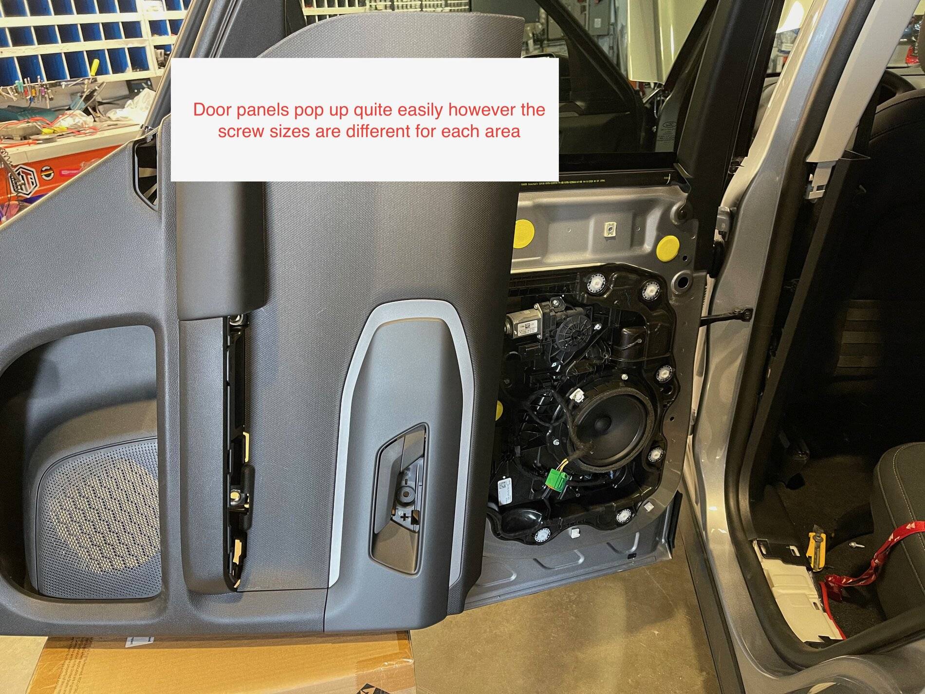

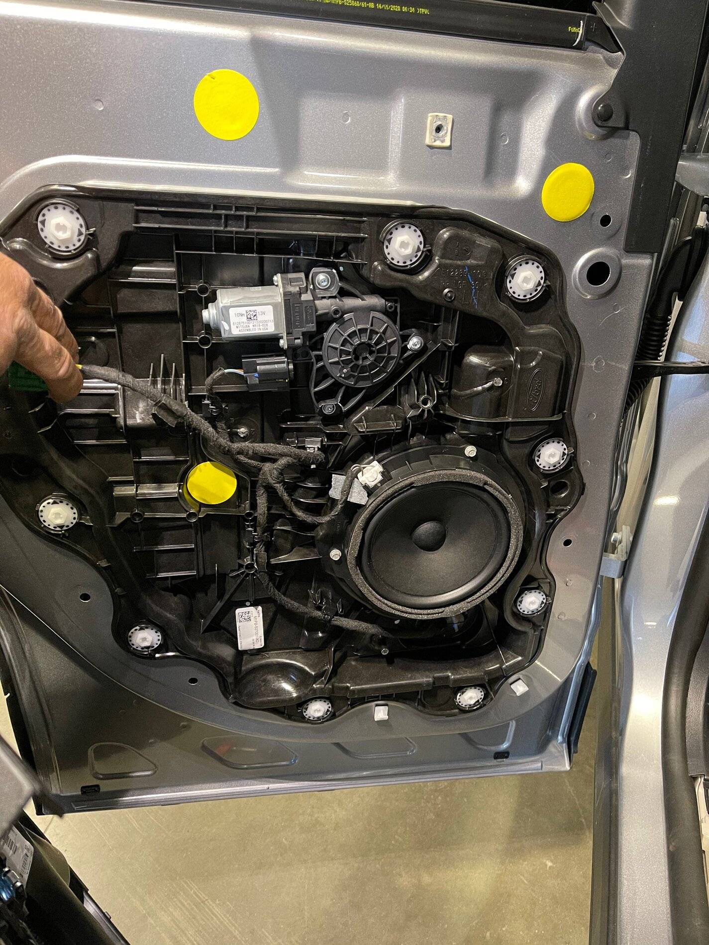

Correction, I did have to run wire from the Battery to the sub, the thick wire from the harness near the spare tire, I tapped into it to power the remote terminal on the sub, since that was a switched power source. As wired, the sub only comes on when the ignition switch is on or the engine is running. I'm sure there are more efficient ways of wiring the sub, I just didn't have the nerve to go tearing into my dash to get behind the radio and use the RCA connectors on the radio. I don't remember the color of the wire I taped into for signal, I remember identifying the positive terminal on the speaker, and following the cable into the wiring bundle coming out of the door pillar. I remember they were Dual colored wires very hard to distinguish one from the other when it joined the door harness. Had to use a multimeter and run a continuity test to make sure I was tapping the right cable. Running cables under the interior trimmings is fairly easy, they pop up without much trouble, the door panels on the other hand scared me to death, they pop with such a loud and nerve wracking noise, you swear you broke something. Here are some pictures from another fellow member who had his done by a shop.

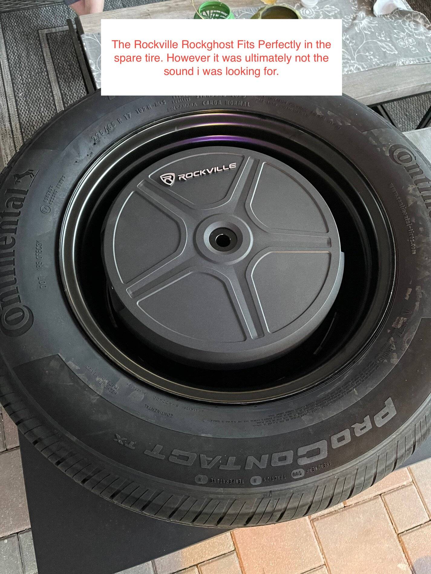

@jlmazzola did you strap in your woofer or does it stay put without it?
So so sorry I didn’t respond sooner, I originally put heavy duty double sided Velcro under the sub and it stuck perfectly on the trunk liner. BUT eventually I wanted more trunk space so I took out the spare tire and the sub fit perfectly in the spare tire area.

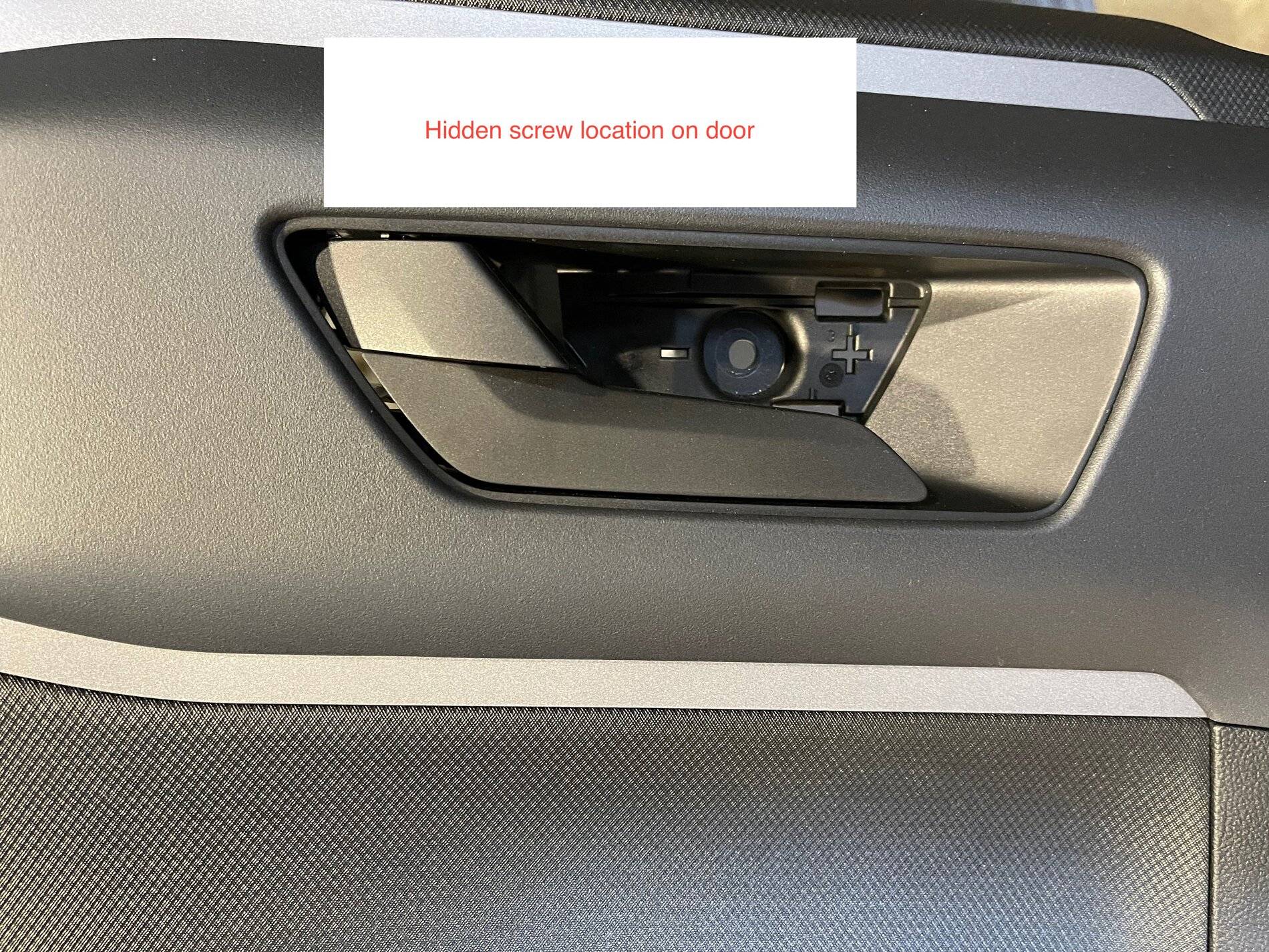

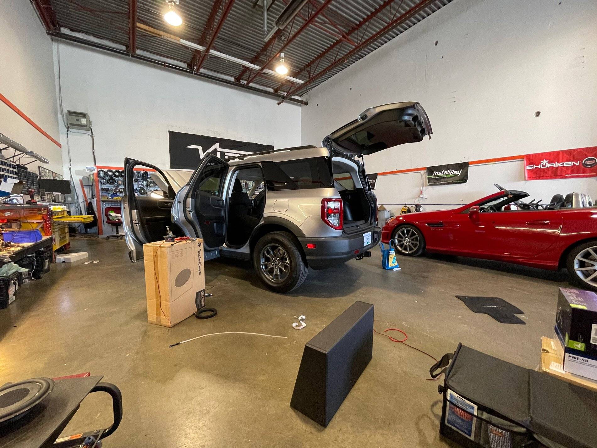

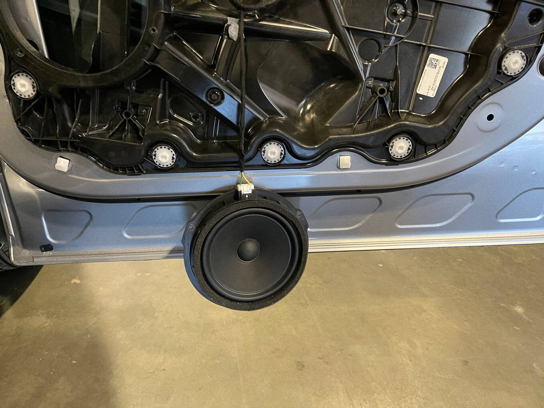

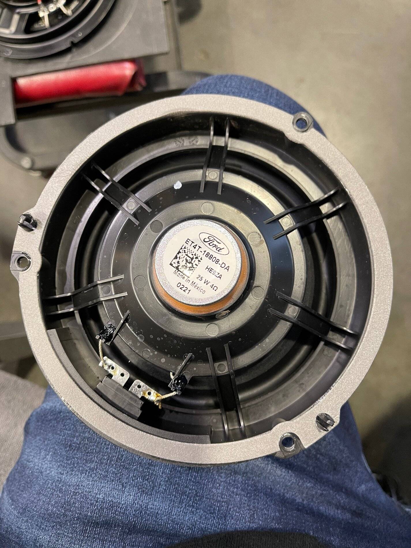

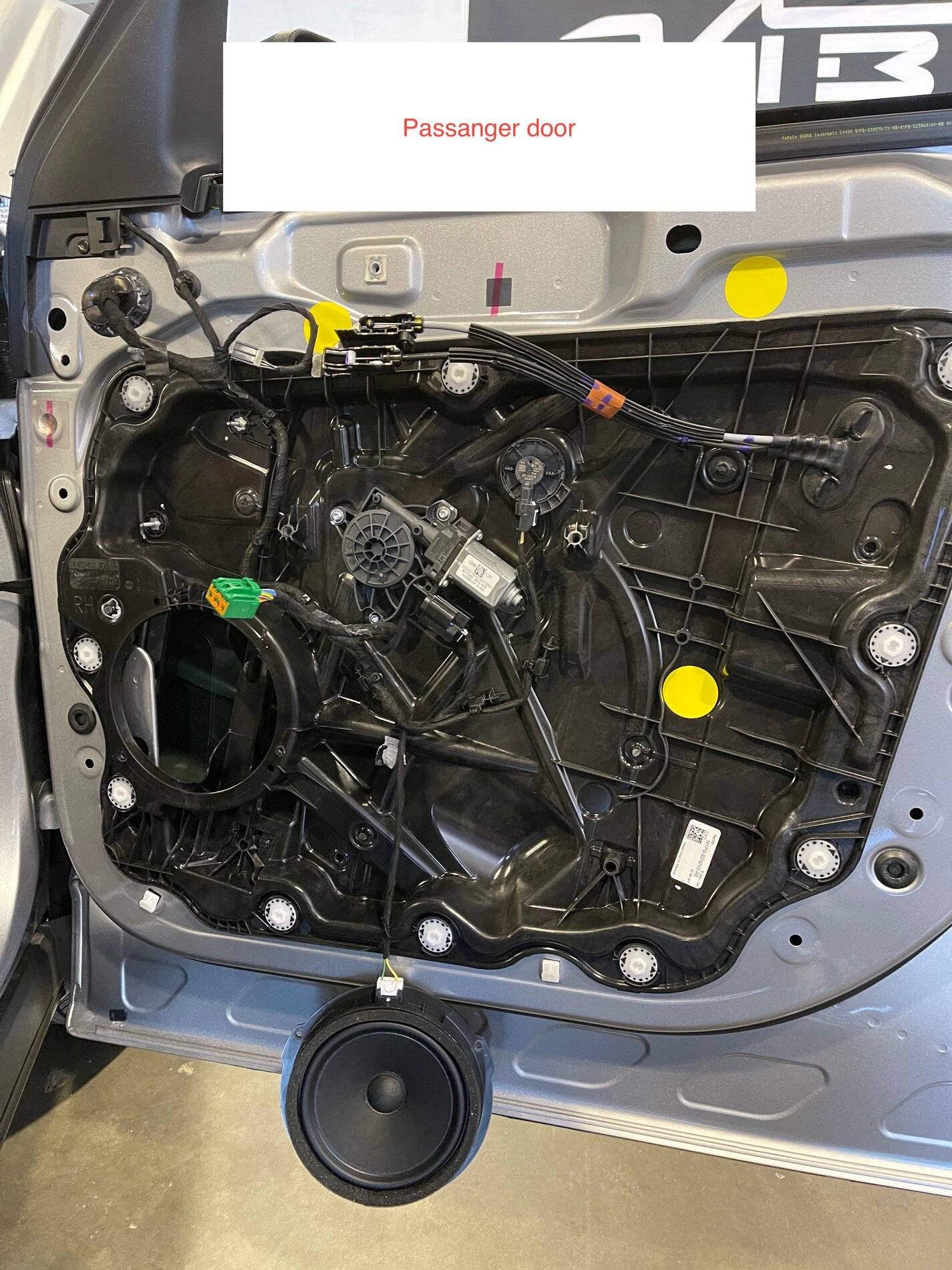

I haven’t seen any usefull info on this subject, so im going to have my baby bronco go under the knife professionally later today and upload photos of the job & will try to provide as much detail as possible. FYI I have the Bronco Sport Big Bend (6 Speaker),
*UPDATE* Pictures Below!

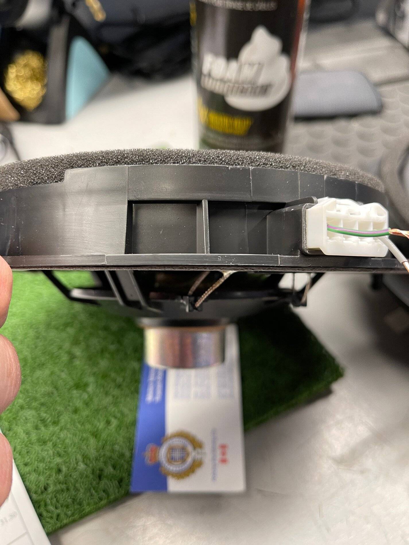

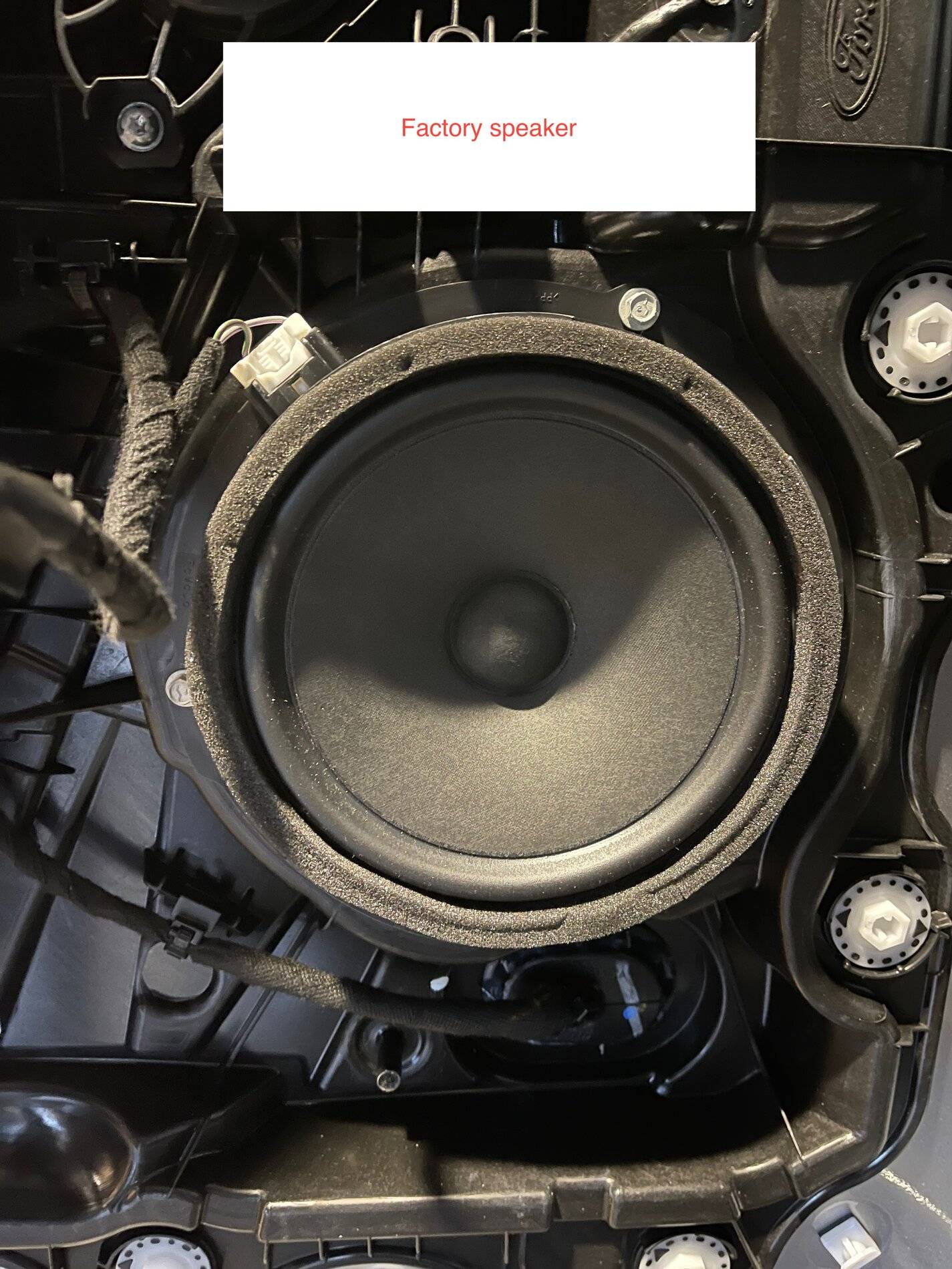

I picked up some Alpine 6.5 Type S's and honestly was disappointed with the mid bass. I worked at Best Buy as a car audio installer and I found it odd how hollow these sounded in the Bronco Sport.
I ended up trying Pioneer D series instead. The frequency response was so much better and the md bass sounds great.

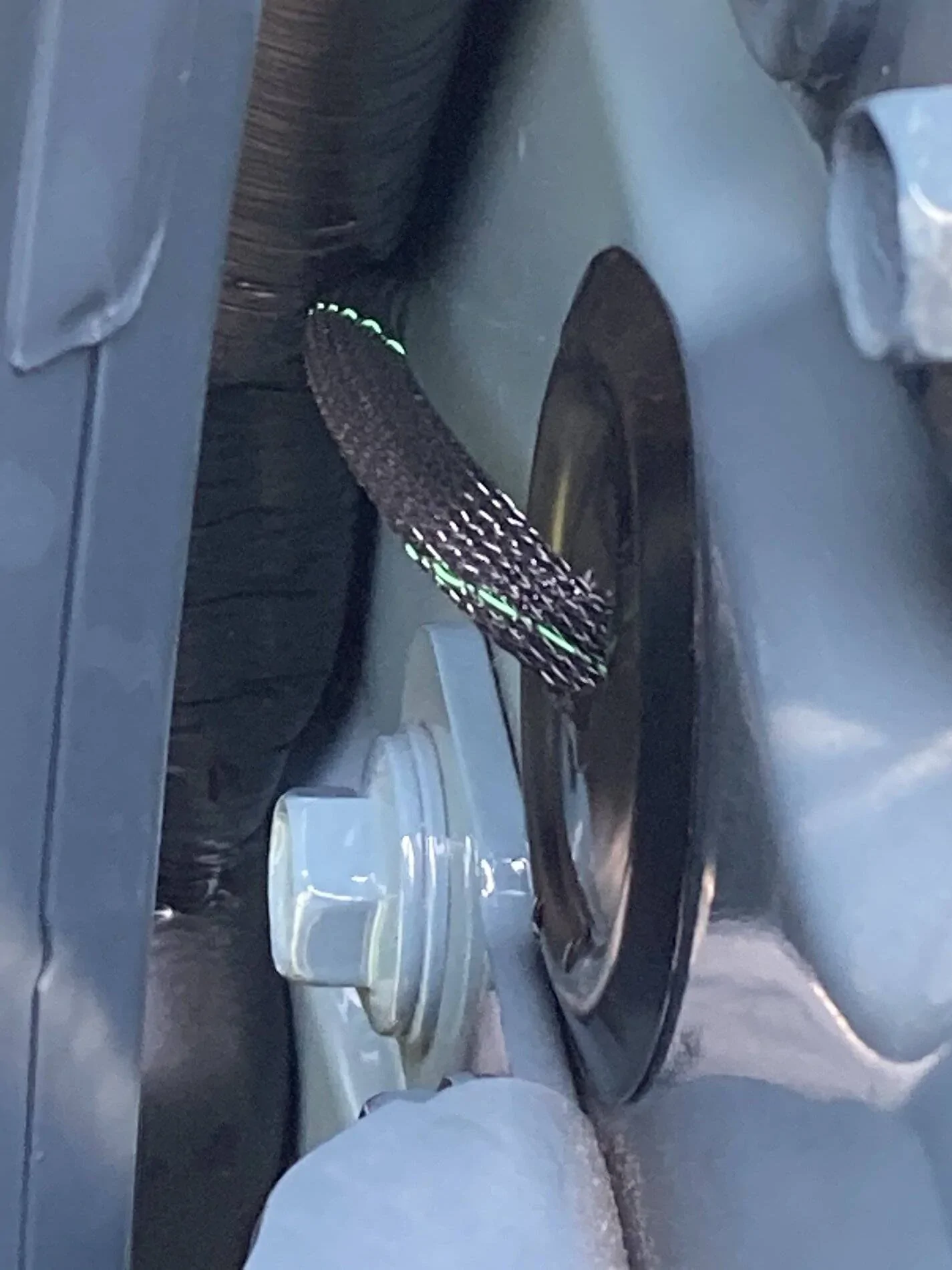

Super easy spot to gain access from engine bay to inside for wiring. The big open spot on the driver side fender well leads right to this grommet above door hinge Runs right behind dash and pretty clear shot right on through to the floor
