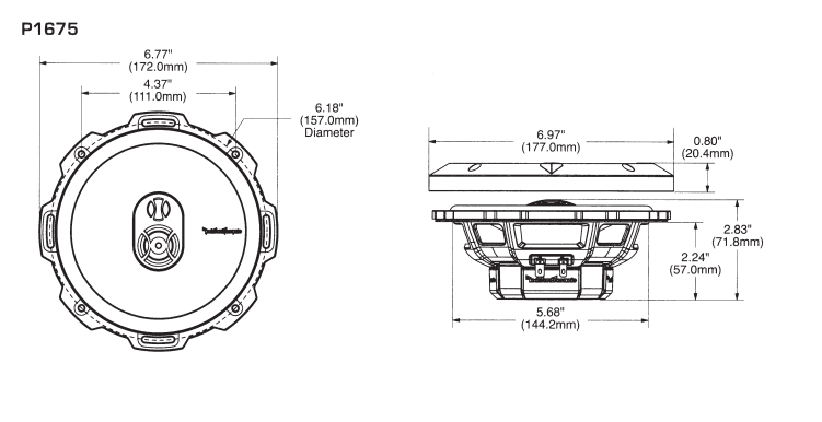

Hey @jlmazzola or @forty do you happen to still have the original speakers? If so would you mind just measuring the diameter of the speaker? The rim with the mounting holes. I'm considering putting in a set of 6 3/4" Rockford Fosgate coaxials (Rockford Fosgate P1675 for those that are curious) but don't know if they will fit.
I don't know if this will help, but here's the technical drawing with measurements for the speakers:
Ford Bronco Sport Installing aftermarket speakers and sub in Bronco Sport! RF P1675 Technical Drawing.PNG
forty
May 1, 2021
I do, Ill check it out today if possible. The thing is they are built into some like plastic frames as op pictured. If I remember the openings have a little bit of wiggle room. We know the alpines went in, maybe check the dimensions of that model for comparison?
