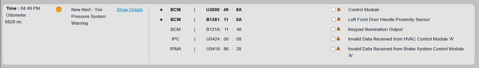

On 10/1, the truck reported these codes. Only the top two are active faults; the rest are stored codes than can be ignored. The U3000 code is an internal electronic failure in the BCM and the other BCM code cites a short circuit to the ground.

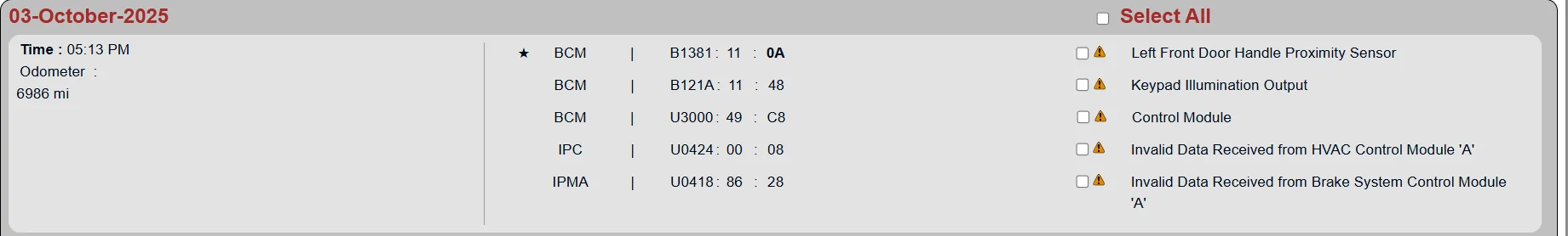

The last time it reported any data to the cloud was 10/3, and the codes are below. The BCM U3000 changed to a stored code and no longer an active fault, but the left door handle prox sensor is still an active fault.
Ford Bronco Sport I'm in need of help. I've had my 2024 BS Heritage for 2.5 months. No problems. I got in it yesterday and it would not start. It said "no key detected 1760022298900-9c
If I had to guess, the door handle sensor is the problem and not the BCM, but without being able to plug into the car directly and run pin-point tests, it is impossible (for me anyway) to diagnose remotely. However, it does seem like a dealer visit is warranted.
