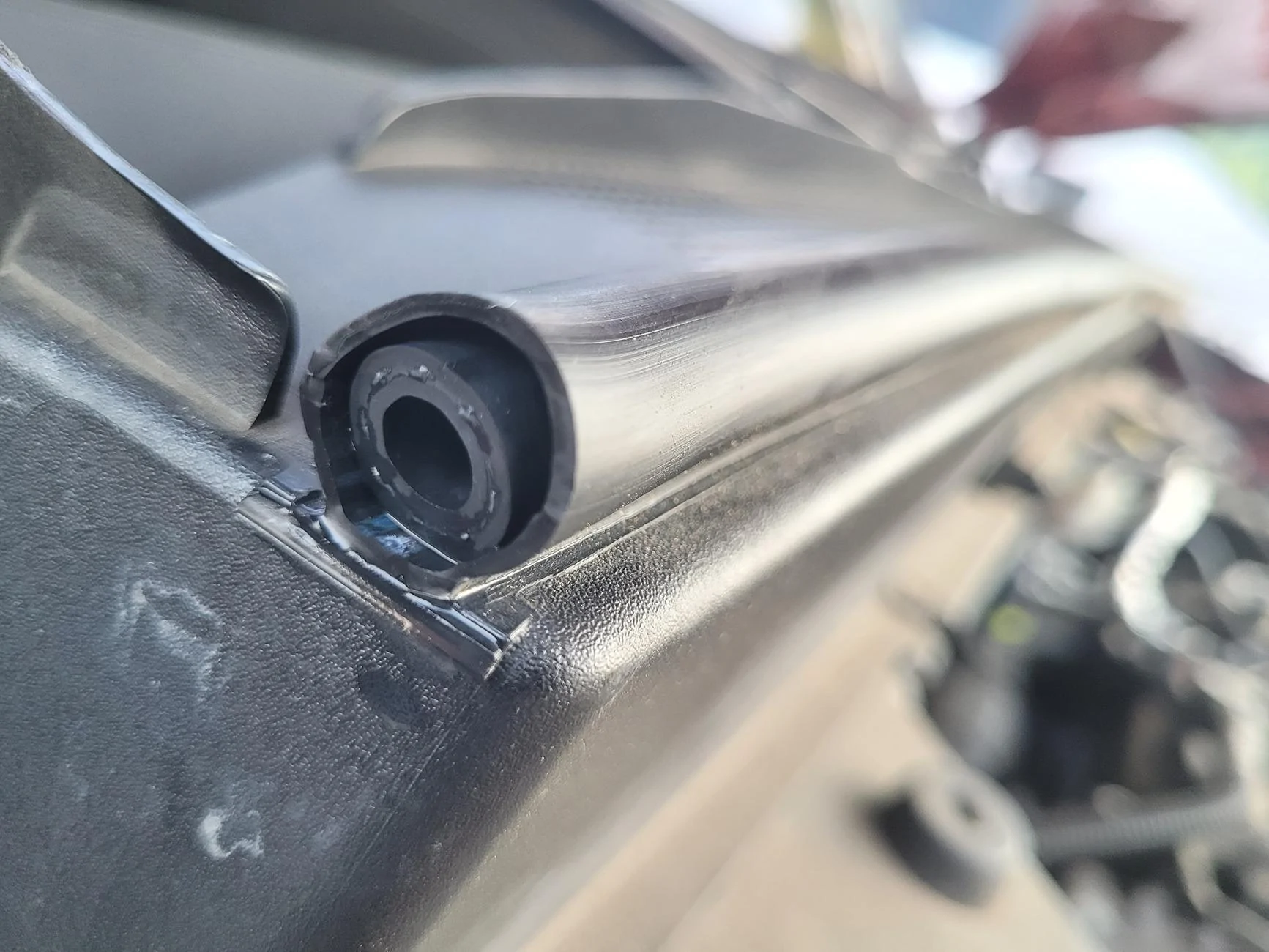

yes it is. It was what I had laying a around to experiment with. It works good, there is a noticeable difference. If I was purchasing something it would be prob be fuel line tubing. I don't know about anyone else; I haven't paid a lot a attention to hood seals lately but I surely remember them from the 60's- 80's being a heck of a lot thicker rubber. I like the deflector but boy does it change the flow over the hood.

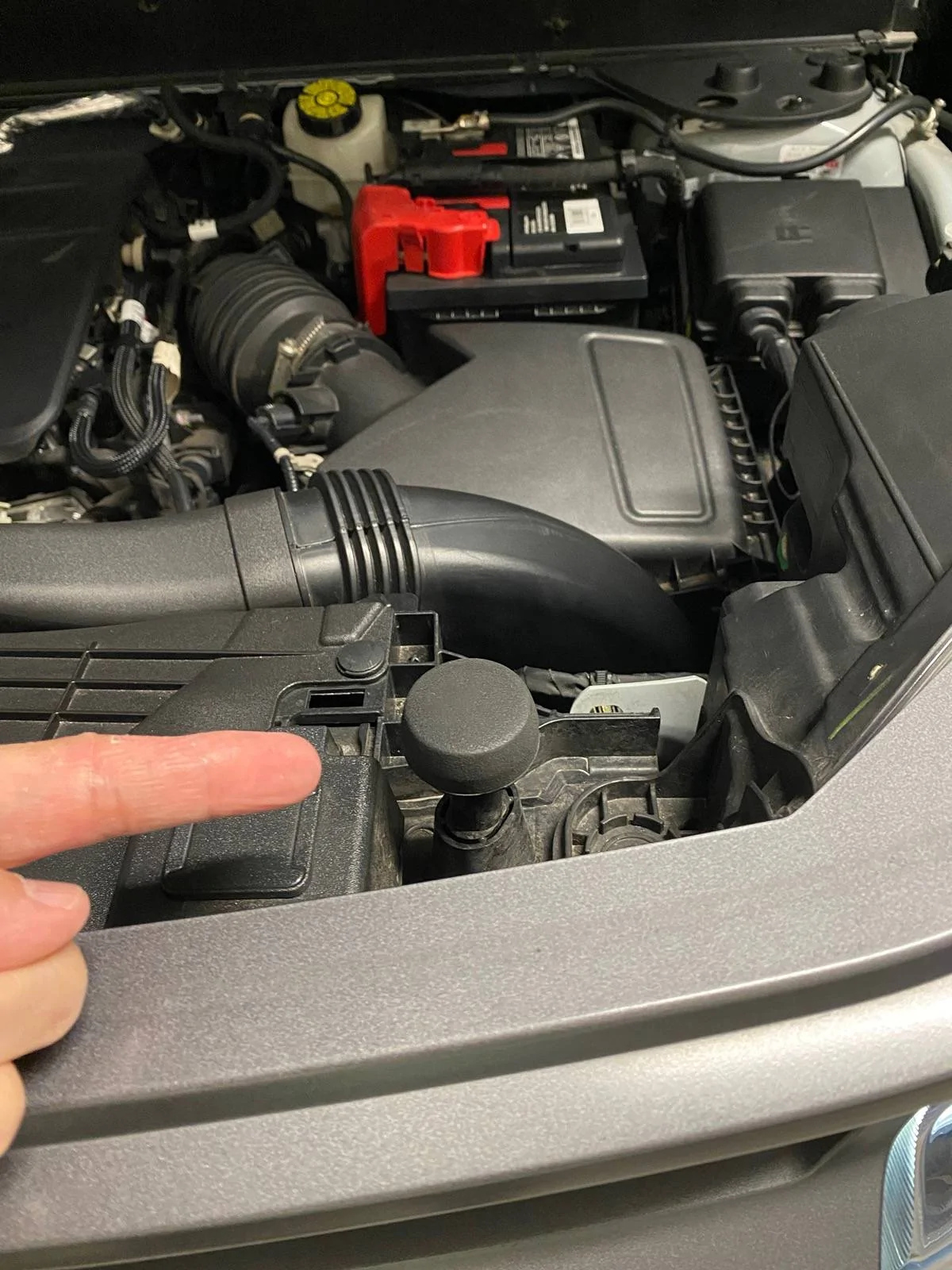

I'm guessing they are not adjusted properly. Mine did not flap at speed, and after installing the deflector, it still does not flap.
I think there are rubber adjusters, as most hoods have this. It's going to make me open the hood tonight and check.

I’m pretty sure we discussed hood shake a while back in 2021, i’ve seen air get thru the gaps between the hood and the windshield but that was only on a car wash dryer.
If you haven't tried you can tighten these (see picture) that way the front of the hood has lesser gap for the air to get thru the front side of the hood.

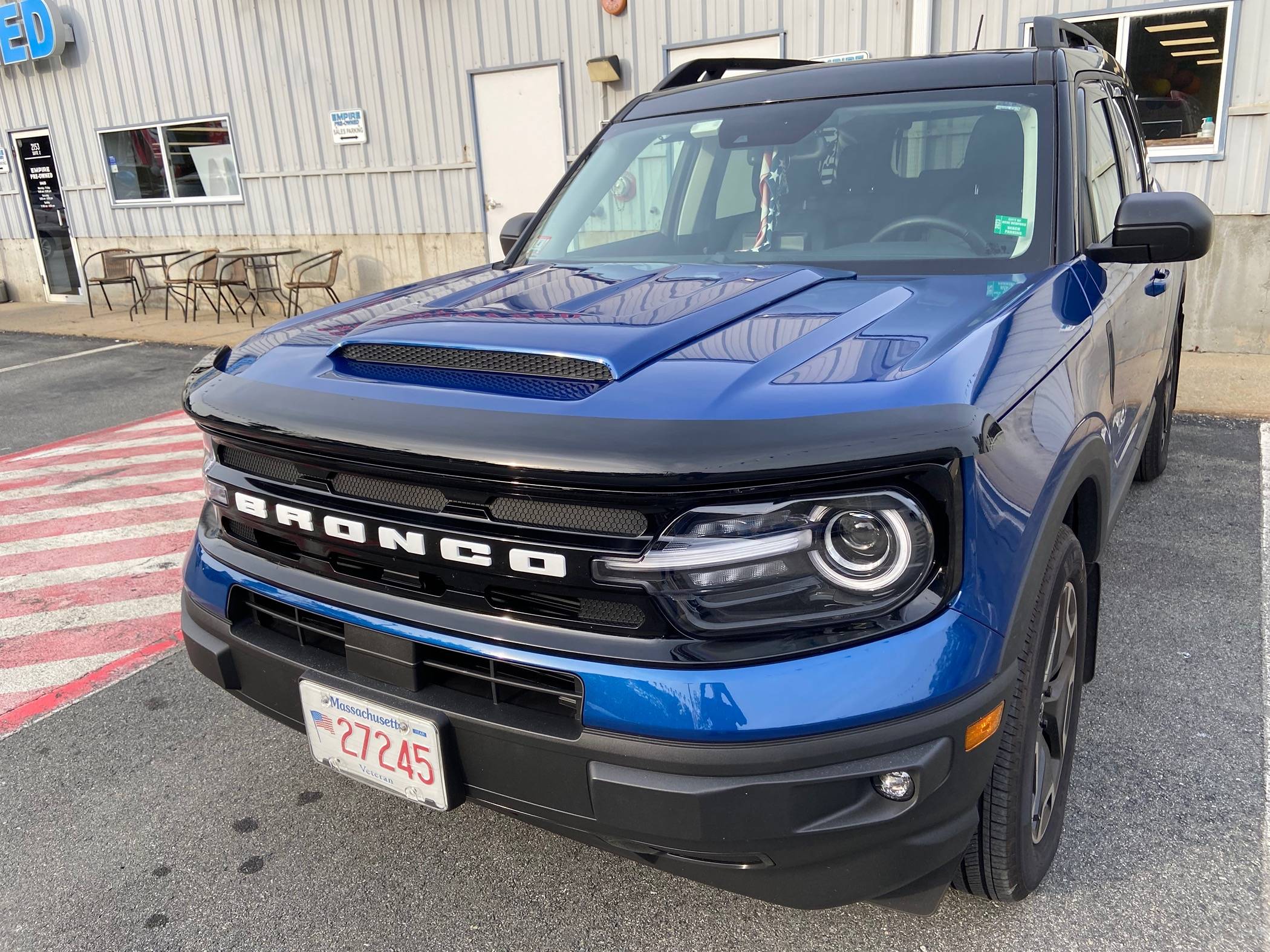

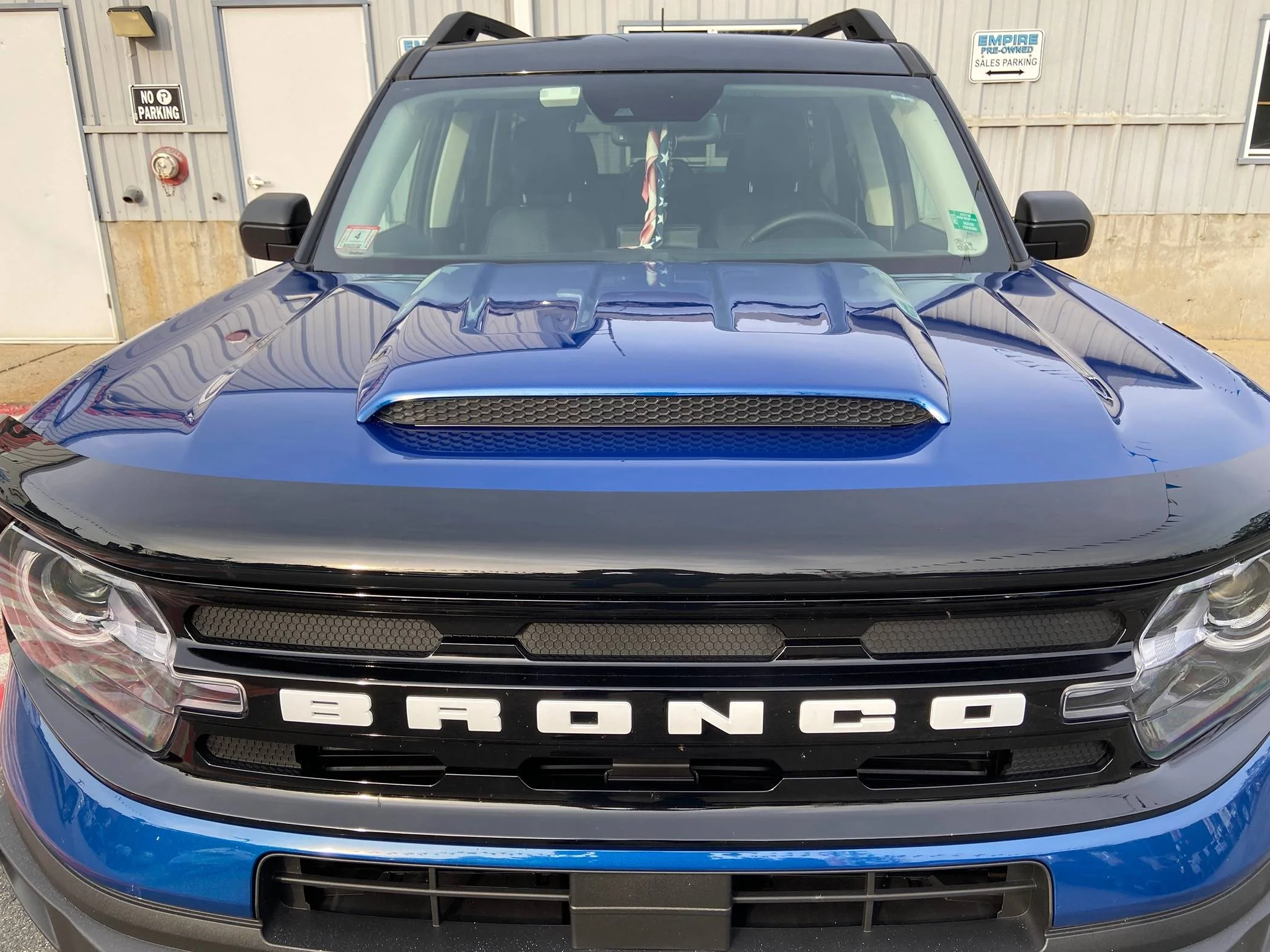

Try a hood scoop it worked for me.
Ford Bronco Sport Hood Vibration Flapping Bouncing IMG_2548
Ford Bronco Sport Hood Vibration Flapping Bouncing IMG_2547
You have a link for where you got it? It does look good?

Just going to chime in here. We currently have a 21 big bend. I installed the hood deflector very early on. Always had hood shake really bad at back edge near windscreen.
Hood has side and front weather stripping, only running a 5/16 length of fuel line through firewall hood weather stripping heped minimize shake.

I Remember they use to
Sorry Joe I got it at Ford but they pulled it off the shelves, due to a couple of them flying off is what I heard.
