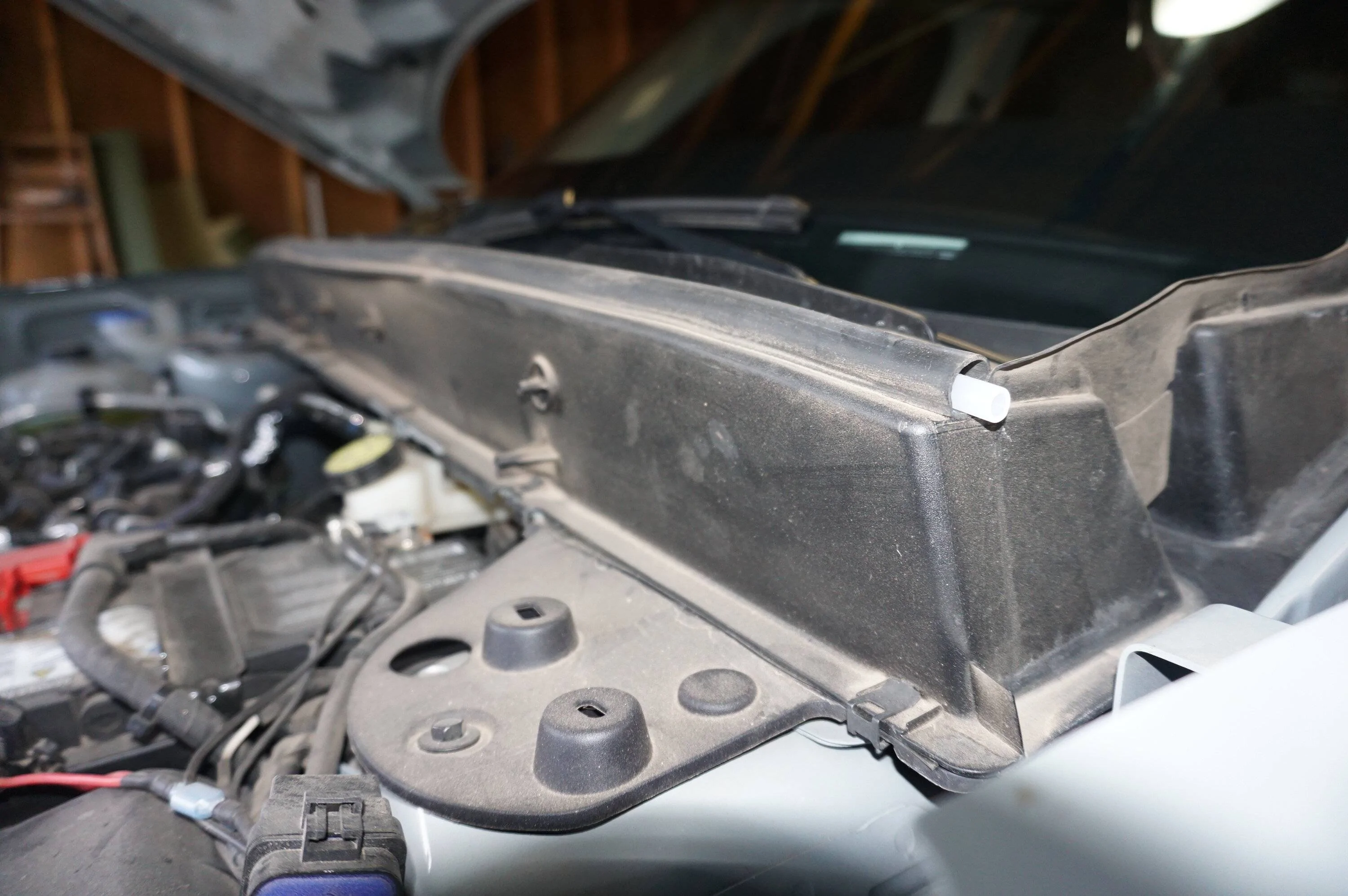

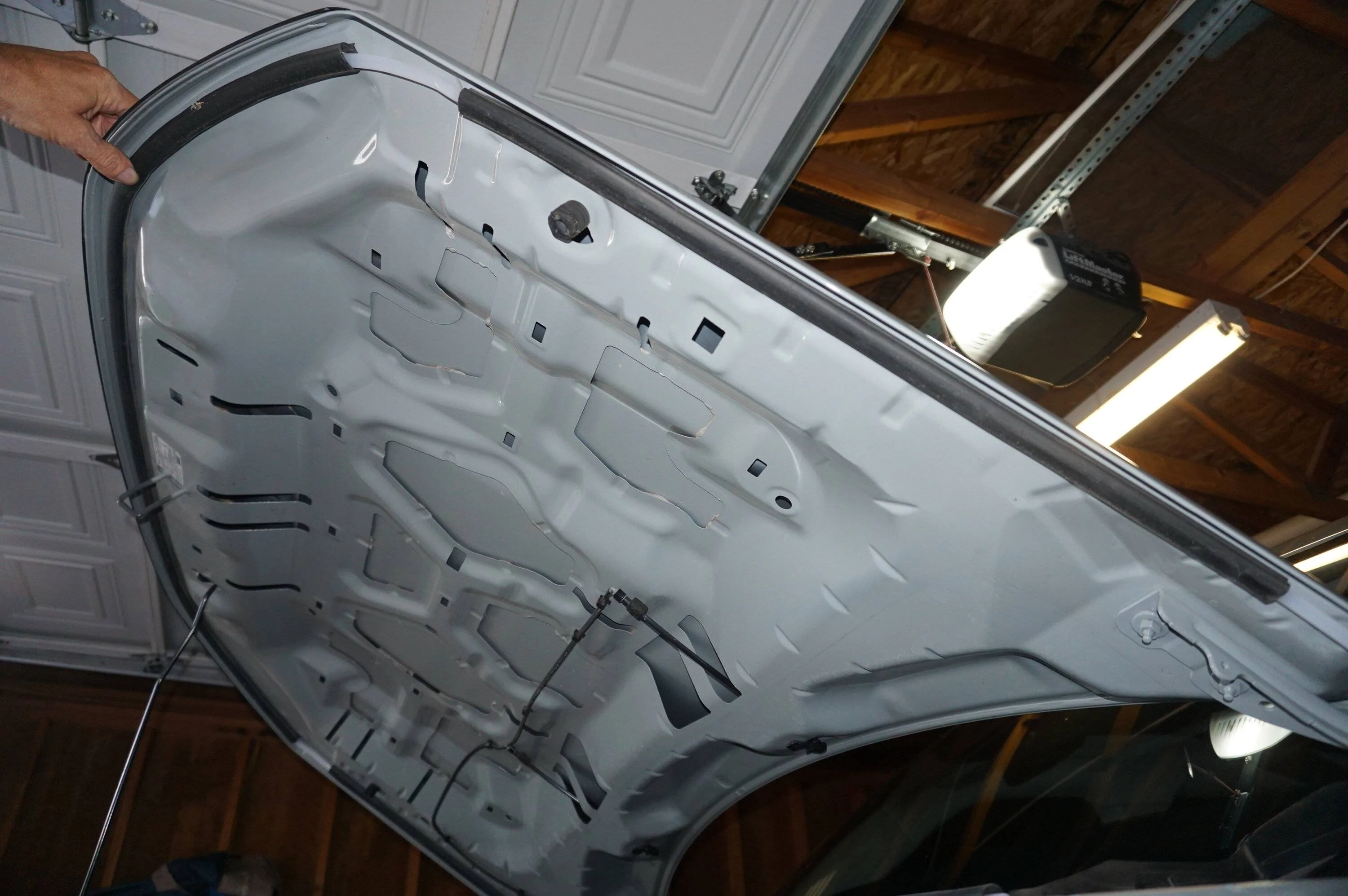

Ever since I put the hood deflector on, I've had issues with bad hood shake I've posted about. I tried the above with some tubing I had laying around that was 3/8" od. First I only put it in across the fire wall. It helped a lot, but I was still getting some lifting at the sides, hinge area. The next day I put the tubing in the seal on the hood itself which seals across the front and sides. I didn't go all the way across the front, just where my finger is in pic. I did fill the gap between the front and side seal. This solved my hood shake problem. It no longer lifts at the sides. I get a little shaking at high speed about the same as before the aero skin 2 which never bothered me.

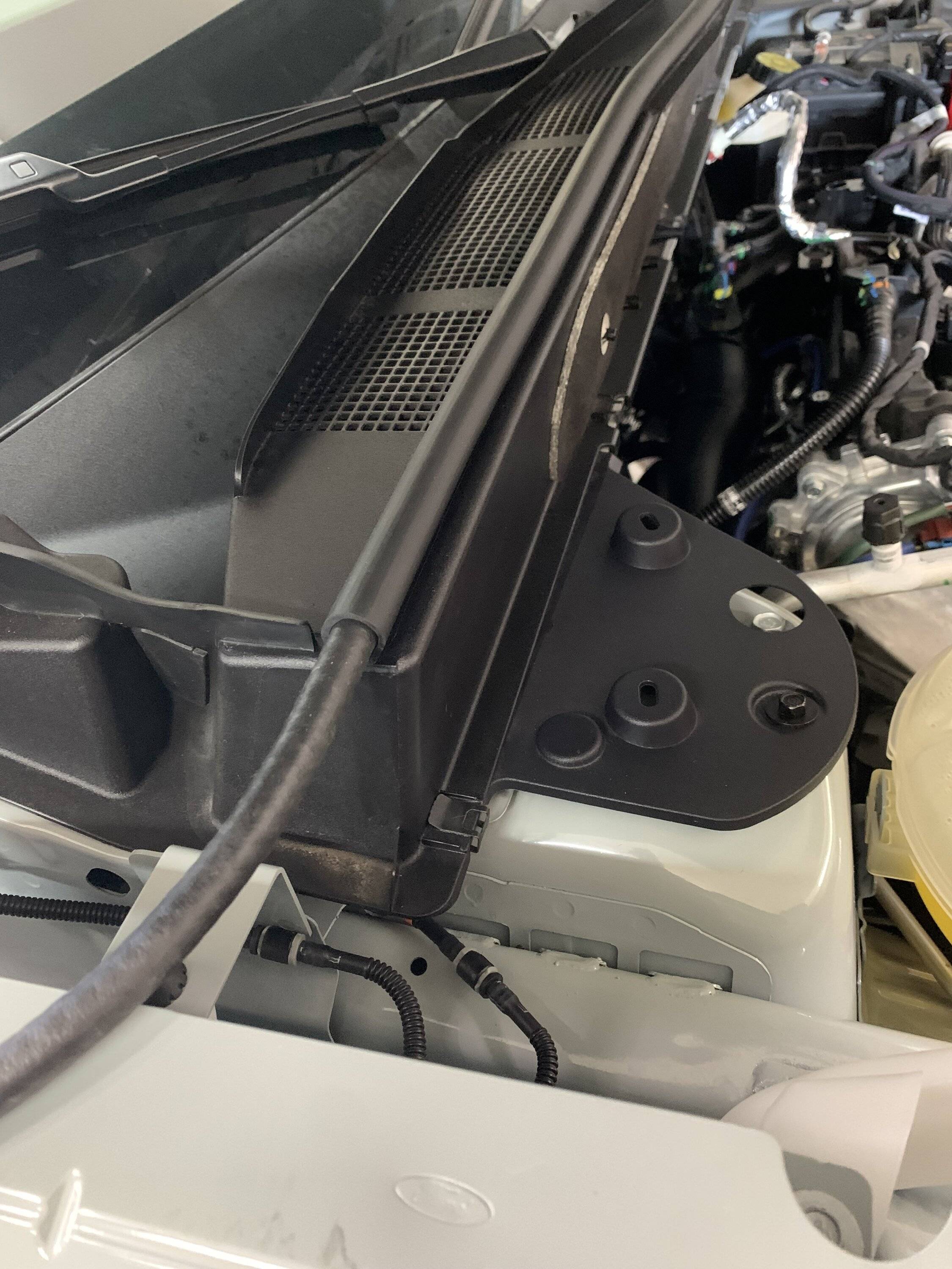

I installed a length of 1/4” rubber fuel line hose into the hood rear seal and it stopped vibration completely. Hose is .490” outer diameter and was easily inserted with the aid of a little soapy water, Easy DIY.

Here you go
Ford Bronco Sport Hood Vibration Flapping Bouncing IMG_7542
Ah so you let the hose hang out on to the sides of the hood? I have some over hang of the hose but it's not touching the edge. Will use what I have left to do the over hang. My shaking has went down considerably since doing this but still just a little, the silver color doesn't help, it shows any movement in the hood lol

Is that a rigid hose? Similar to plumbing Pex?
yes it is. It was what I had laying a around to experiment with. It works good, there is a noticeable difference. If I was purchasing something it would be prob be fuel line tubing. I don't know about anyone else; I haven't paid a lot a attention to hood seals lately but I surely remember them from the 60's- 80's being a heck of a lot thicker rubber. I like the deflector but boy does it change the flow over the hood.
