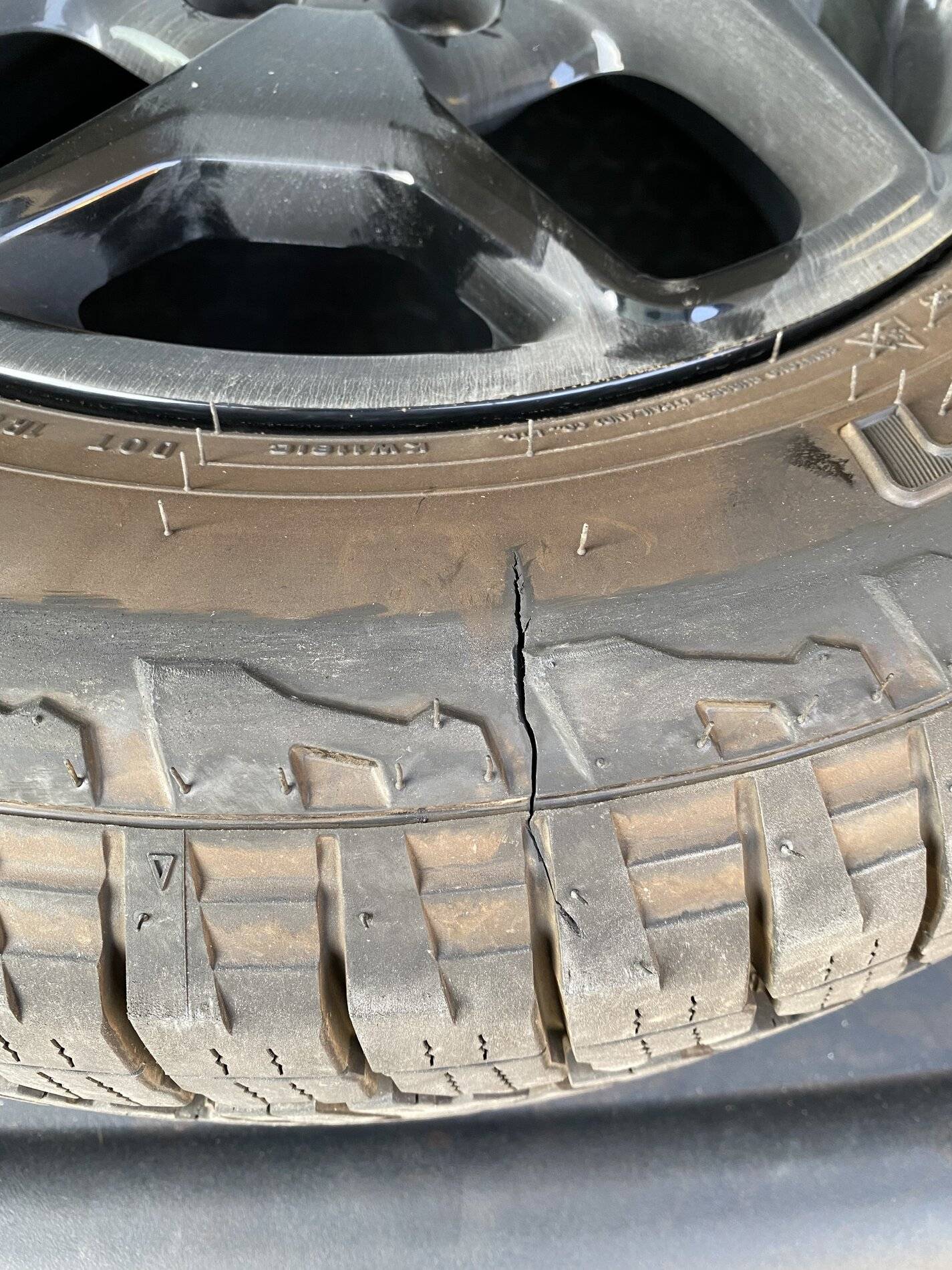

I have had my Bronco Sport FE since March. Less than 6k miles and no off-roading — yet, but I blew out the sidewalk on one of my stock Falken Wildpeak AT 236/65R17 tires. Fortunately I was only a block from my house when this happened and I purchased the Ford tire protection plan. If you have these tires, inspect your tires for possible weak spots.
Ford Bronco Sport Tire Warranty Worth It! 3CA83B71-5745-4699-BCF6-E82AF23989E3
I did have an issue with my Falken tires. Here is the post I made to the forum back in August

If Ford saved and sent this tire in to us or their distributor, we can evaluate it further. We'll simply need their 6-7 digit claim number so I can track it on my end.
From my experience, this could be impact/cut/road hazard, leading to runflat damage based on the darker tone in the upper sidewall. We do offer coverage on the AT3w, for the first 3/32nds of wear for any unrepairable road hazards.
