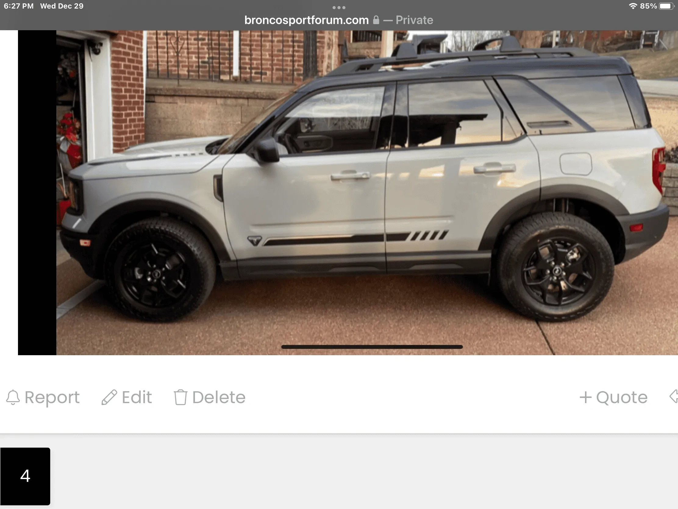

235/65/17 at3 best tire for sports .
Ford Bronco Sport Hello from Falken Tires 6EC0BFCB-E684-46EA-80D2-03F7DF642CD3
