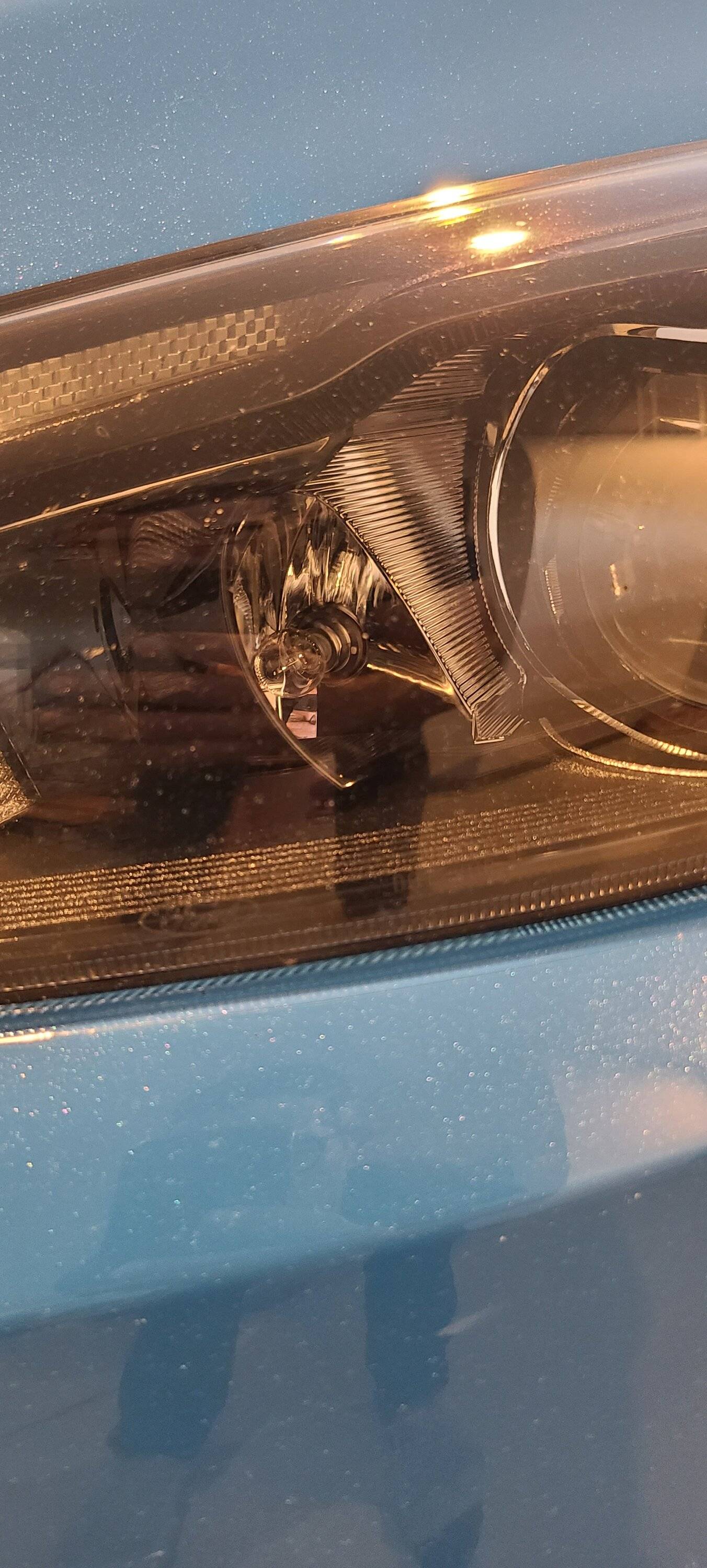

Those are separate puddle lights, not the fog lights. Only come on at low speed when turning. My Focus also has them also, notice the bulb inside the reflector facing to the side next to the projector lens. Bronco uses the smaller strip lights in the housing.
Ford Bronco Sport Didn't know this 16978894419203210971873954780185
Ford Bronco Sport Didn't know this 16978894597254858624758746695827
The strips are your turn signals. The fogs are the cornering lights for models equipped with them

The strips are your turn signals. The fogs are the cornering lights for OBX and BL/HEL models
