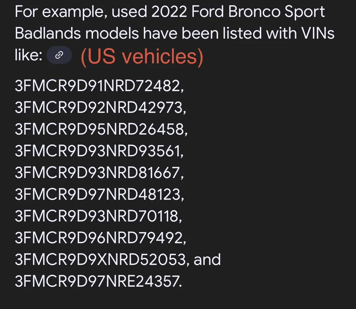

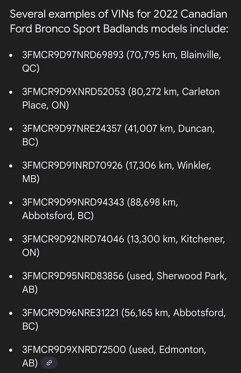

Did you figure this out? If you can get me the VIN of a Bronco Sport built for Canada, I can compare the a/b data in the sections of the BCM that control the DRL's. I don't think it would be too difficult to figure it out.
@rugedraw here are 2022 Bronco Sport Badlands VINs, Canadian and US
OP has a US 2022 Badlands
These VINs are open info posted on the internet but should provide info to do the compare you offered using this VIN info:

Thanks, but I did that to see what interest he had in getting his issue resolved. If he was not willing to take a minute to find me a VIN, then I wasn't going to spend x amount of time trying to figure it out for him. He apparently ghosted his post, so either he figured it out or decided to go a different route to resolve his issue. We've helped plenty of folks from there Canadize their imported trucks over on the F150 forum. First thing he needs to do is change the country code in the APIM, IPC and TCU from 5553 to 4341 in these locations:
