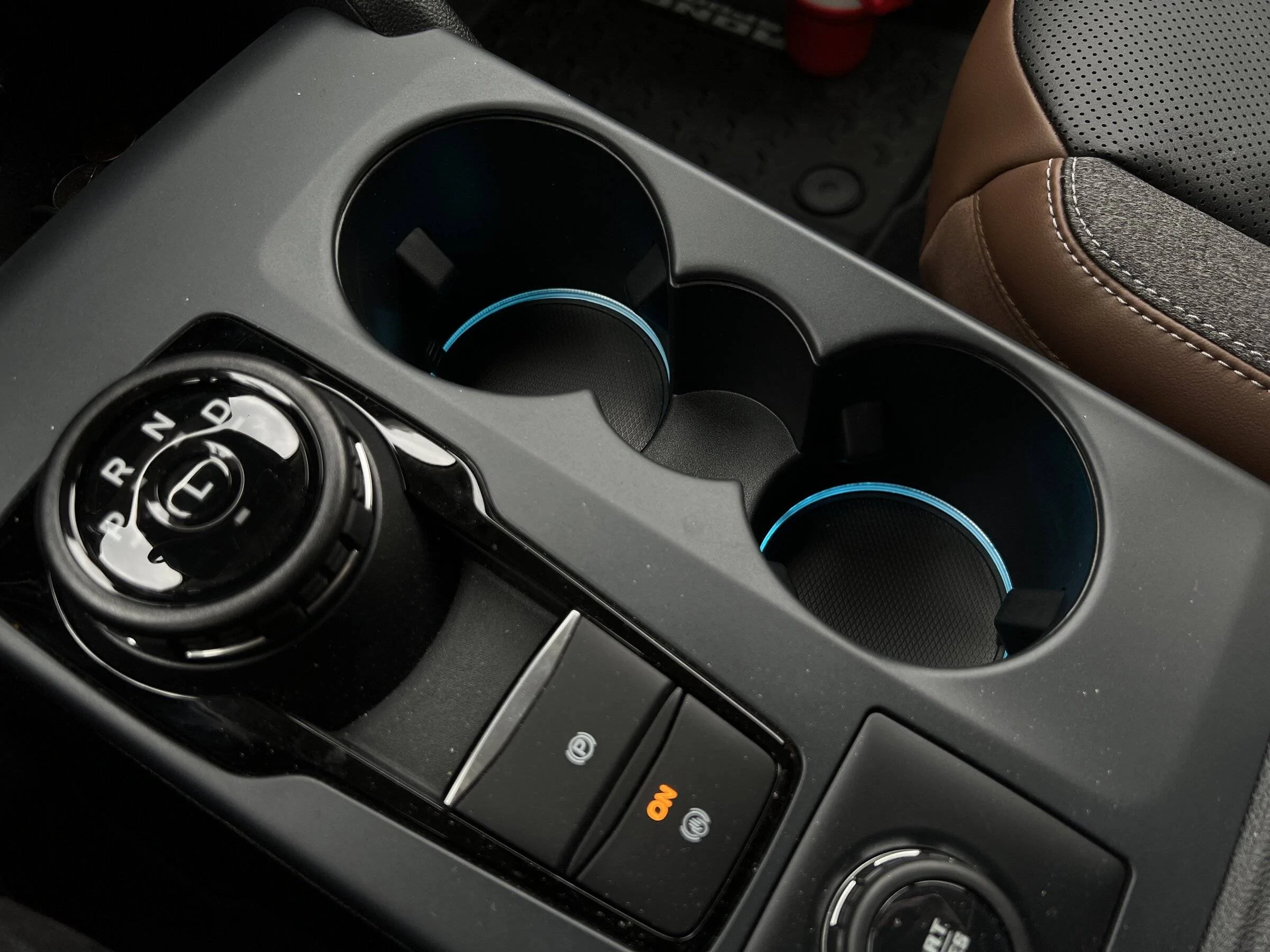

Hi ya’ll I’m new to the forum, but wanted to share a little bit of my BB experience. I got my Cactus Grey Outer Banks on December last year and noticed the cup holder wouldn’t illuminate like in other ford models. I contacted several dealers and all said the cup holder didn’t come with ambient lighting. After removal of cup holder I found wires cut and pre-set for ambient lighting, so I started my research. I ended up finding that the 2020+ Escape cup holder fits which has ambient lighting. Part #LJ6Z-7813562-FA. Now I have the full ambient lighting inside my Outer Banks and if you want to add it here it is! Attached are pics of originally equipped cup holder and the cut wires, part number, and finished product.

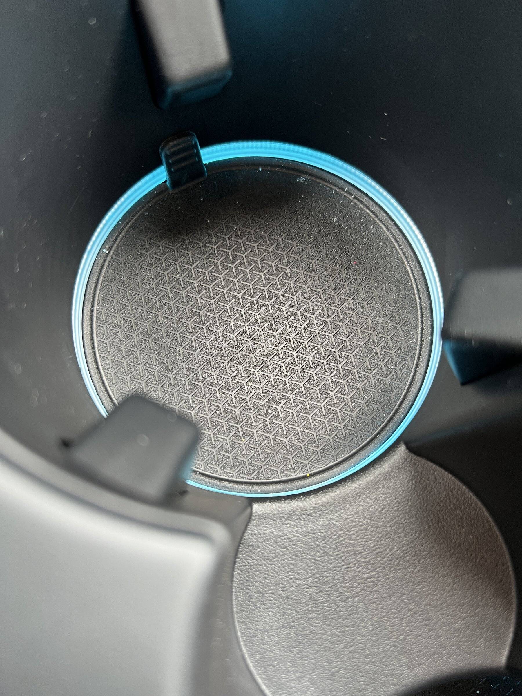

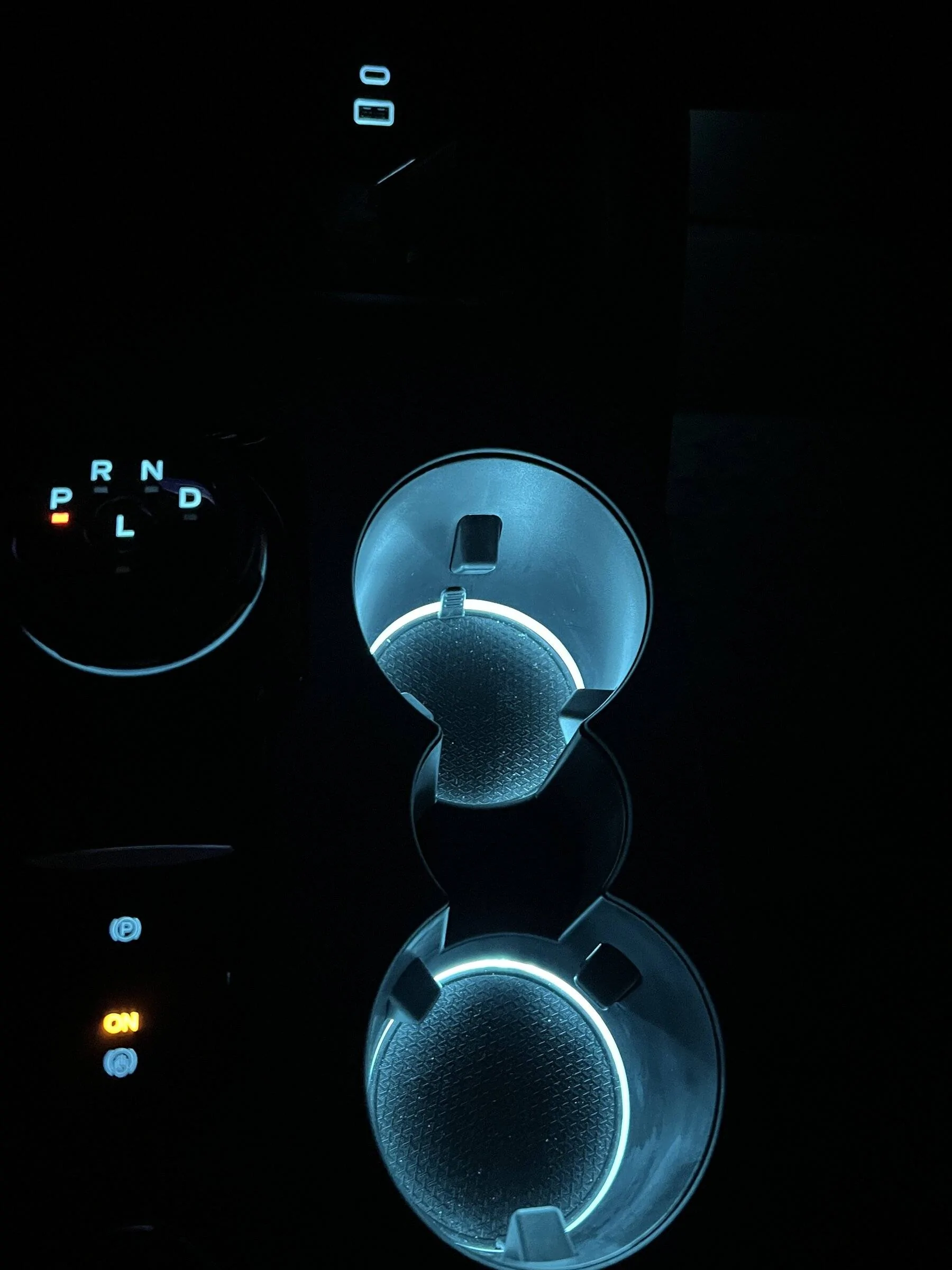

A big thank you to JCampos30 for figuring out the part # for the Escape cup holder and doing the leg work to see if it works. Ordered the part Saturday and it came in today. Took all of 5 minutes to take out the existing cup holders and install the new ones with the ambient lighting. Everything works as it should as far as on/off and dimming.

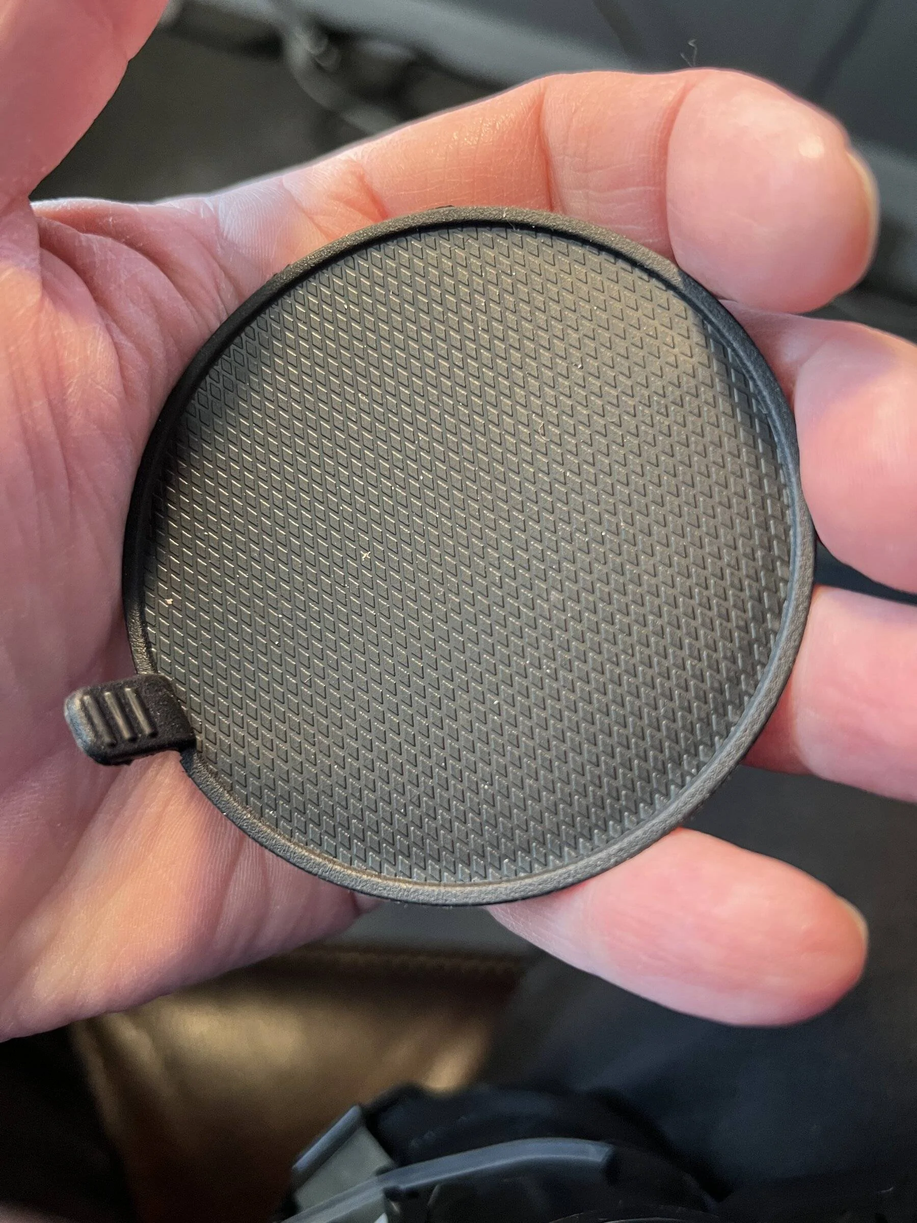

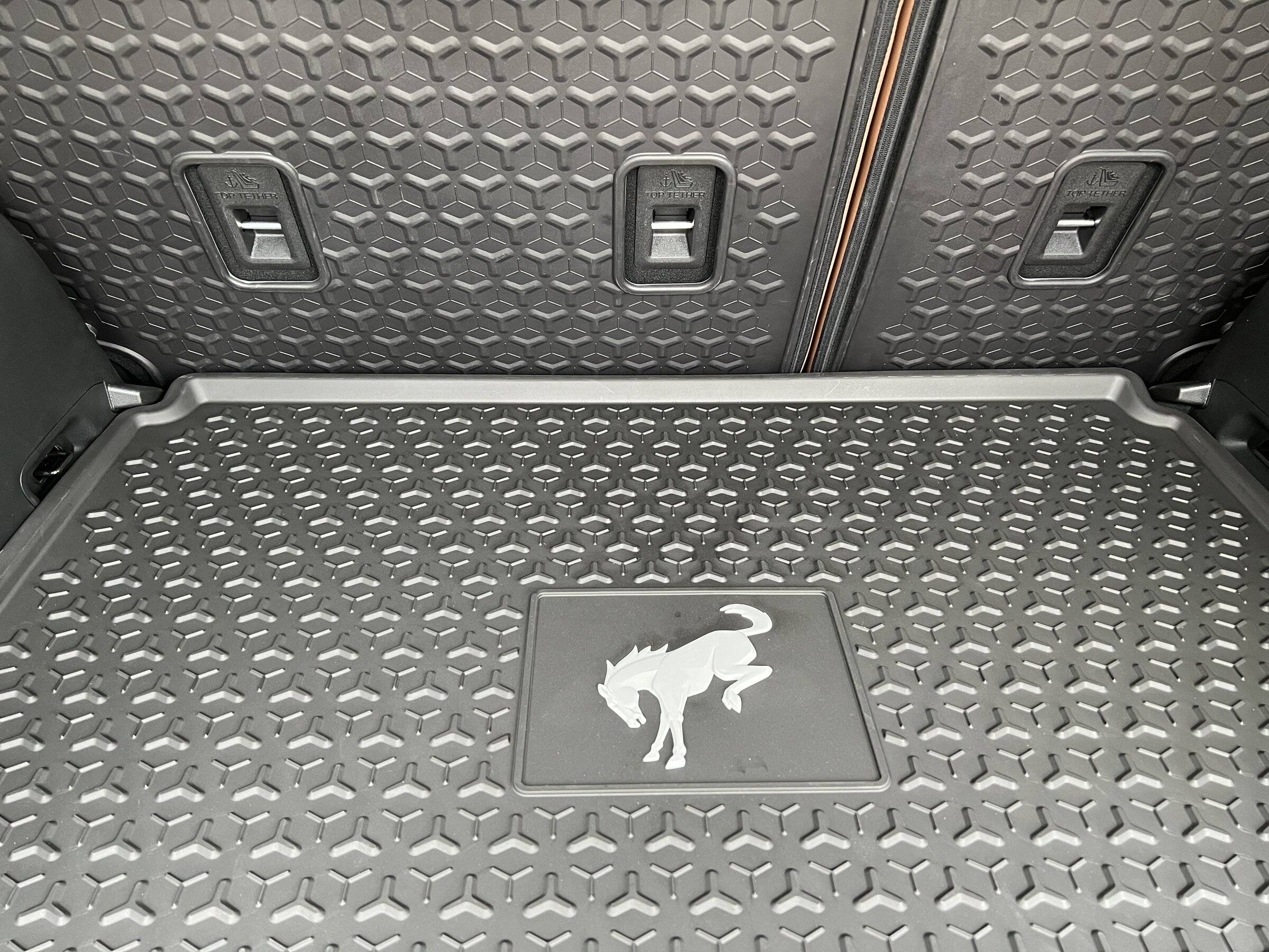

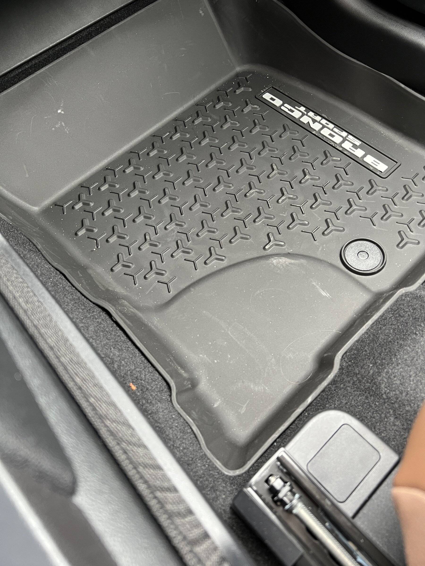

Oh yeah, one more little tiny attention to detail thing. Anyone using the Escape Ambient Light cup holder, you'll want to swap out the rubber pads in the bottom of the cup holders with your original BS ones. The originals have a pattern in them that sort of matches a bunch of stuff in the BS. The Escape ones don't. It's not exact but similar.
Original pad
Ford Bronco Sport Cup Holder Ambient Lighting B8BDDAEC-E78D-4EA5-9160-5159020FAE56
Escape pad
Ford Bronco Sport Cup Holder Ambient Lighting 878CD1E3-08CC-459D-A108-C99008F01030
Pattern found in Bronco Sport
Ford Bronco Sport Cup Holder Ambient Lighting 69D6B19C-B967-47F9-9B8D-580A32F431EF
Ford Bronco Sport Cup Holder Ambient Lighting 2921F132-9A30-4698-93A9-10E4348C94B1
