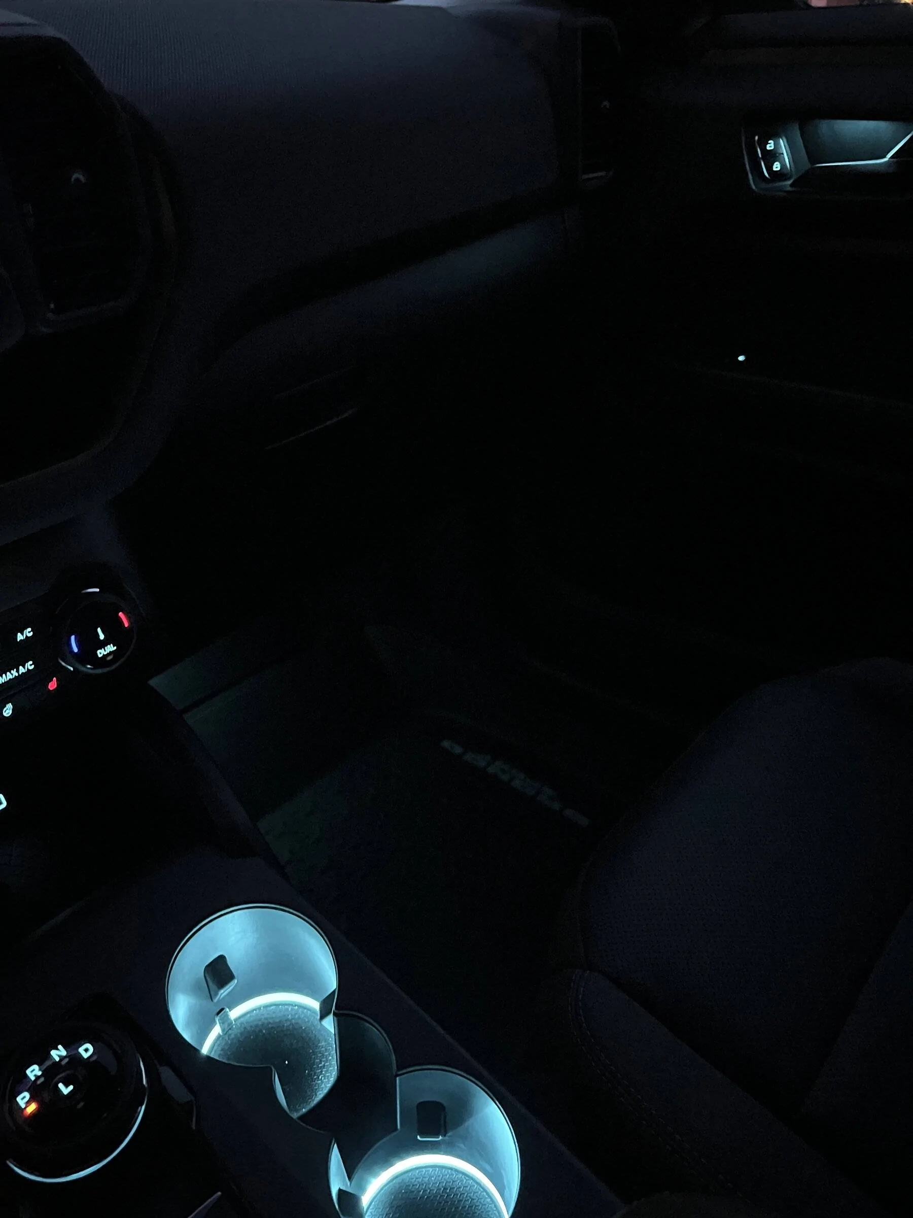

Installed and works perfect.

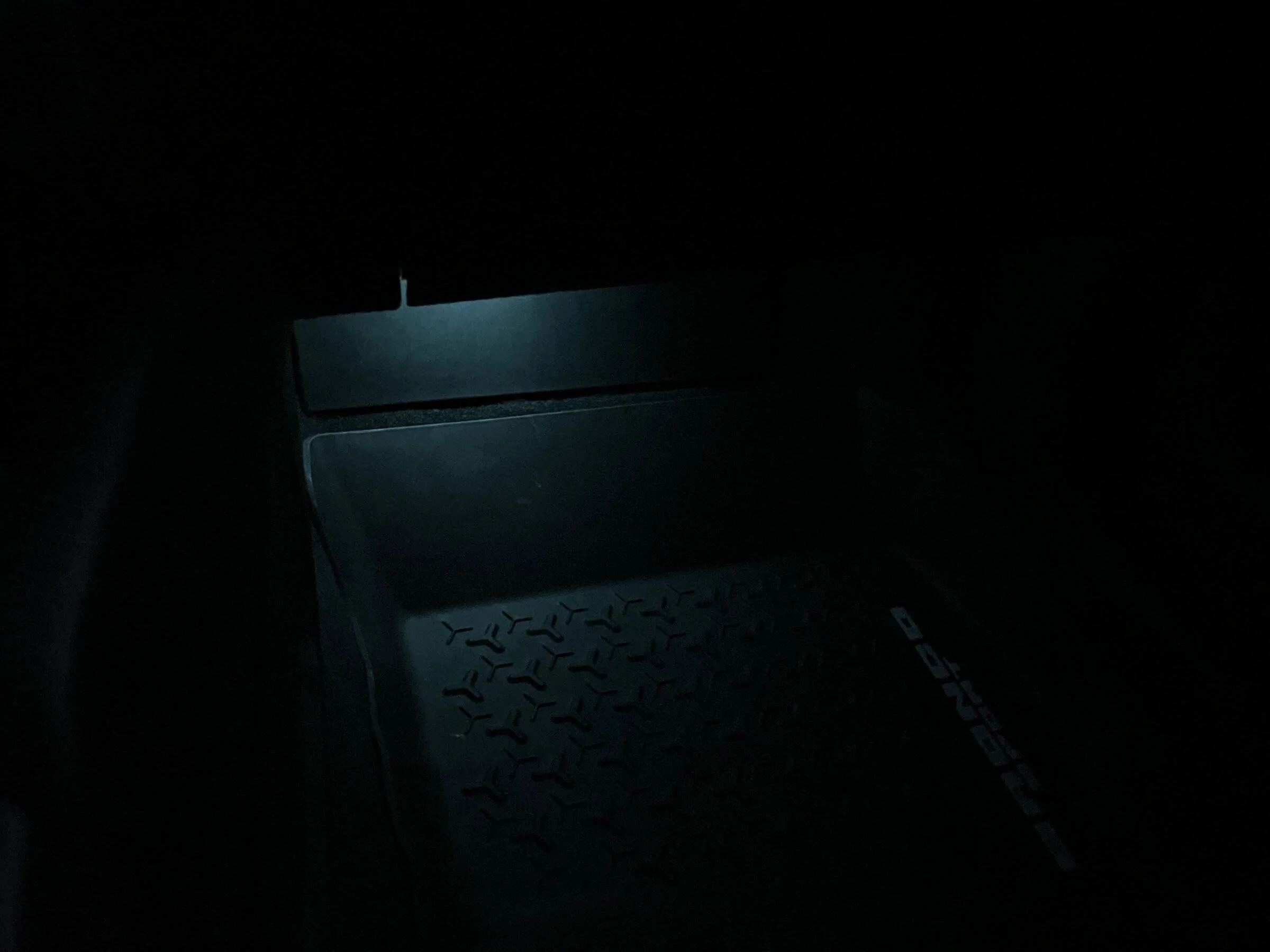

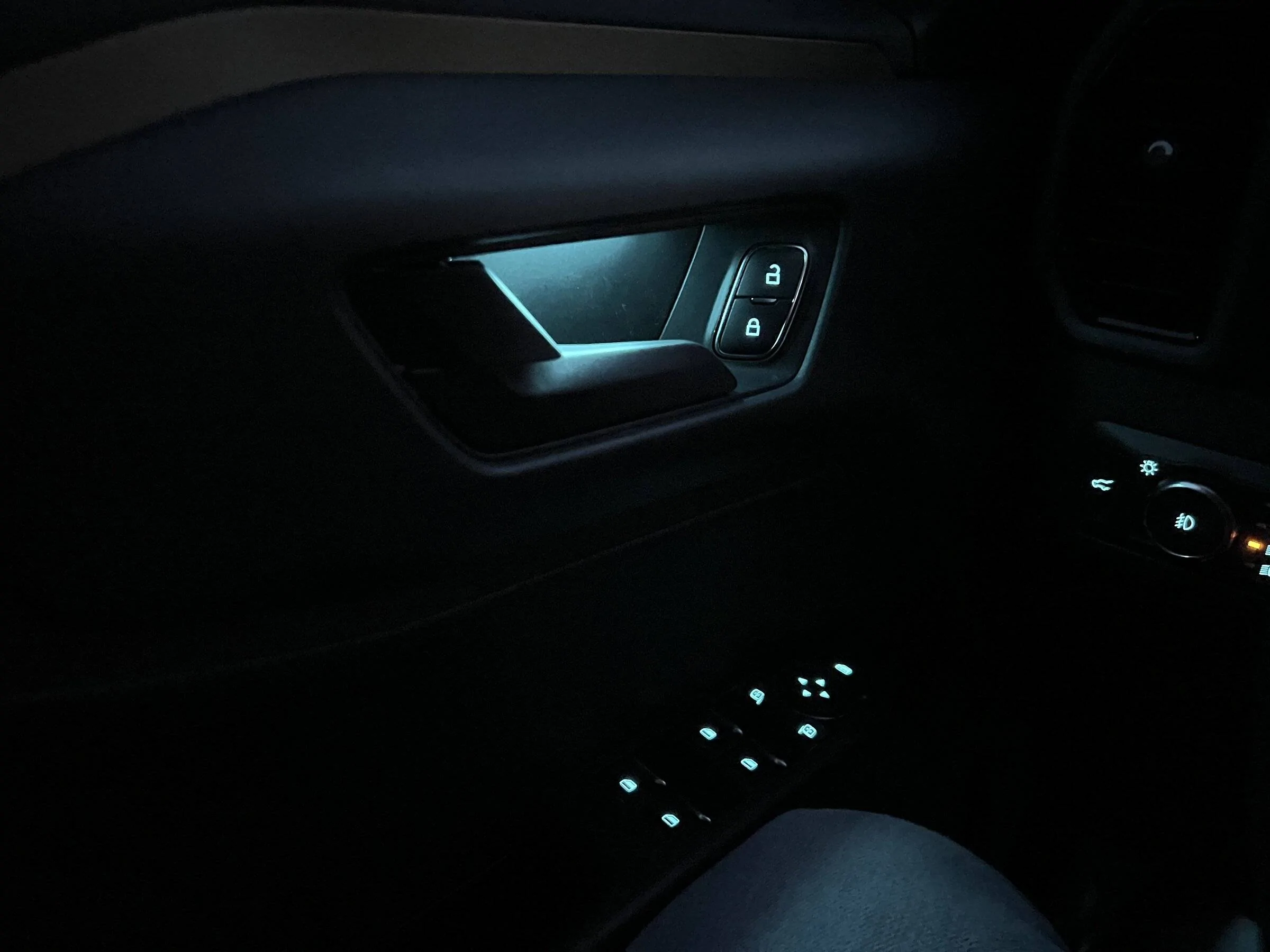

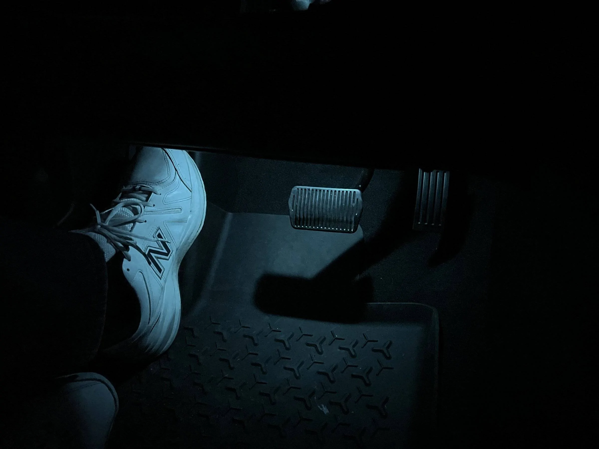

wait, you all have lit up door handles and foot wells?? Pics?
I don't have pics at the moment, but if you're not seeing yours, they are probably dimmed. The control for dimming ambient lights is on your Sync3 screen.
