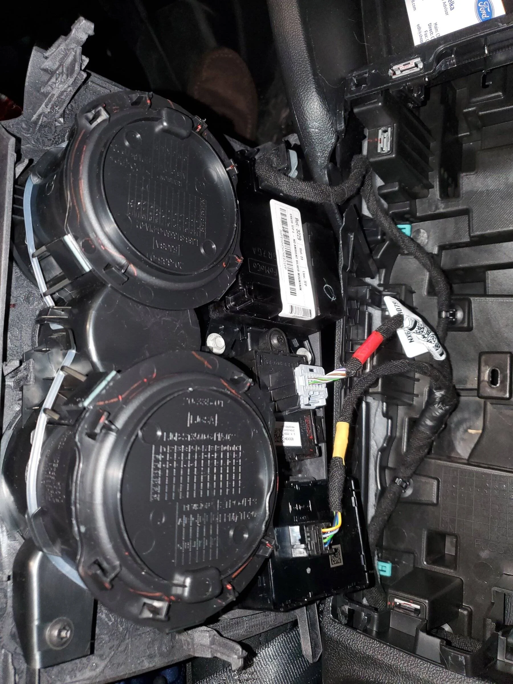

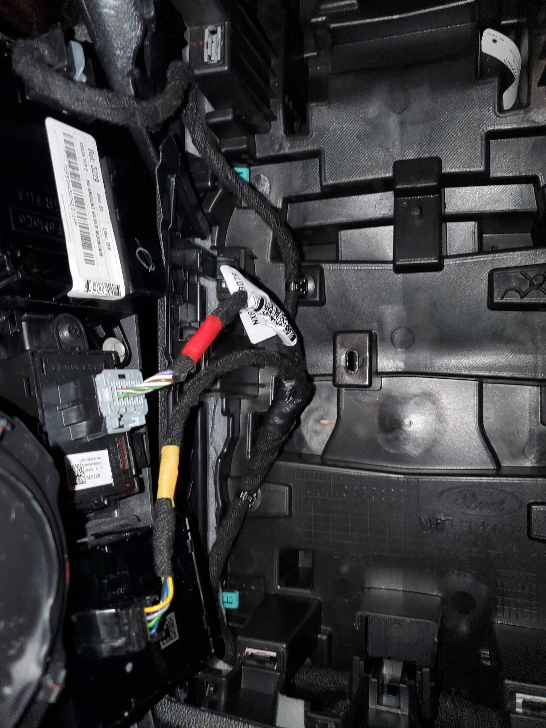

After removal of trim, flip it around on a side (optional to disconnect every connector if you want more wiggle room). I didn’t disconnect any other connector besides the pre-wired cup holder connector.
Ford Bronco Sport Cup Holder Ambient Lighting 024D6758-8144-4DAC-834B-AF56D14BDF62
Once that is disconnected you can go ahead and remove the 3 T25 Torx screws holding the cup holder in place. Once removed just wiggle it off and remove it then install the new ambient lighting cup holder in its place and reconnect connector and snap it back and place and enjoy!

I 100% think you got railroaded. The Outer Banks comes with it. Or at least it did until some point. If Ford took it out, slip the parts guy a VIN for an earlier model OB. It should come up. I've found the Bronco Sport part on the Ford parts website before. I'd believe the order guide and all the OB I have seen that have illuminated cupholders, not the parts guy at the counter. At least you got it working with little pain. IIRC, that cupholder is a $50 part or so.
Is the wired connection there only for the Outer Banks trim, or is it found in other trims as well? Wondering if this will work for my Badlands.
It is not on the Badlands. I can tell you first hand that there is no wiring present for the ambient lights. Oddly, we do have the lens and socket for the ambient light module at the front of the console pointing into the phone charging area... but no wire or LED module. Even worse than all that- the ambient light controls that enable the feature are not on the system settings so you have to get clever with Forscan to even enable it. Or really get creative. The illuminated part will fit in there if you care to find a way to rig it.
