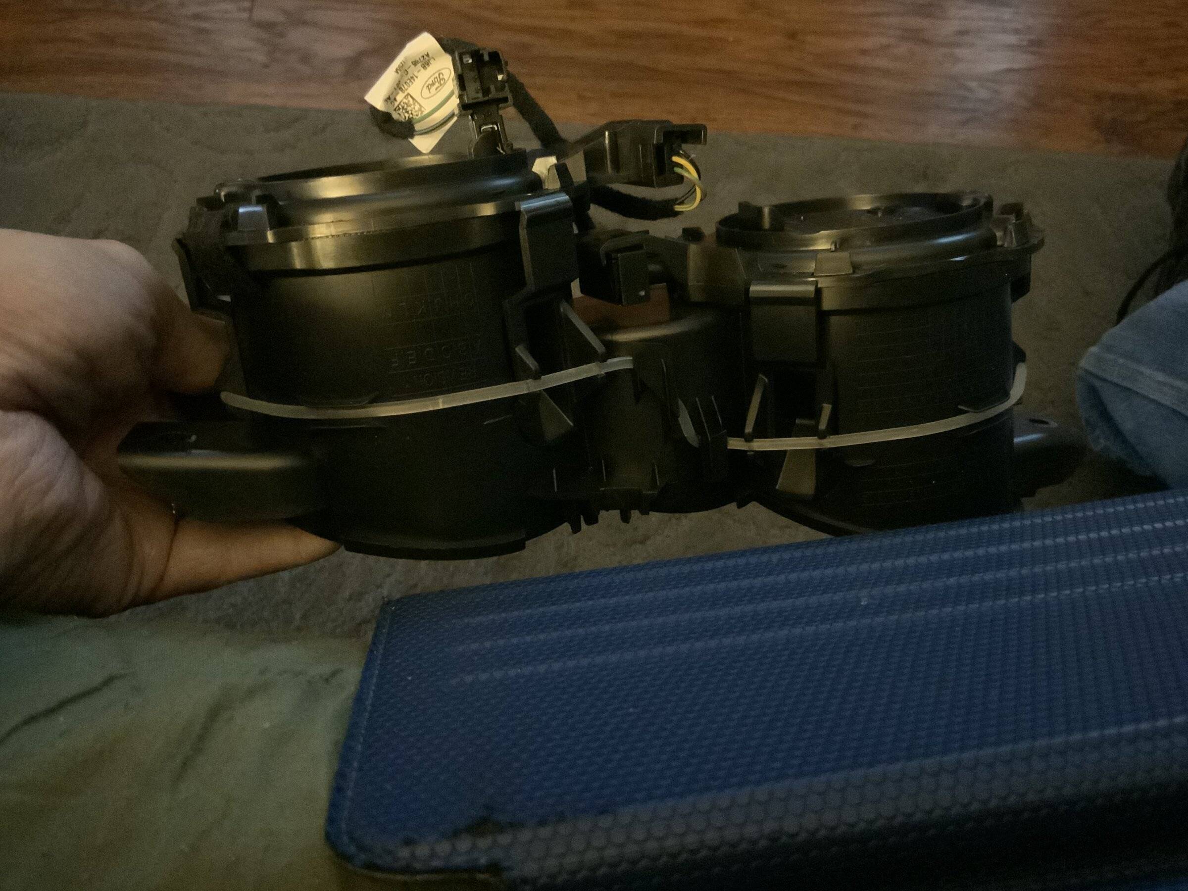

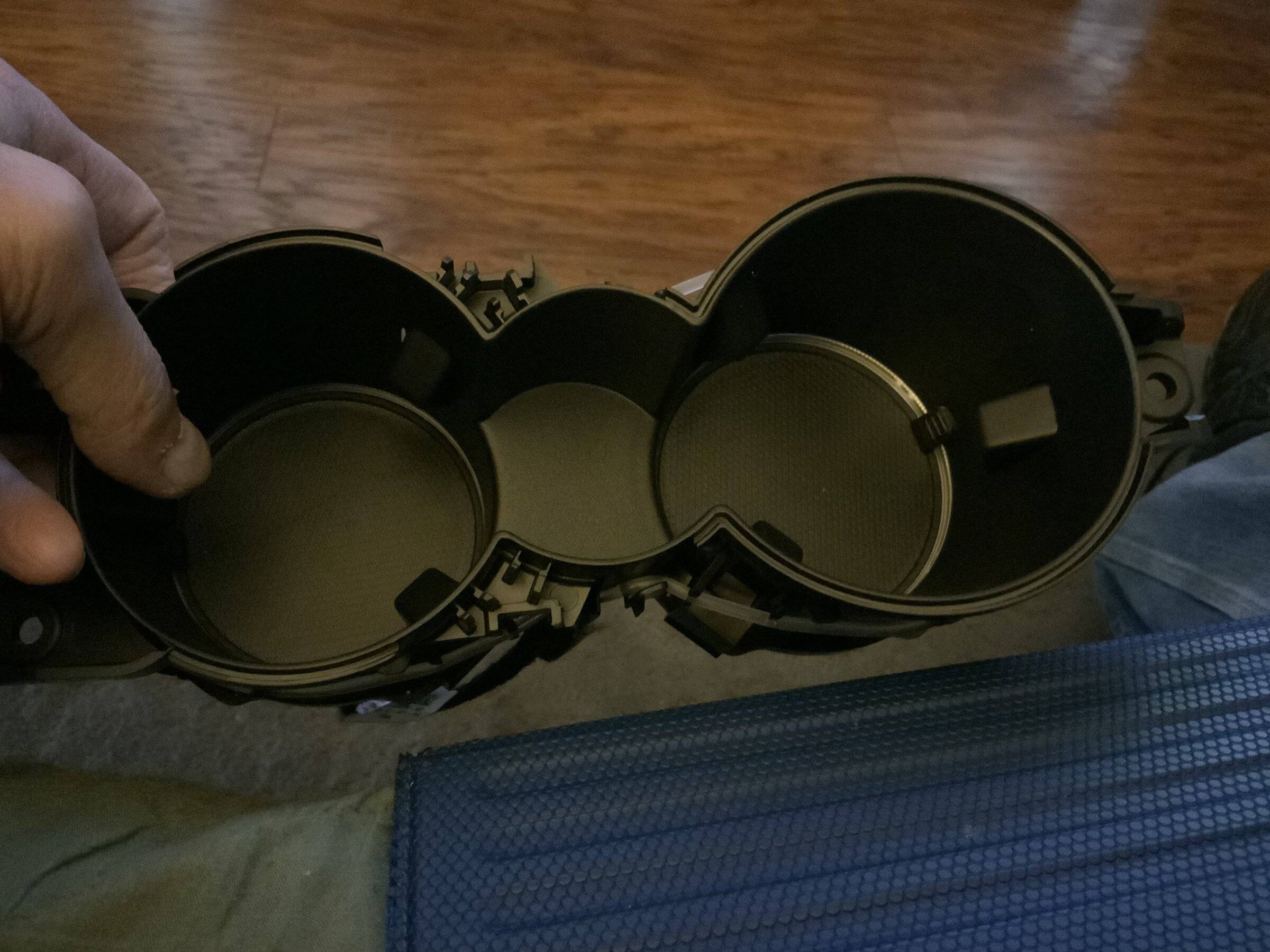

Well whereā€™s there a will thereā€™s a way, I couldnā€™t find any Extra wiring on my BigBend Model, I purchased the Escape cup holder from Levit Town Ford for $ 18.38 Iā€™m gonna with some help from a buddy figure how to tap into the Blue Lights that are already in the console so I can get my cup holder to light up on my BigBend. ( Stay Tuned.)

When I took mine apart last week I had no extra wire harnesses around, but what I did see was that my Goat Mode Dial was lit up blue, so Iā€™m gonna try to tap into that harness to get my cup holder lit up also.
