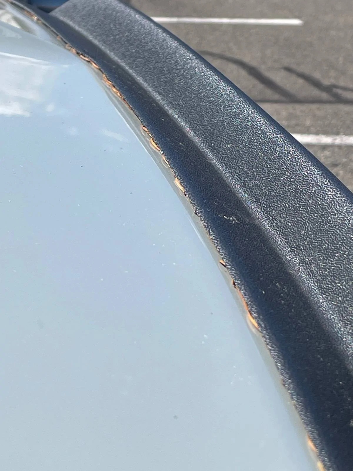

I just installed mine and so far my main issue is because the adhesive prevents the aeroskin II from sitting 100% flush, I’m getting a shit ton of pine needles building up in the gap.
Am I supposed to run a bead of some kind of sealant down that gap? I didn’t have the instructions with it and definitely don’t want to throw on anything that will eat the clear coat.
Ford Bronco Sport Bug deflectors. IMG_4283

It's working. It kept those pine needles from getting on your windshield!
On a serious note, once you get all the debris out of the crack, you could apply a small bead of clear silicone to keep all that crud out. It's not mentioned in the instructions that I recall, but a good idea non the less.

Instructions doesn't state to do or not to do , user preference I suppose
