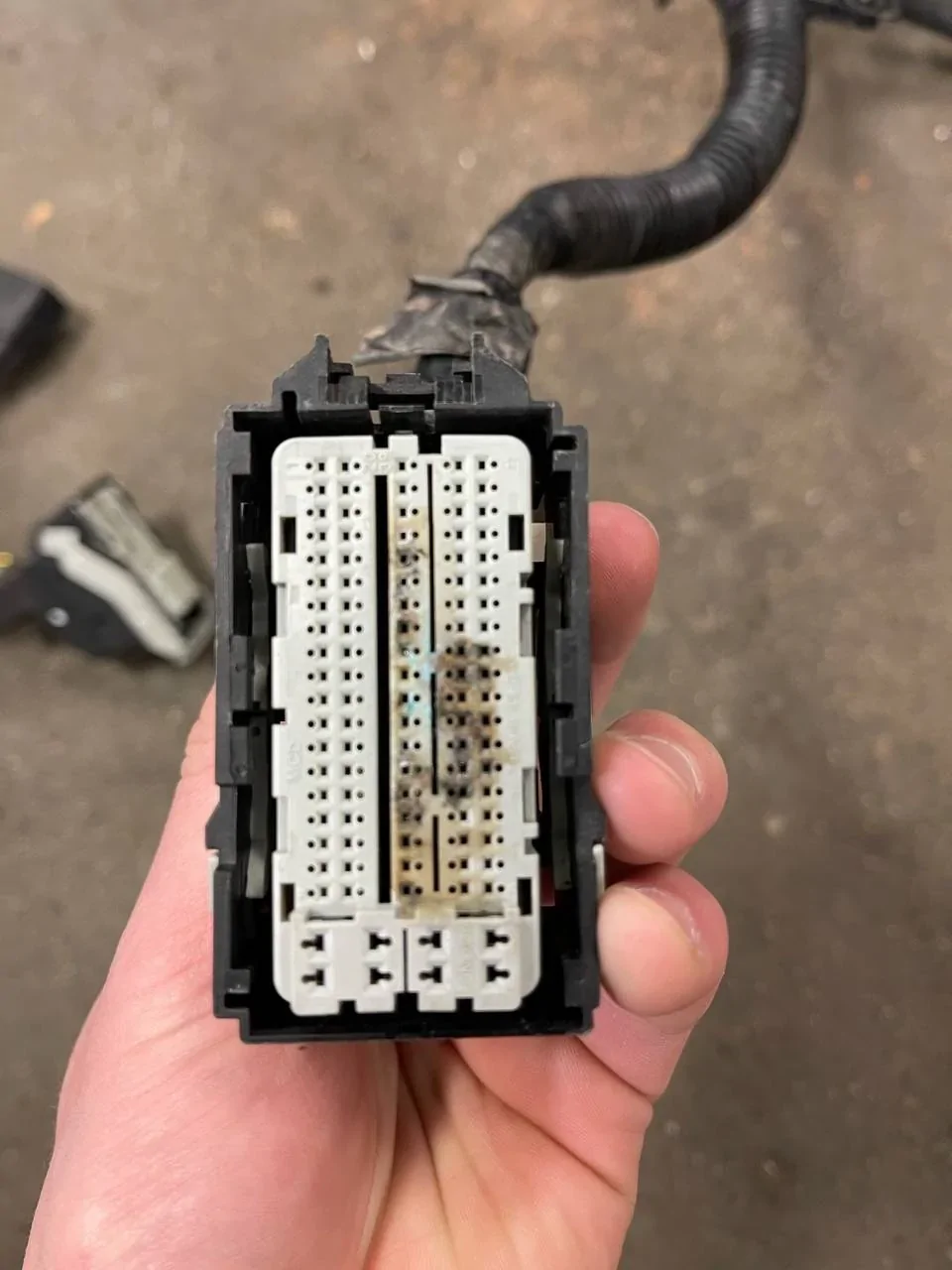

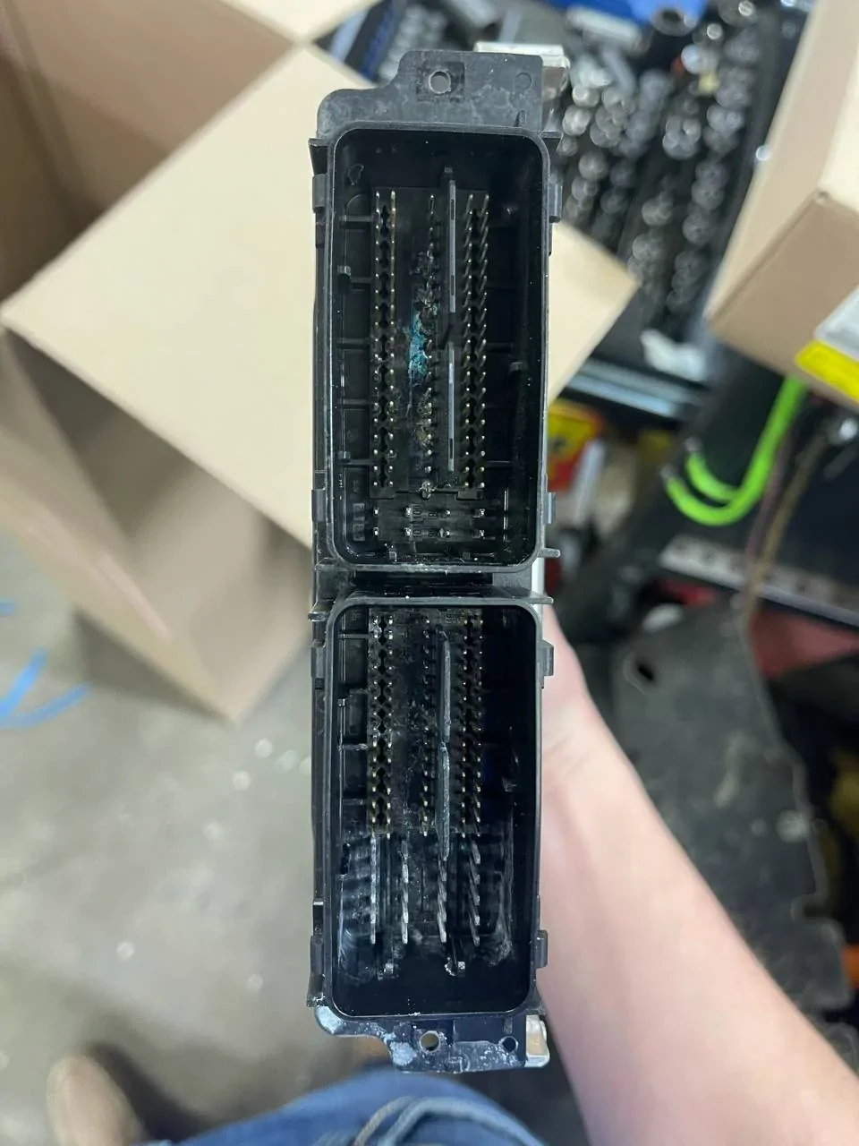

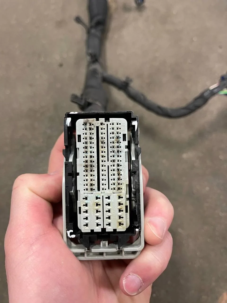

It was on a public road thankfully. Here are photos of the obvious water intrusion. This ECU is mounted in a place that would be submerged during the advertised water fording depth, therefore the ECU must be designed for submersion. The ECU failed due to water intrusion. The corrison present suggests water was getting in long before it died.

The dealer got back to me and confirmed it is the ECU / Main Computer. It is in the driver's side wheel well behind the fog light. This is not a great position for water fording. Apparently there is corrosion in the computer and a couple of the harnesses need to be replaced. ECU not only dies in water fording, but could also die in an Front End Collision. Design flaw?
