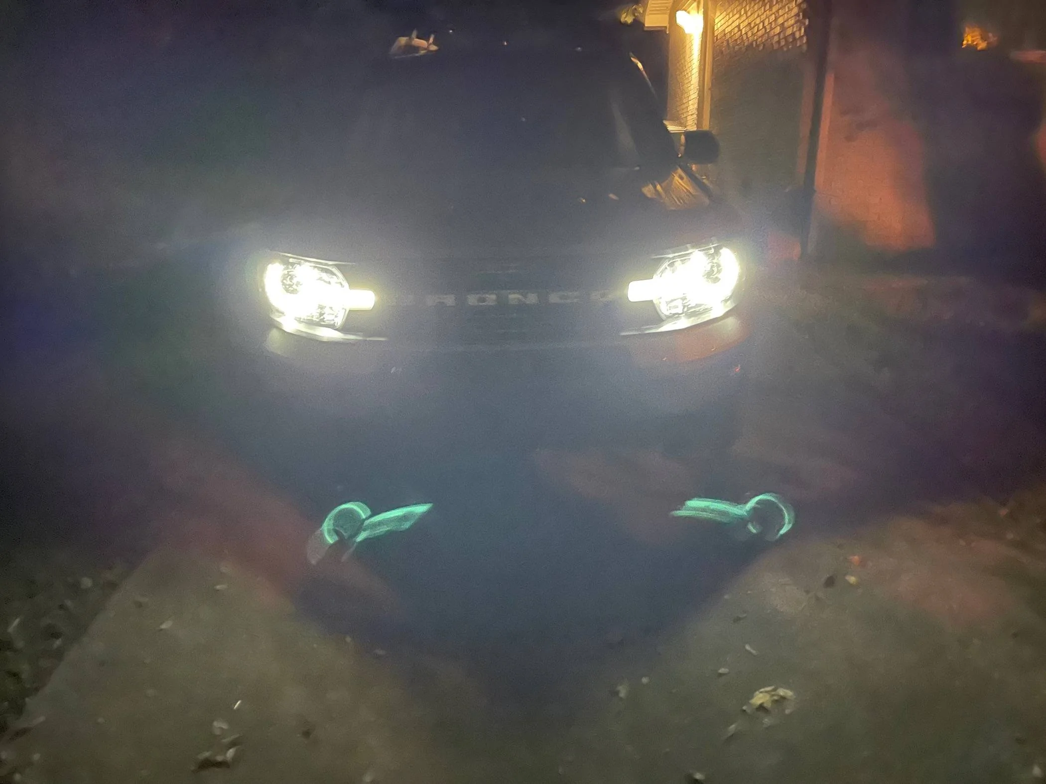

I have a 2021 Bronco Sport Badlands. I bought the Bronco in 2023.
Sometimes the lights that circle the headlights stay on for approximately 10-15 minutes after I’ve turned the vehicle off.
I have come out to get in and the doors won’t open and when I try to start it the battery is dead. Most of the time the battery is completely dead. I have been able to jump start a few times. One time I had to have it towed to the dealership.
The dealership has replaced the battery 3 times already. They say they can’t find any other issue other than a bad battery. Now it is dead again.
I’m wonder if it isn’t a computer related issue, bad alternator, and/or bad wiring.
I’m so close to getting rid of it and getting a totally different model SUV other than Ford. Any help would be greatly appreciated.

10-15 minutes is an awful long time for the headlights to stay on after parking. I think mine is like a minute or two, MAX. If you feel its a computer problem, you should be able to get the dealership to flash the ECU, at least the Body Control Module, which I believe is what runs the headlights. They can't keep claiming the battery. ONE faulty battery? Fine. But as soon as a new one goes in, and the same electrical problem subsequently arises soon after again, then its something else. I imagine you've given a good check to all your connections at the battery and have also checked that maybe your ground wire did not come loose?

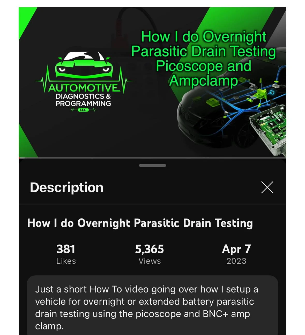

if you want to keep the vehicle you would need to find an electrical specialist. It’s straightforward to attach a current sensor, voltage monitor and a laptop with software that tracks electrical usage. After that finding the source of the problem is deterministic but typically is not easy and likely costs too much.

If you have a Ford dealership with an electrical specialist and access to the right equipment they can perform a long term test (at least overnight) then begin the hunt for the source of the problem.
See Post #78 for an idea of what to tell your dealership.
https://www.broncosportforum.com/forum/threads/seems-to-be-a-lot-of-battery-issues-on-bs-models.9379/page-6
