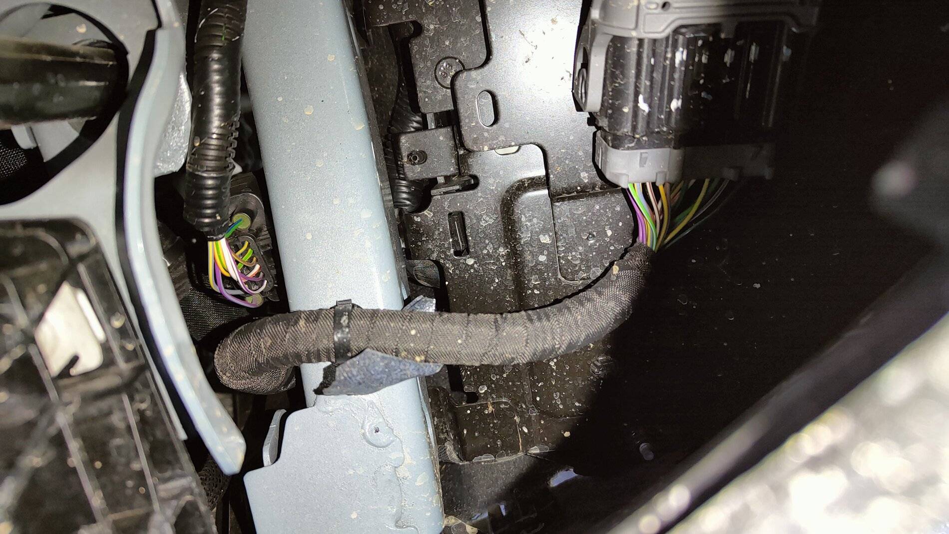

So Brody is up and running again. The PCM (ECU) and two harnesses were replaced. It was quite a job totalling 28 hours of tech time. Western Slope Ford got it done through warranty so my thanks go out to their team on a job well done.
I drove it back home to Denver from Grand Junction without issue. I have had one weird bug since in that auto stop start shut the whole car down and I had to put it in park and restart the car at a stop light.
Ford did not cover my towing through the warranty so now I need to go through the roadside assistance.
I am still really concerned about the placement of this ECU and I think everyone else should be too.
Thanks to Johnperrion for all the pictues and help! Thanks to everyone else for the comments!

As I'm looking more and more...there is another plug even lower then the one in this topic...wtf
