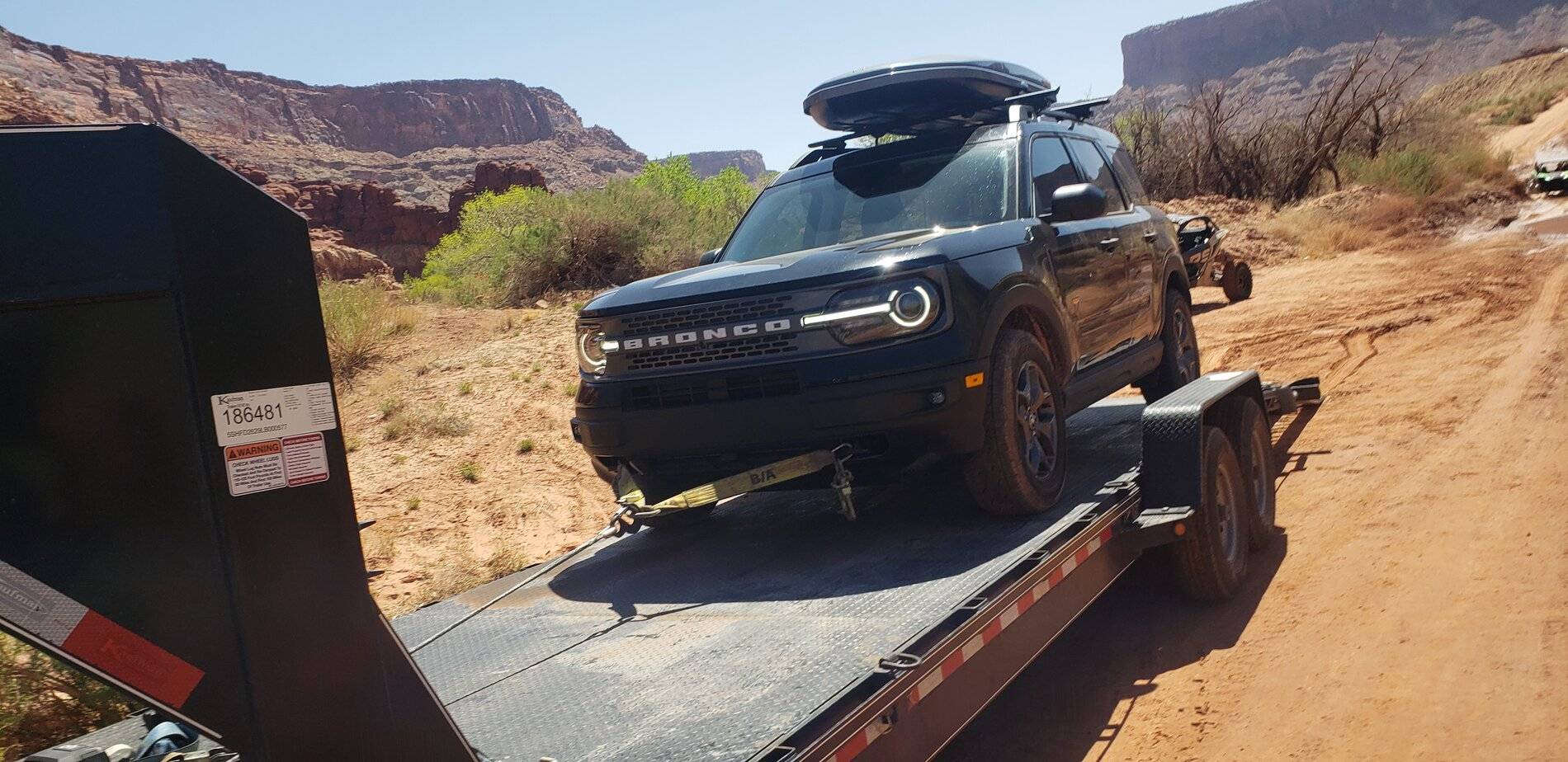

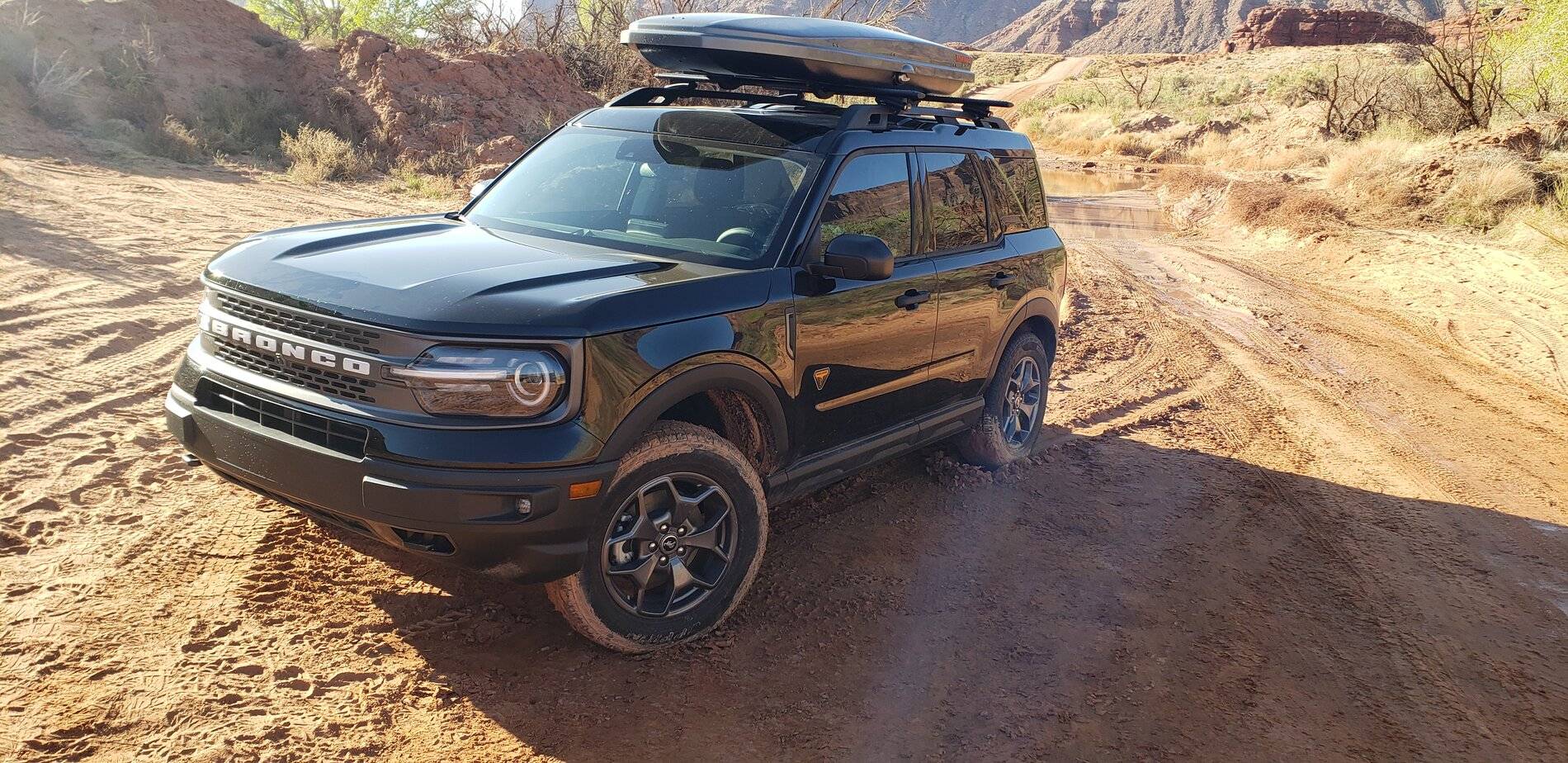

My Bronco Sport Badlands died on April 10, 2021 in 20" of Water (probably less) near Moab, Utah. Ford's website claims 23.6". Here is my story on YouTube.
Here is a Sprinter going through the same spot 1 week later at about the same depth. However much faster than I went.

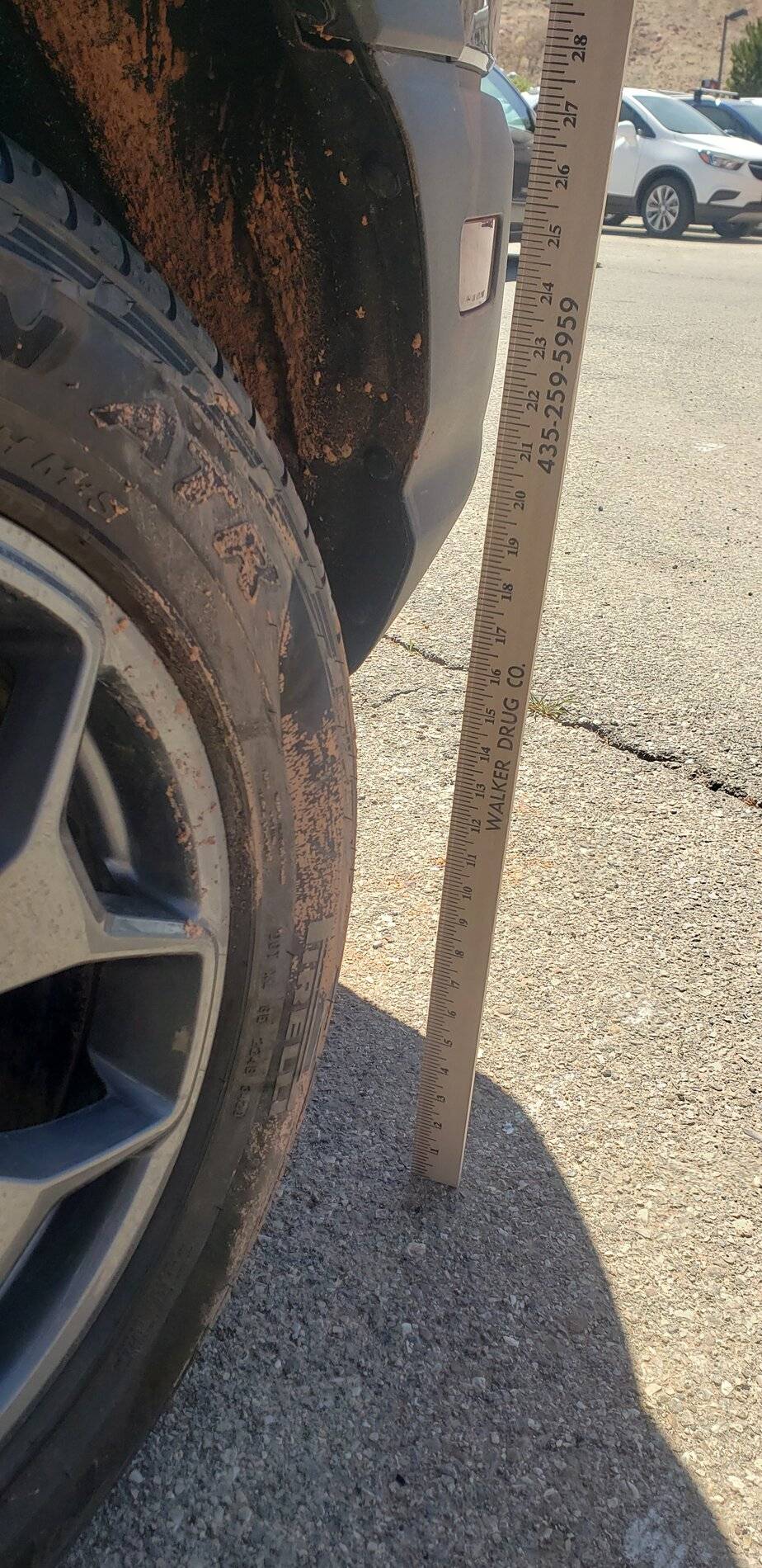

I unfortunately did not get any video while the BS BL was being dragged out by the Wrangler, so I have to go by where the mud in the wheel well got washed off. I also opened the door to get out in the middle of the water and it was right below the door on the driver's side. I measured that at 19".
It threw a bunch of errors on the dash and the parking brake would not disengage. The tow truck had a heck of a time getting it on and off the flat bed. Tic Tac Tow did a heck of a job getting me out of there though. I would recommend them.
