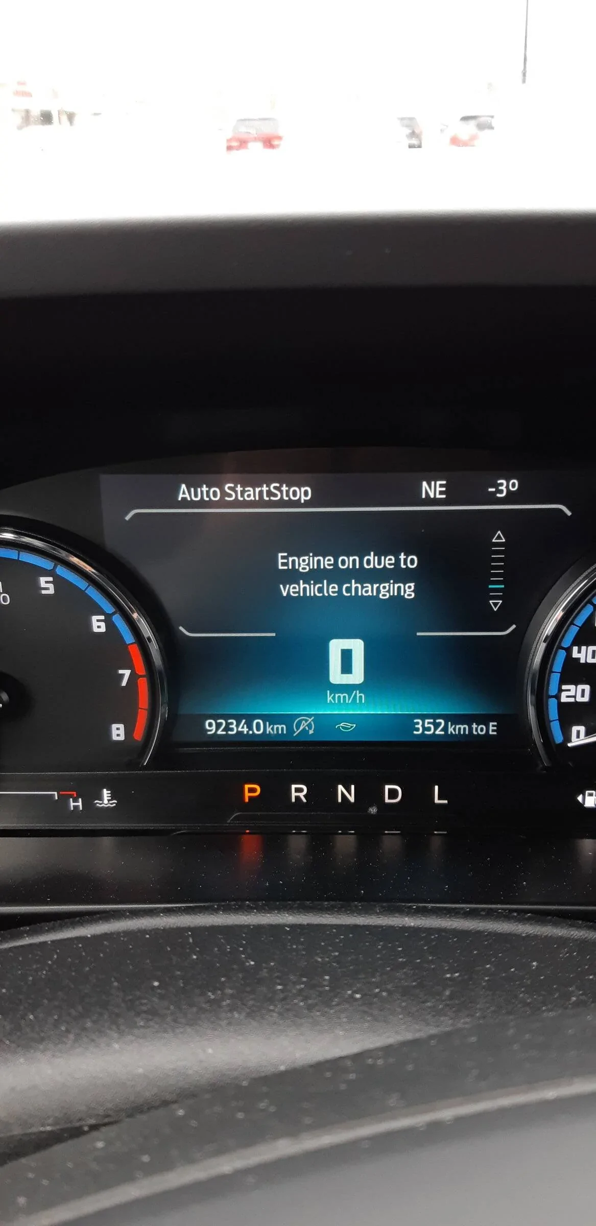

Love it or hate it, I've notice that throughout the winter this option doesn't activate. Just curious when I read this message "engine on due to vehicle charging" is there
Ford Bronco Sport Auto Start Stop 20220312_122938
a issue I need to bring to my Ford dealer?
How far do you drive it per day? Take it on a long ride to charge the battery.

Mine does this when it is Extra cold or hot outside. It is normal and a safety feature to keep your battery healthy. Not an issue.

Well I had the appointment and this is what Ford did;
CUSTOMER STATES THAT THE AUTO STOP/START SYSTEM IS NOT WORKING DUE TO BATTERY CHARGE
C: VERIFIED CUSTOMER CONCERN. TESTED BATTERY ON ROTUNDA TESTER. BATTERY PASSED 12.65 VOLTS AND CHARGED FOR 37MINS.
TEST DROVE VEHICLE AFTER CHARGING AND AUTO START/STOP SYSTEM NOW WORKING.
CONCERN RESOLVED
I was told that the “battery state of charge” was low? What the heck is that and how do I not have this repeated issue. Was it because it being winter and running more options, ie seats, steering wheel etc and the fact that i drive short distances in a day.

For some reason the battery wasn't getting fully charged when you drove it
I'll go back to my first guess of a loose cable. Hopefully the tech found and fixed that when put it on the charger.
OTOH, there no mention of them testing the charging system for proper operation.

I've read that it takes 5 miles of driving for the alternator to recharge the battery after a start. Newer vehicles start easier, and usually have higher output alternators, so maybe it is less than that now. l notice on my old vehicles that the battery runs down in the winter if I don't do some freeway driving. I have to put a battery charger on my vehicles occassionally during the winter to keep the battery up.

"Was it because it being winter and running more options, ie seats, steering wheel etc and the fact that i drive short distances in a day."
That'll do it.
Oh, and forscan can make it go away. Yay!

i turn mine off as soon as i start the BS. ive never seen that particular message on dash, but i know during the winter it would just stay running anyways.

As others have stated, running heated seats, heated steering wheel, and climate control all put a pretty hefty load on the battery. I got the 'battery charging' message and the disabled auto start/stop (ASS) often, but as it warms up and I dont use any of the above as much, ASS happens much more often.

4 weeks now with new BS BL. 30 minute drive... 105 degrees outside... A/C on... hit several stoplights... engine never stopped! Must have been too hot to engage.
